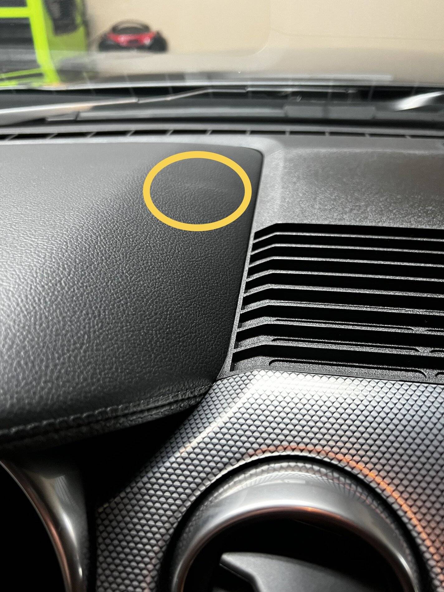

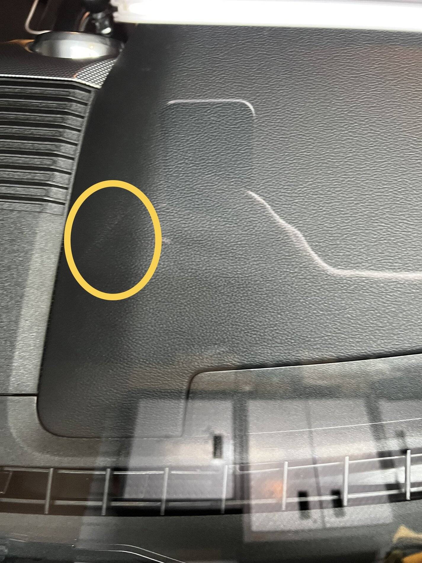

Just got time to be able to clean the car like I want, and noticed a scratch on the dash? At least that’s why I think it is. Tried Adam’s interior detailer and it didn’t help any. Wondering if anyone has an suggestions on what to try as I contacted my salesperson and they said to bring it in next week if I can’t fix it at home.

That’s really bad luck because replacing the dash is a major job with the possibilities of creating other issues

Yeah, he said they’d just probably buy the car back at that point. Issue is I wouldn’t have anything to drive because they don’t have anything on the lot lol.

Use a heat gun and it should clear right up. I‘ve done this in my Bullitt and It worked great! Put it on high setting and move it side to side really fast. Once It gets warm, rub it with your finger (if needed), to blend it in.

Is it a scratch or a chemical blemish?

Mine were scratches (that I caused myself when removing the center console for stereo upgrades) and the heat gun erased them like magic.

This video shows how it's done.
I would show extreme caution with the softer material on the dashboard though. Perhaps try a hair dryer rather than a heat gun first.

I’ll look at it tomorrow. Don’t know if it’ll work though because it’s in the “leather” portion of the dash and not plastic.

The "leather" is still a plastic/vinyl.
I would actually try an interior dressing first and see if that disguises it before hitting it with heat, something like 303 Protectant.

I actually have some of that I believe. I’ll try it in the morning first and hopefully that’ll take care of it.

Yes, it should work. Mine was in the leather portion and it looks completely normal now. I haven’t tried it on plastic before
