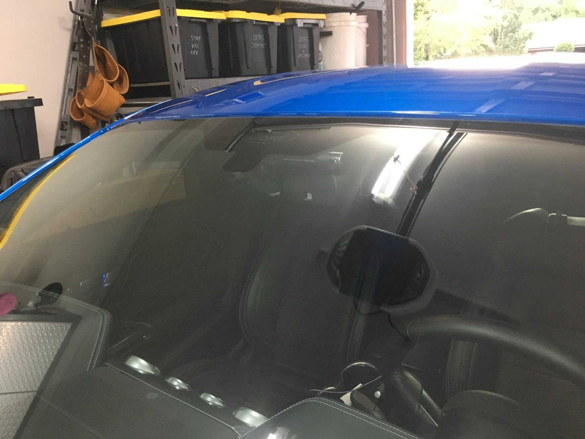

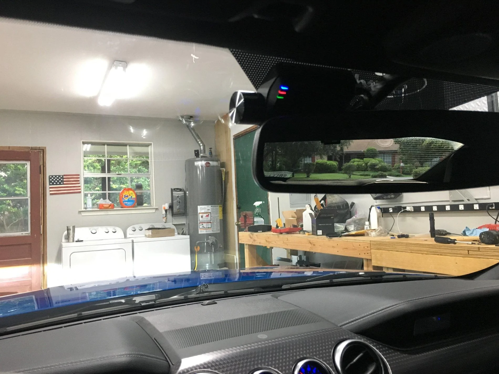

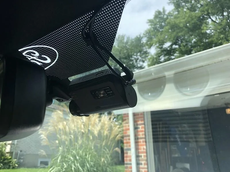

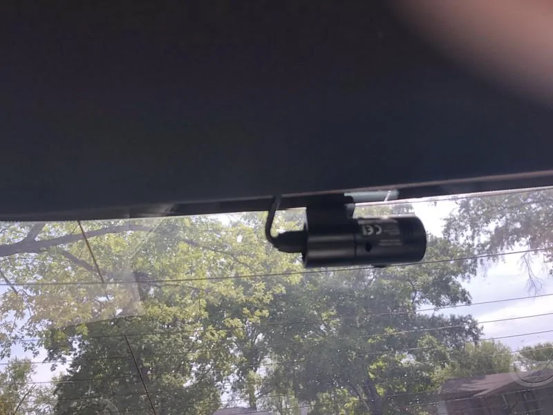

I installed one of these in my GT last year. I routed the rear cam wiring under the headliner on the passenger side, it was the easiest part of the install. No need to pull the headliner, just be careful the wire run doesn't interfere with side curtain airbags. Simple install, having some plastic trim tools helps.
Front Cam - this is the best position I've found to mount it. I tried mounting it higher up in the black to hide the camera a little and make it harder to see but dash cams have a wide angle lens and it will pick up the black perfs. This spot gives an unobstructed view of the front. Most people won't notice the cam anyway.

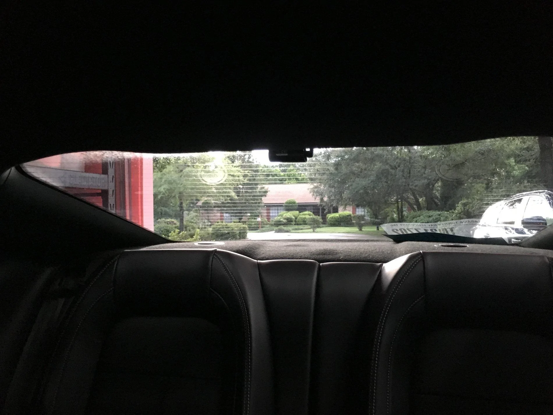

Rear Cam. I have heavy tint on the back glass and its hard to see it from outside the car. I had to bump up the brightness setting on the rear cam to overcome the tint. I stowed all the excess wire in the headliner near the camera.
