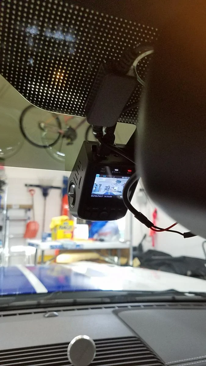

Will try to remember to take better photos today of my setup, but its basically completely invisible from the drivers seat, and you really have to look for it as the cam I chose is super slim.

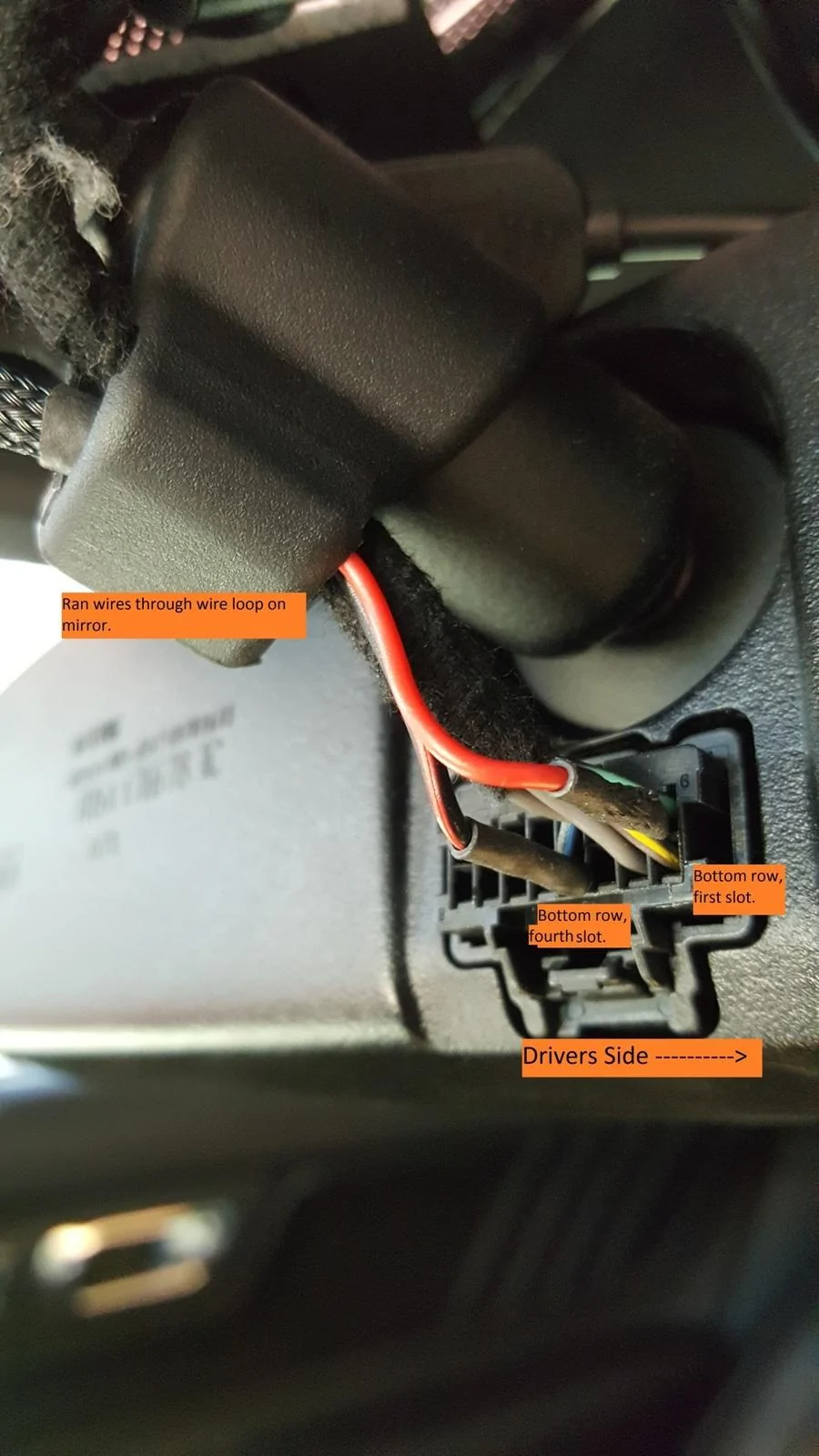

Good job yessirrom, looks real clean. Great photo for everyone else too.

The mirror tap will only give you power while the vehicle is on (accessory power or full power)
If you want a parked automatic dashcam, you need a hardwired system (and most likely a battery level monitor so it shuts off if the battery voltage starts dropping)

Does anybody know if the mirror tapping would be the same in an F-150?. I have an identical looking mirror in my truck and I'm looking to install dash cams in both the mustang and the truck.
Yeah, should be the same. As long as the mirror is powered you can tap the power source
