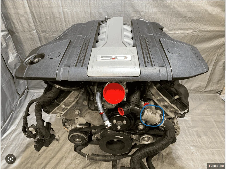

Is the thermostat opening?

There are several things that can cause overheating, and it sounds like your mechanic isn't much of a mechanic. In this image, the item circled in blue is the thermostat housing. When the engine is at operating temperature, the hoses on both sides of the housing should be hot as shit. If the lower radiator hose is cool, even when the the other hoses are hot, then the thermostat may be stuck closed.
Air trapped in the system, Low coolant, broken water pump, blown head gasket, bad thermostat are just some of the possible issues.

Ok thanks a lot for the help i will get these checked from someone else
