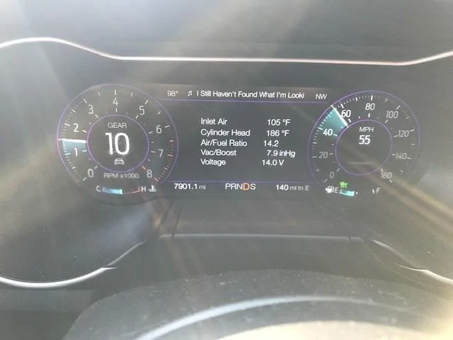

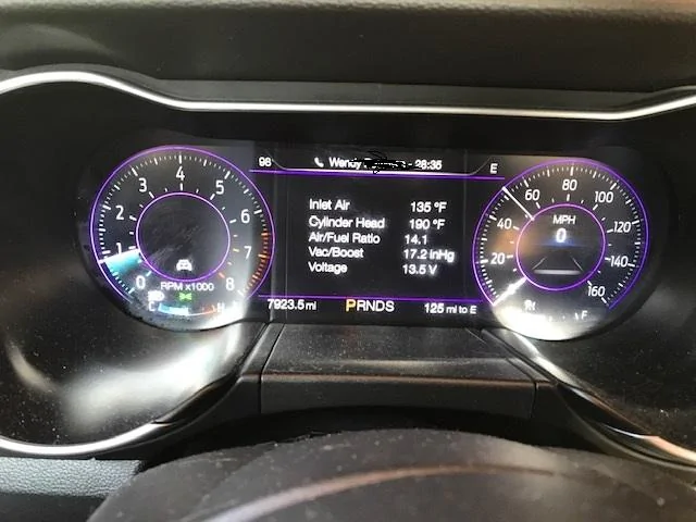

Here are two pics from yesterday. The first is after driving for 45 minutes on back roads 45-60 MPH. The bottom one is after I got home and was on the phone and idled for 20 minutes. The only difference is the expected increase in intake temp. Also note that the ambient temperature was 98F.

I don't have my gauges displayed all of the time but I've never seen CHT over 200F. Even on an extended idle, never seen over 200. You may want to test your air flows and the coolant quality. I wish I can be more helpful. I'll try to pay more attention this weekend, especially if on a speed burst.
Thanks for the data, I will try to simulate the same sometime this week and report back my values.
