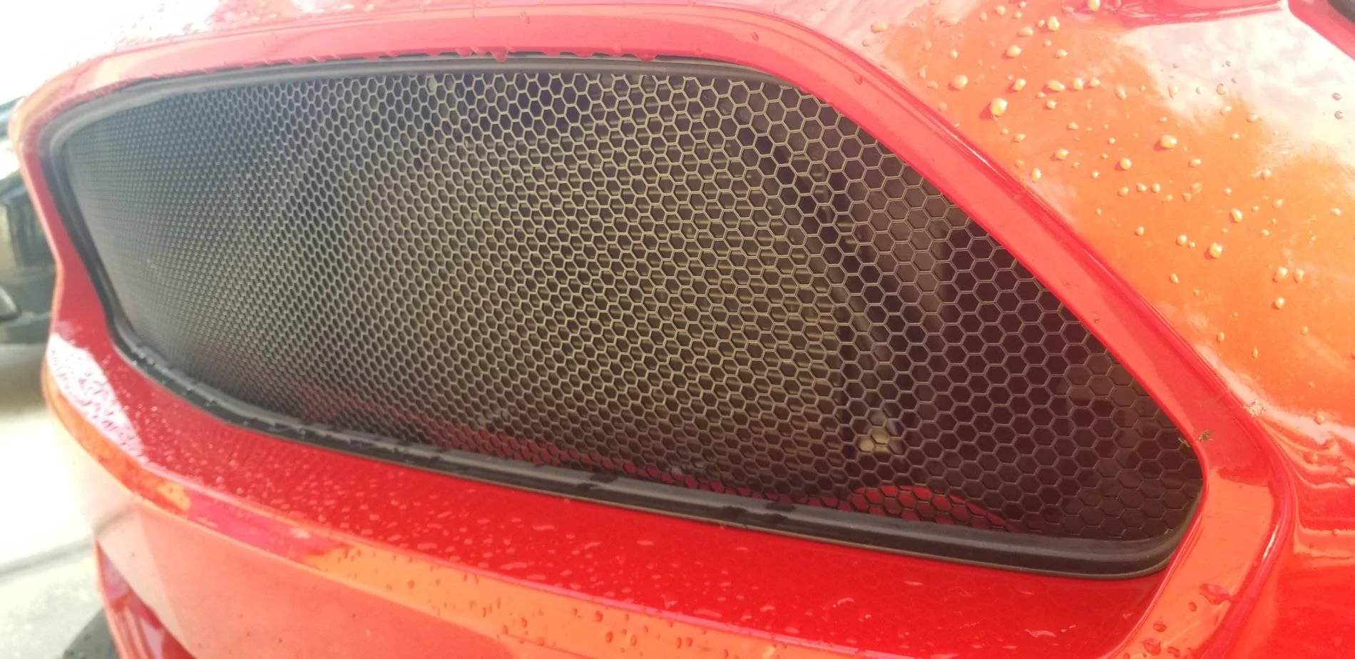

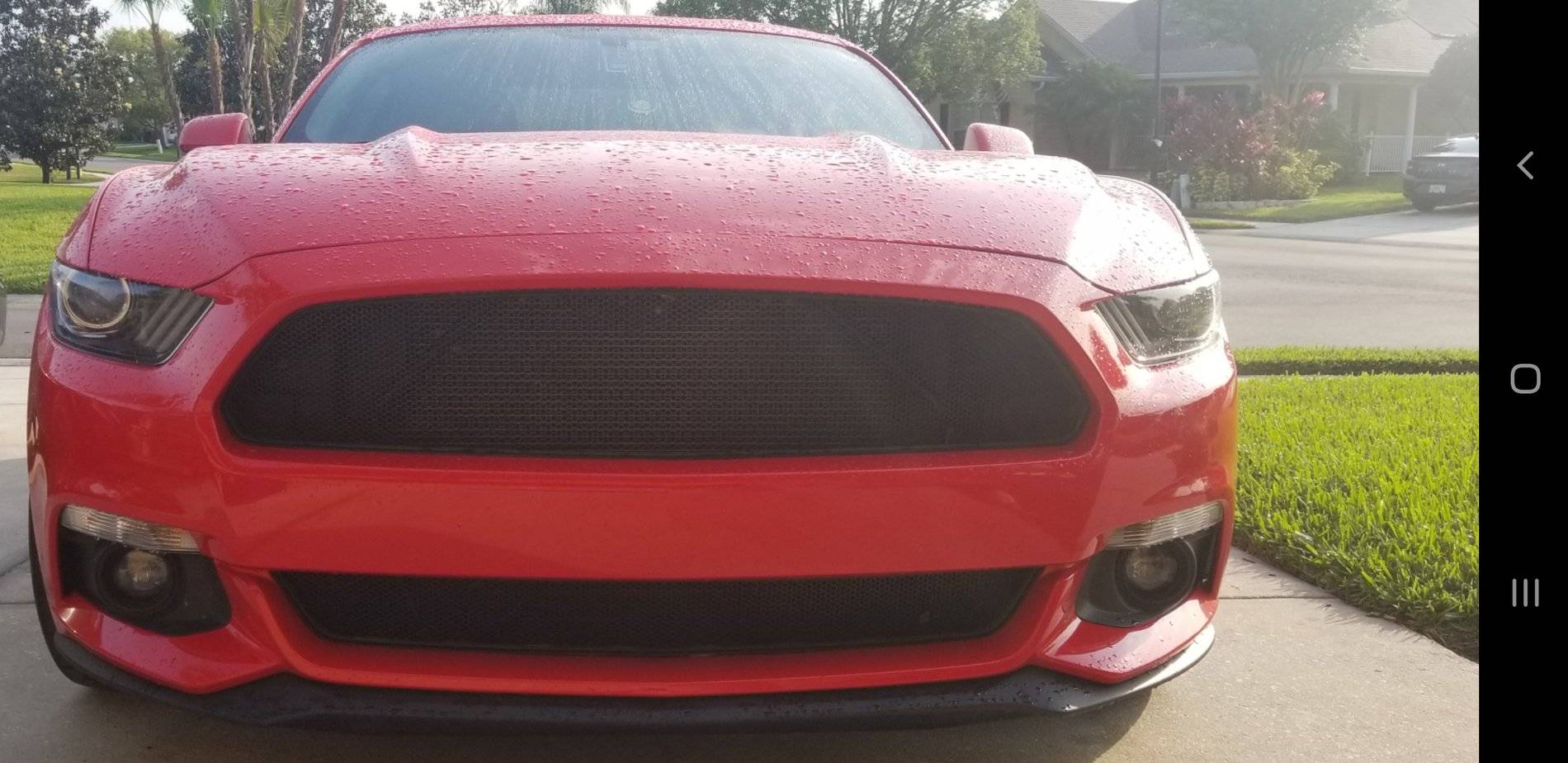

I gutted my grille too and put in hexagon mesh when I pulled the bumper.

Mate the grill looks awesome. Good to know both CVF and CPE produces good products. Can’t really see is your intercooler street size and not the BIG MAC size!
