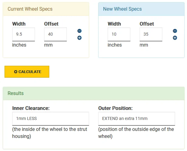

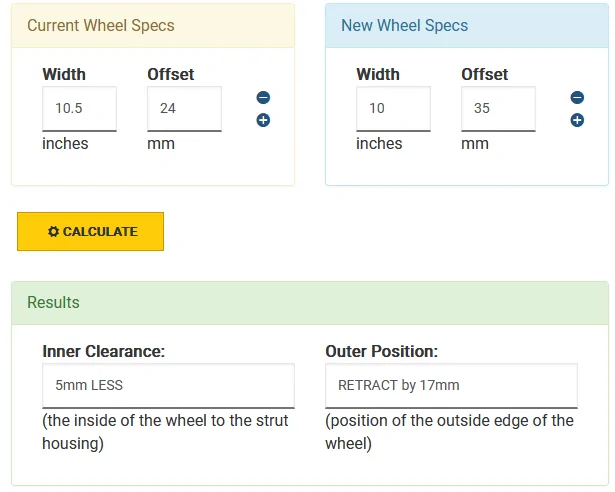

always consult Wheel Offset Calculator (tiresize.com) before even asking questions.
if 275/40/19 is fine, then 285/35/20 is fine. If you have something screwy with your setup (HRE uses a super thick rim lip?), then a 3mm or at most 5mm spacer will take care of it.
