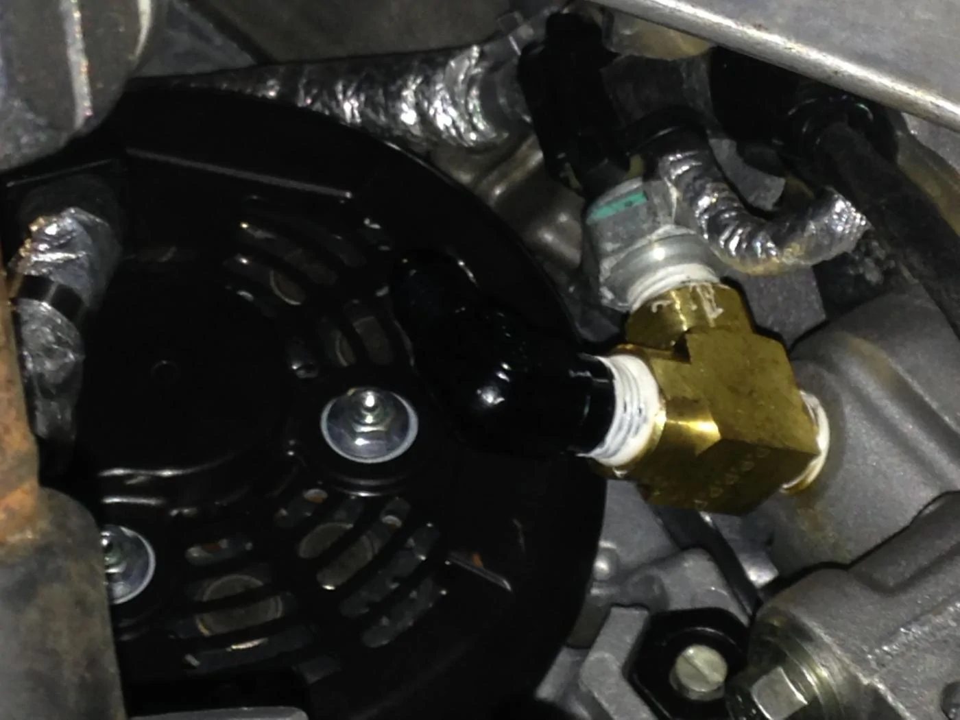

Got the oil feed tap done last night , i used a 1/4" pipe tee and spliced it in. I wasnt going to post this but someone pm'd me about it. So here is the pic

That's tuff area to work in. I tapped into that for my oil temp sensor at one point but moved it later becuase it the dead head affect on the sensor. I now have it in the oil pans level sensor spot.

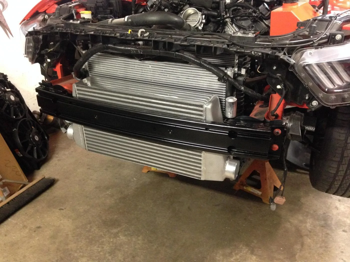

Got my intercooler and wastegates today. Intercooler took some time to get it in there and make brackets because i lost space between the condenser and impact bumper. Notched the impact bumper and it fits great now. :headbonk:

Looks like a huge intercooler, what size and brand is it?
