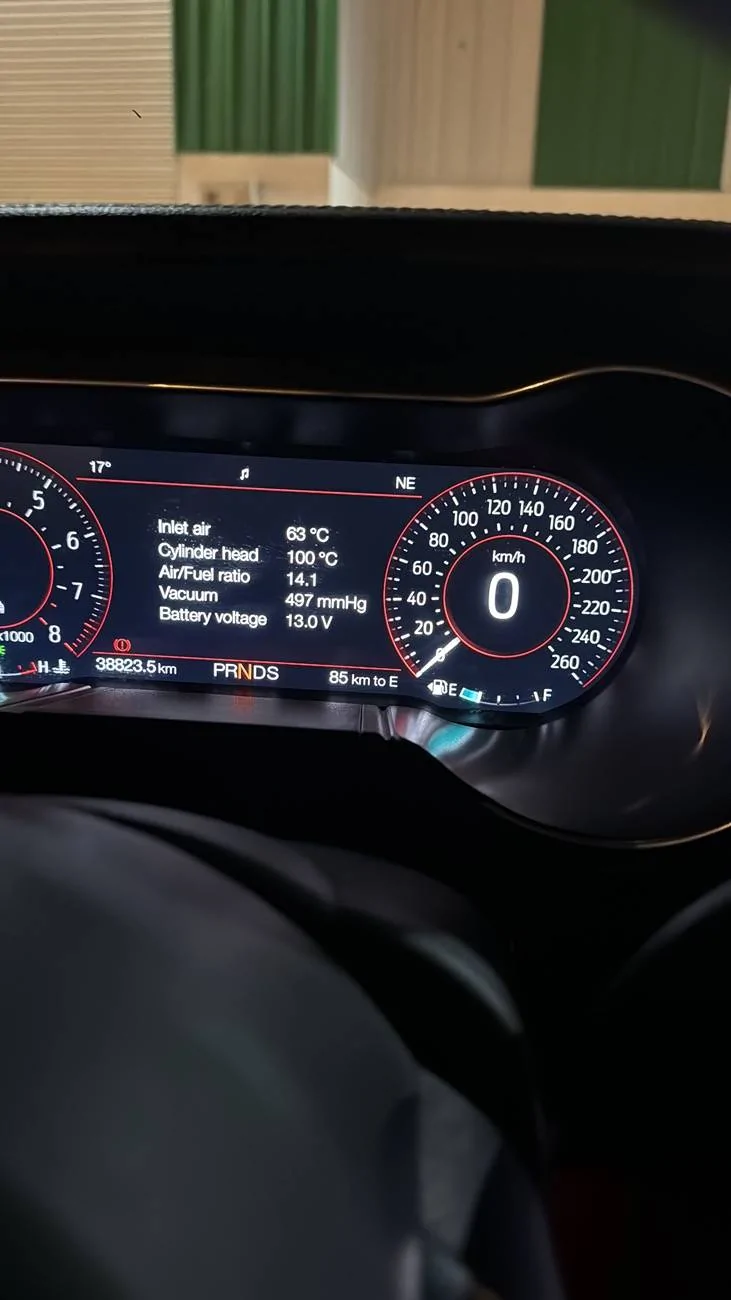

As title implies I upgraded the radiator for track days to csf radiator and mishimoto oil to air cooler and now im experiencing 10 degrees higher temp on avrage in cht and 20 if ac off could it be that new radiator is faulty needles to say i will take it to the shop tomorrow but any idea on the cause

145 degrees F inlet temp and 212 degree F cyl head temp? So what’s the problem?

Same time last year no oil to air stock rad of gt prem never saw more than 85 idle cyl head temp this is going to jump even higher on the track i did the upgrade for i expexted improvement tbh…

It wasn’t and let say i was wrong it was 90 definitely wasn't going beyond 90 ish now if i drive 120 speed i get 105 c at 17 c ambient no way

I dont have grill shutter and we did another bleed yesterday it was totally sealed no air, if i blast the ac it goes back to normal had this installed for a while but since it was summer and ac on never paid attention , i went and programmed the fans yesterday its working fan but not ideal solution
im guessing its has to do with radiator size change seal and air flow cfm to rad ?
