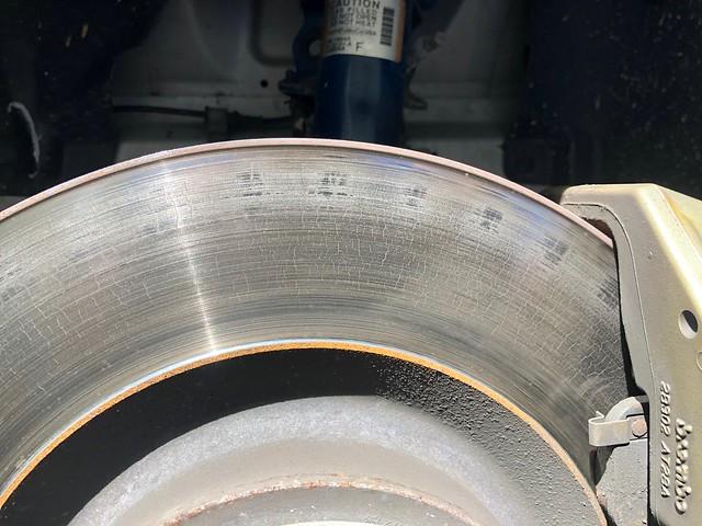

16 track days and counting with brembos and a 300a system. I've gone through 3 sets of brake pads with them so far and have ~2 days left on the current pads. Not using race pads or hoosiers, 1 set of stock pads and on my 3rd set of power stop track day pads with my own brake ducts and square 305 NT01s.
A friend ran the brembos on his 16 GT automatic without the PP master swap either for 2 track seasons but has recently moved to a GT350 so no more data there.
May do the PP master swap to see if there is a difference since I have plenty of miles and laps on the current configuration. Attached pic shows I'm not easy on the brakes and the 300a system/brembos combination hasn't been a problem for me. Pic was taken last Thursday when I switched back to street wheels/tires.
OE rotors - 3.5 sets of pads by MikeD, on Flickr

Looks good. Did the brake pedal travel or effort change much when you went to the PP brakes?
How do those powerstop pads compare to stock?
Sorry but I honestly can’t remember how the original pedal feel was. The PP brakes have been on for ~2yrs/20k+ miles now. I’ll try to find a PP equipped car to drive and compare.
The powerstops seem to have a little more initial bite and hold than the stock pads. Stock pads are smoother on the initial stop and then stopping increases linearly with more pedal pressure where the powerstops seem to start with more bite and stay there with less pedal modulation. For me the stockers are better all around pads and the powerstops more of a track pad that can be street driven but they make some noise. I have more confidence in the powerstops at the moment since the car is 75/25 track/fair weather driver now and they’re $200 for all 4 corners. They both dust but the powerstop dust sticks to black wheels if it’s not cleaned and turns brown. I'd really like to try the DS1.11 pads and/or G-Locs at some point since they're probably a better match to my tire but they're not recommended for street driving and I don't want to switch pads every few weeks.
