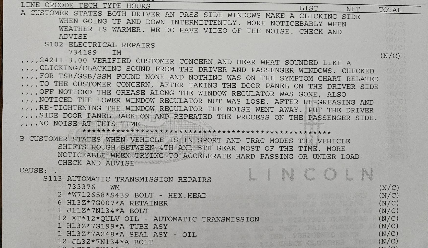

They lubed up my window rails and the noises went away on both sides. The grease smell was pretty strong.
In case anyone else runs into this issue.

I'll try to take a picture of the mechanics write up when I get home. I don't remember if he verbally said it or not but my rails had no grease. And that's true for when I took my door apart to see if anything was binding. Although, I don't remember my 2018's window rails being greased either.
