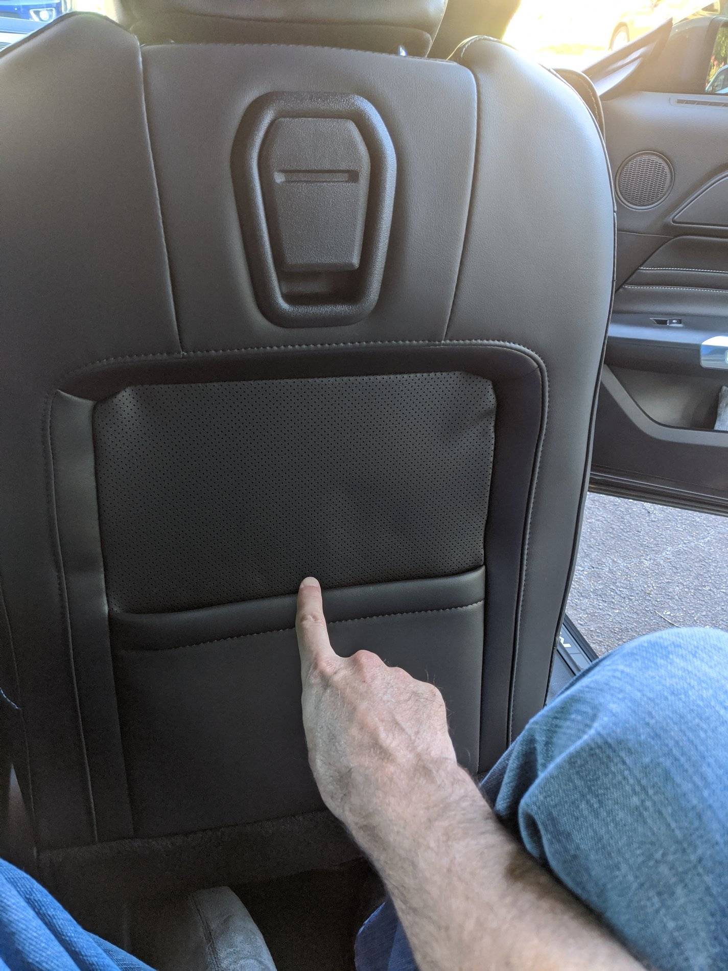

same sound here.. though in my car i belive this is the seat warmer/cooler.. i have not had the seat apart yet to check but i think its a wire/cable tapping on something.
when i press on the back of the seat (the square shape in the seat back, where the cooler/heater unit is) the sound will go away, when i dont press there, i get rattle, again then i press on the back of the seat where the heater/cooler unit is, sound stops..

Let me know if you have any luck. I'm also thinking it must be some wire cable tapping on something. Can you share a pic of where you're pressing it to make it go away ? I just press firm on the middle of the seat or have a passenger, it goes away. But i rarely have a passenger, so this sound is annoying

i took a pic this morning of the seat back, where i press with the palm of my hand, and the noise will stop.. you may have to feel around a bit but once you place your hand here, you will feel the seat cooler/warmer unit underneath the perforated leather.

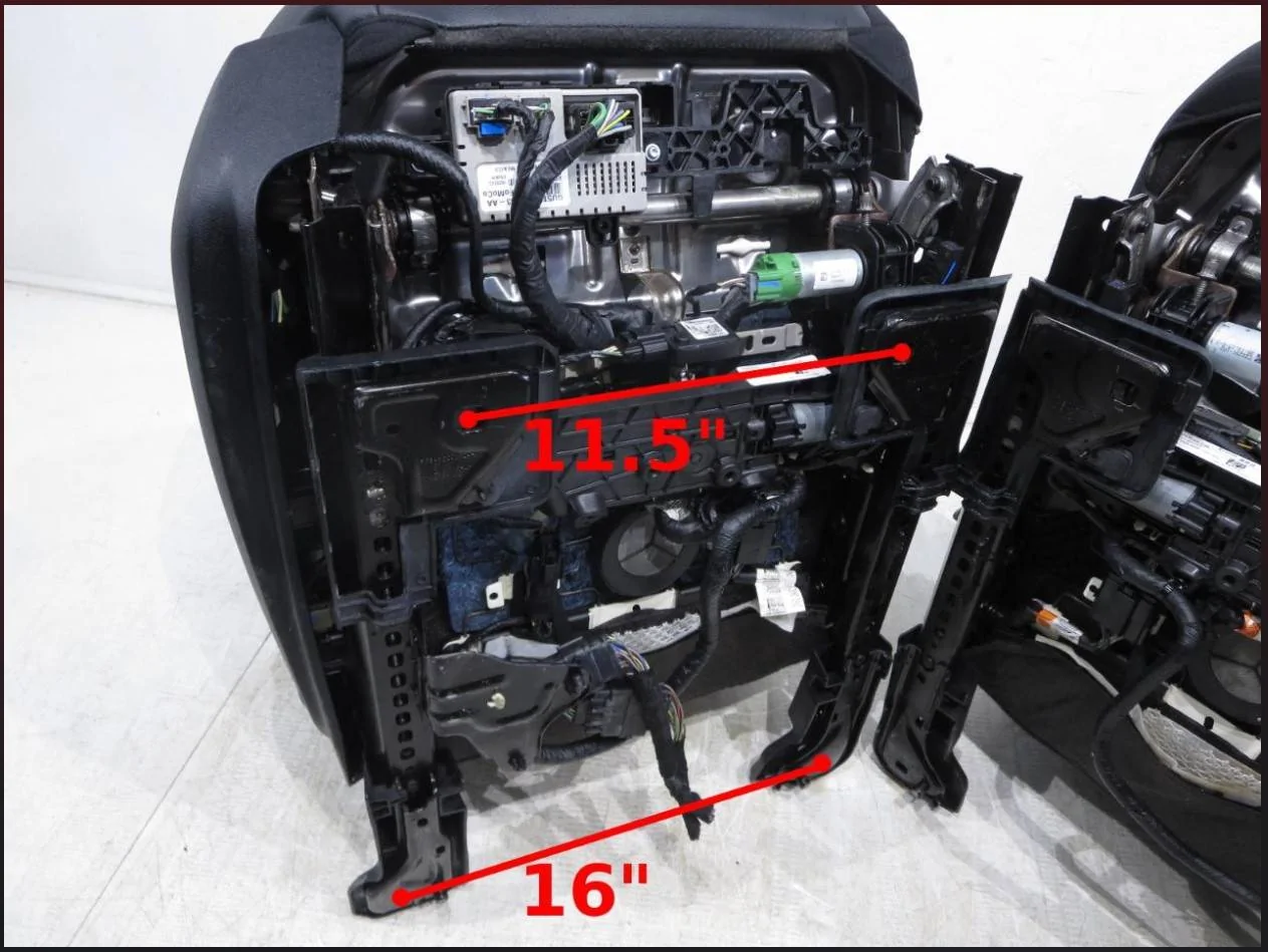

im also not convinced this rattle isnt coming from something underneath the seat.. there is A LOT of stuff under there.. anyone of these connectors, wires, harness, ties, modules, etc, could be the cause of the rattle
so my car was at the dealer for 3 weeks for getting the shift forks replaced, i showed them the seat creaking noise videos. The service advisors reply is hilarious, he says 'every Mustang does it, and you're lowered blah blah'. He suggested to try adjusting the seat in different positions which I did and also placed something in the back pocket, didn't help. I'm convinced it's coming from something underneath the seat but there's lot of stuff so it's really hard to pinpoint where it's coming from...
