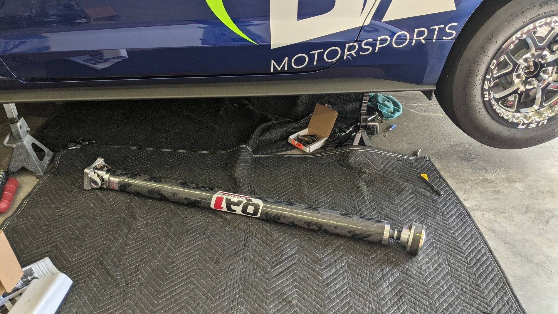

Looks like 1,500hp:
https://www.qa1.net/automotive/driveshafts/mustang-rev-series-carbon-fiber-driveshafts
I ordered mine with sonnax slip yoke and sonnax rear adapter flange. The rear adapter flange is aluminum and the whole shaft is a quality piece.
