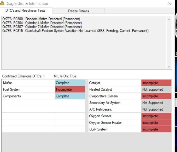

Good morning folks, I did a bunch of research the past couple days so I apologize if I missed something. I purchased a tune via lund back in august. no issues other than needing to do a crank relearn with VCM scanner which was successful, it has you follow prompts and raise engine rpms etc..
Fast forward to now. I had a new mcleod twin disk, flywheel, throw out bearing and kooks long tubes installed. DTC in screenshot wants a crank relearn but everytime I go to do it, it just says "crank relearn successful" without prompting me to do anything like rev to certain RPM.

all to no avail, screenshot attached

also, can anyone confirm the misfires are historical? im new to vcm/ford stuff

im revisiting this because the car has been running fine for 7k miles. crank position CEL wont go away but car runs/drives fine.
i have flashed back to stock because i remember someone with a similar issue but now i cant find that thread.
hoping it will self reset with stock flash as i think the initial cause was the lund tune not allowing the code to clear itself. car is running and driving fine on stock tune and intake right now. still have CEL though

new development... I uninstalled/reinstalled HPT software on my laptop and loaded stock tune, CEL is out, p0315 remains in background but should clear with some driving as it is no longer "active". Ill post updates and hope this helps someone down the road
also, after reinstalling HPT software... I can actually run the crank relearn procedure.

closing this off, crnak relearn is fixed after reinstalling HP software on laptop. ive had no further issues. didnt need clutch depressed either.
