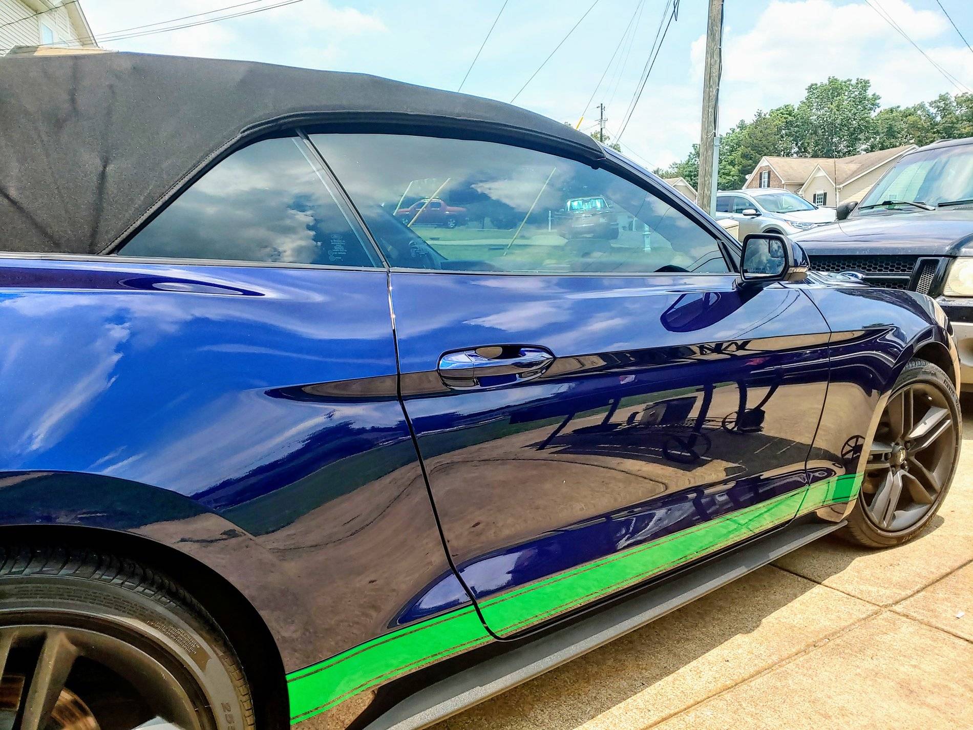

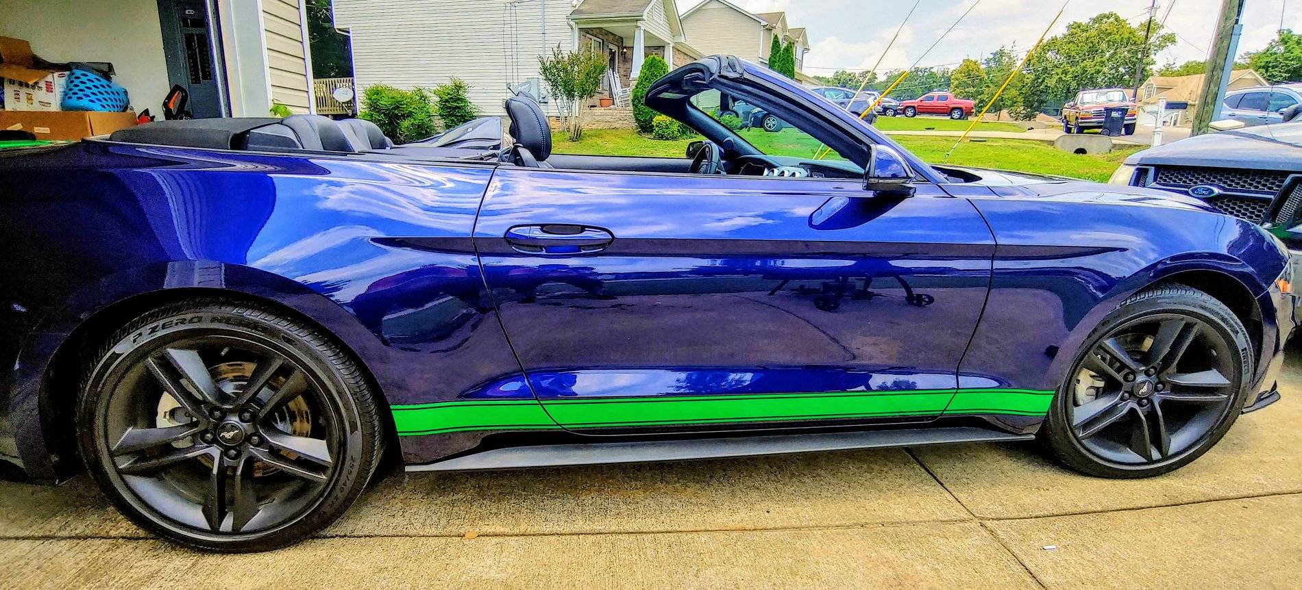

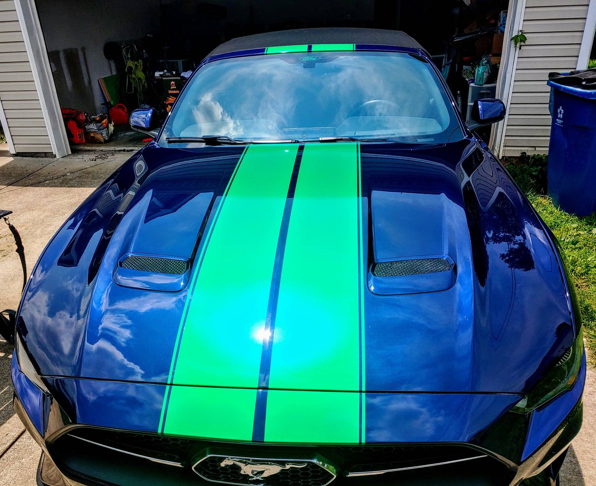

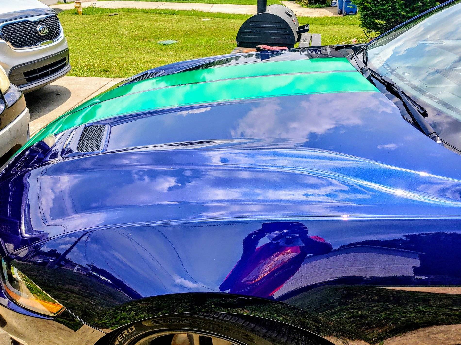

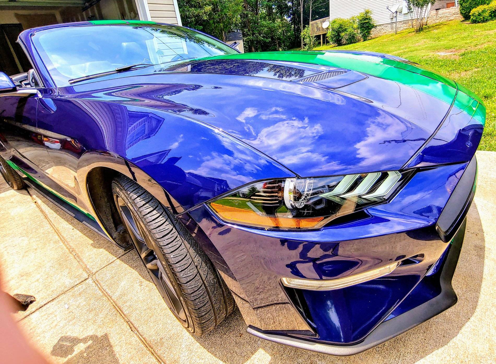

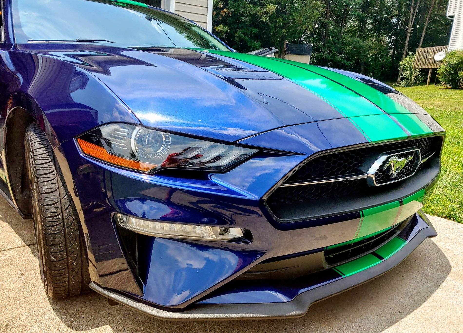

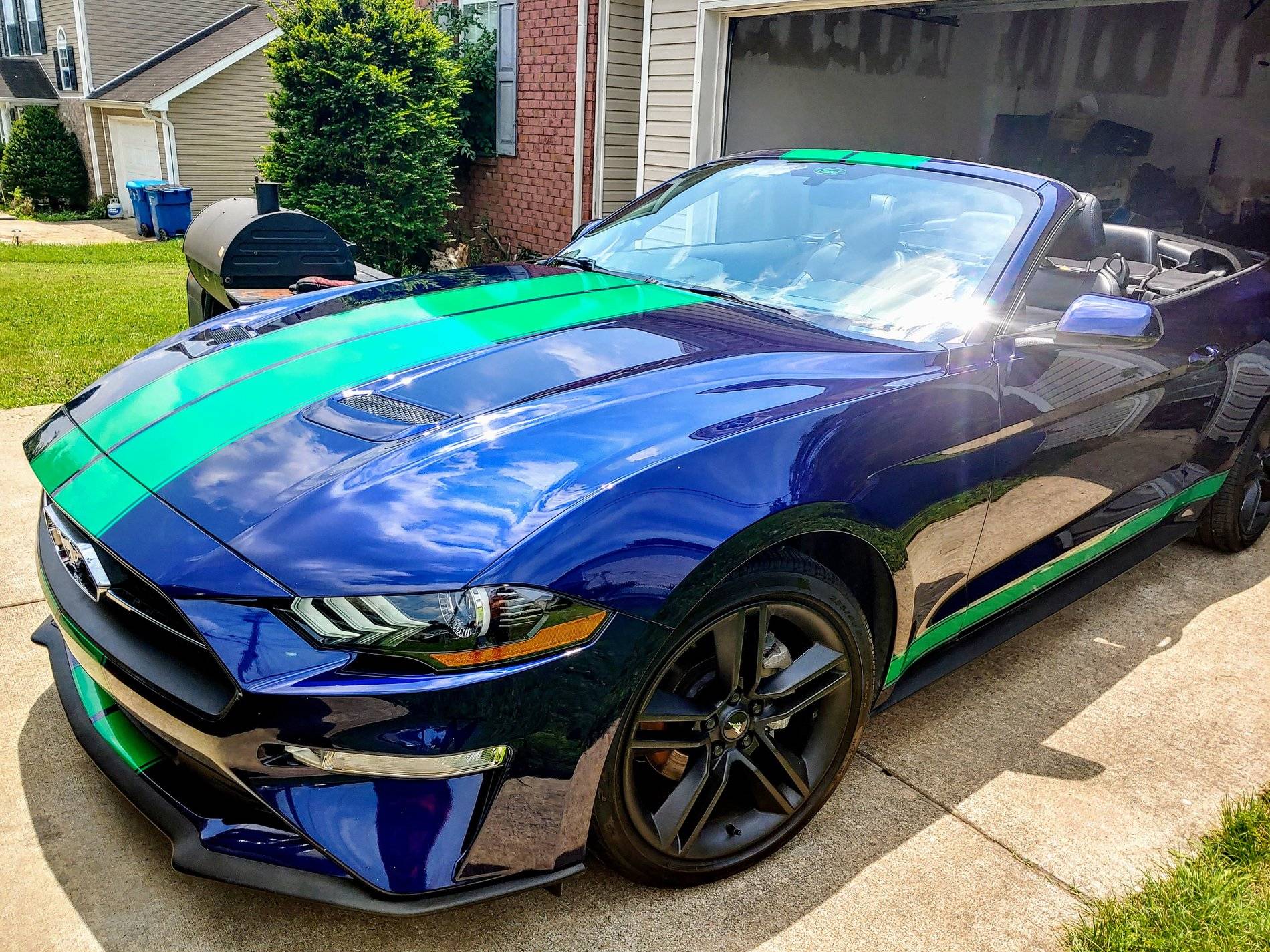

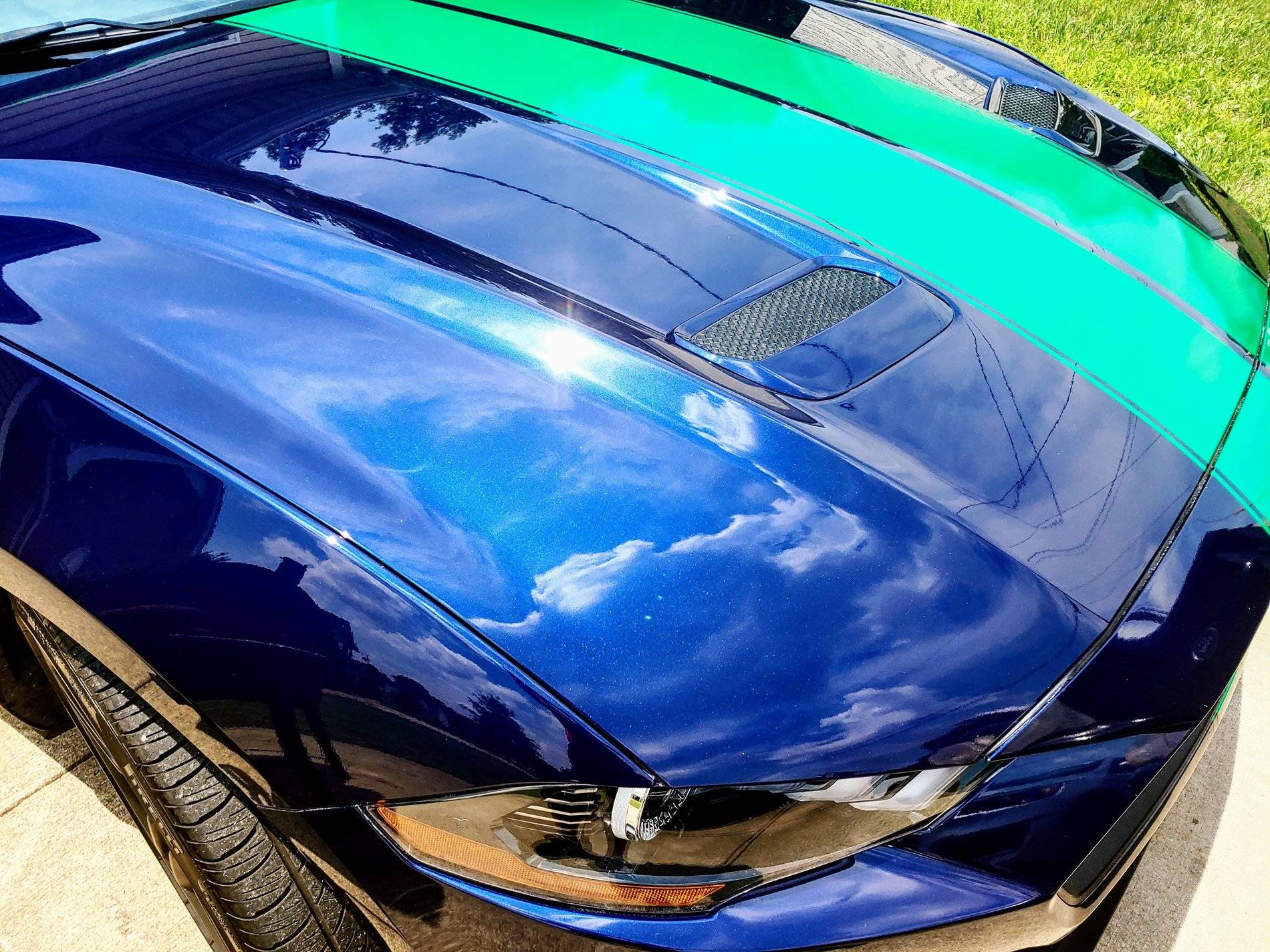

So after my last detail job, I found out there were still some scratches and swirls my polish wasn't aggressive enough to remove. After putting in all the work, I wasn't going to leave it as is. This time I decided to go all in and do a ceramic coat.
Prep was a bulk of the work...9 hours total:
Two bucket wash, iron x chemical decontamination, clay, three stage polish (full cutting compound, medium polish and finishing glaze). After drying, full wipe down twice with CarPro Eraser (basically an isopropyl alcohol product with additional stripping properties to make the paint completely clean).
From there, two hours or so were spent applying the ceramic coats (2 total) and their sealant spray. I can't drive it for 24 hours while the ceramic liquid cures into a solid glass shell that lasts 2+ years.
All in all 11 hours of work total. Worth every penny and the hours to make sure it came out as good as possible. Pictures don't do it justice... Literally looks like a sheet of glass on my car (which is exactly what it is)...pics don't do it justice.
