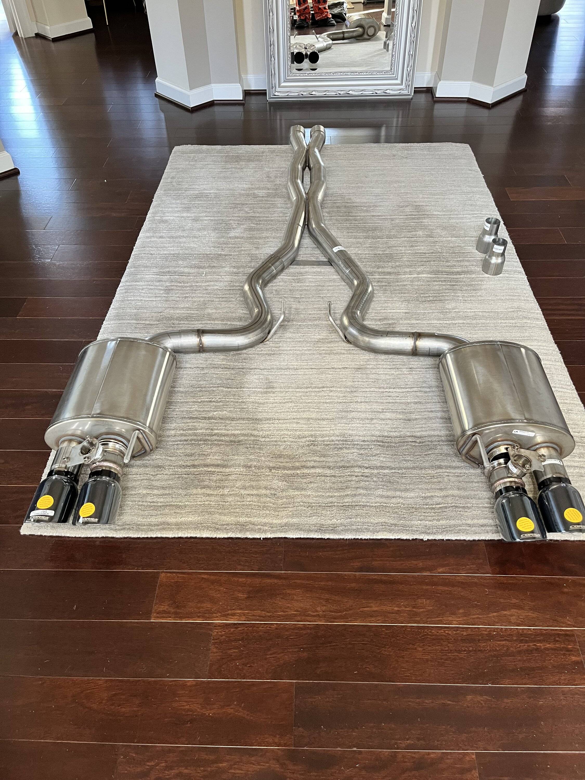

Not sure if anyone can tell from this pic if these are the updated active exhaust valves

I got the same exact exhaust. Can't tell if it is the new actuators, sorry.

did they send you the rug as well or was this just luck the exhaust fitted near perfectly? Nice and shiny exhaust, looks great.
