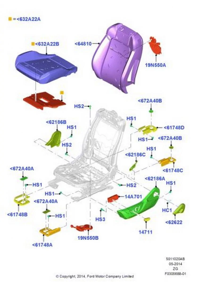

I'd like to see an exploded view of the seat assembly to see if they show a thermo-electric element in the seat back, or is there one only in the seat bottom?

Fordparts.com has exploded views of everything in the car.
19N550 is the part number, there is an B in the bottom and A in the rear of the seat (the 2 red smaller plates). I think the A is located in the lower lumbar though as per a Ford Rep here. The upper back doesn't cool.

Thanks for that exploded view. When I felt where the air was coming out on the back of the seat it was basically half way up the back, not low in the lumbar area. I think the fan assemblies are basically located about in the center of the bottom seat, and about the center of the back of the seat based on where I could feel air blowing through the perforated leather.
From the looks of it, I would venture to say that there is supposed to be a thermo-electric cooler built into each "fan unit" A & B (red assemblies you mentioned in the exploded view), that would cool the air that the fan is moving through the surface of the seat.
So the question to the Ford Rep to go find out from Ford Engineering is: "Is there an active thermo-electric cooling element included in the seat back fan assembly part number 19N550 in the exploded view?"
If not, then the backs are not designed to cool. IF there is supposed to be an active electric cooler in 19N550, then the seat back should cool just like the seat bottoms.
People have verified they can hear the fan and feel air flow through the back ... just not cooling at all - and some guys even claim their seat backs actually heat up with the seats on the full cold setting.
I think someone at Ford got it wrong when we were told it was in the lumbar section. (which, of course, would make no sense at all to put it there) Even the diagram shows it in the center of the seat back.
The diagram is nothing more than a diagram though, not to scale I'm sure. A Ford Rep in another subsection confirmed that it's bottom and lumbar. Nothing in the middle/upper half of the seat.
Yet everyone says the air is coming from the middle. Not the lumbar section. Plus it wouldn't make any sense to put it down there.
Well "lumbar" is the lower half of the seat. I don't think there is any one definitive answer on this issue though.
