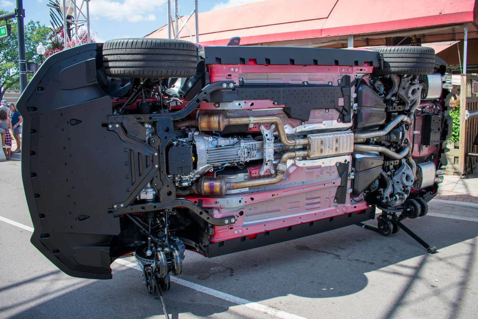

5.Br0
You don't need to remove anything to get the trans pan off. As you can see in this picture, most of even the engine oil pan is exposed and the trans pan sits past that. Yes this is a manul pictured, but you can imagine where the auto trans would be right in between the 2 cats.
The pan is very easy to drop, all the bolts are fully accessible and they shouldn't have alot of torque to them since they are going into a plastic pan. The biggest worry is about making a mess draining the fluid and then making sure you set the level appropriately with the new fluid which can be a bit of a pain.
