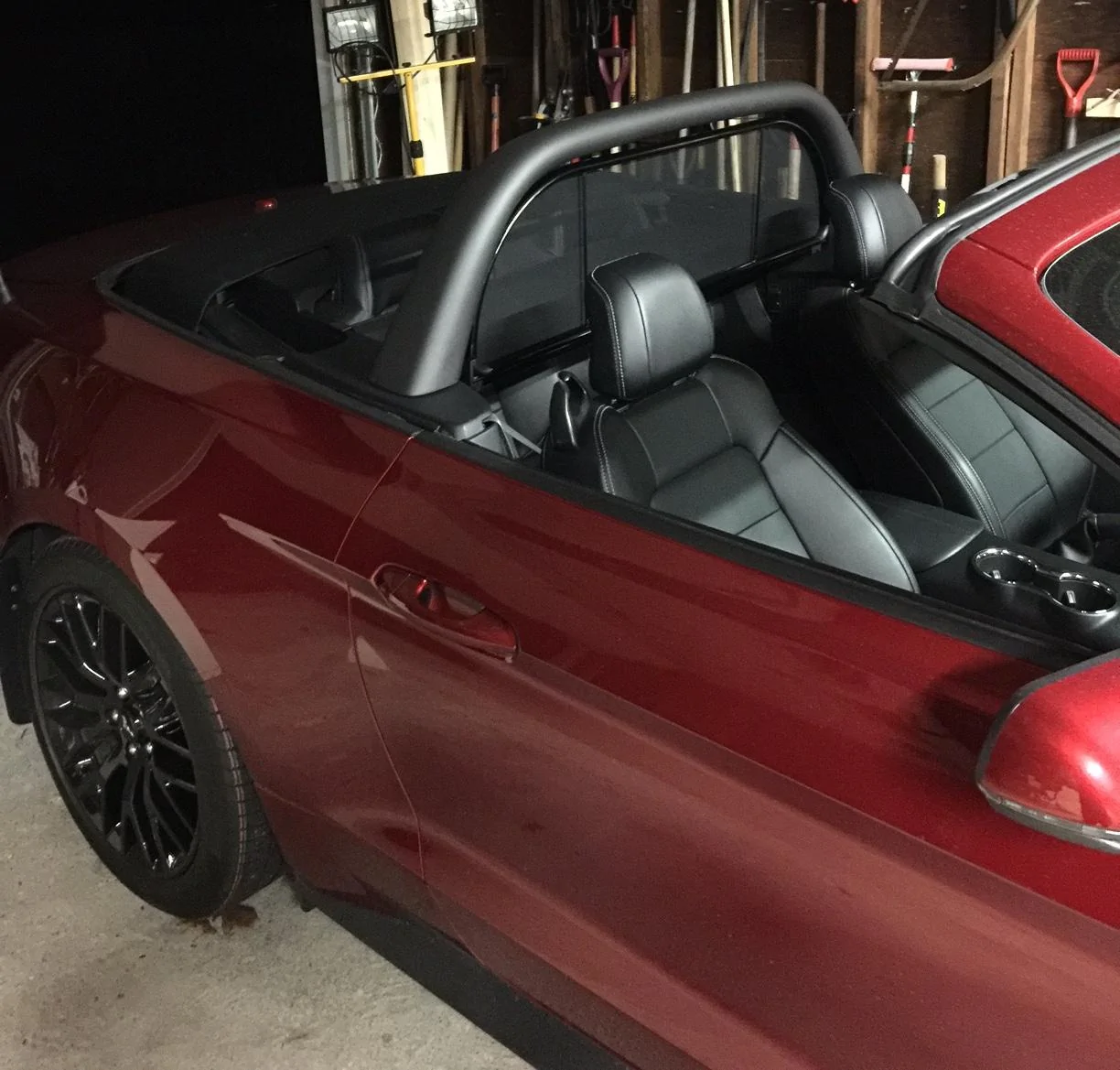

CDC Light bar and LoveTheDrive wind deflector installed. Thanks to fellow forum member [MENTION=29306]parajax[/MENTION] for convincing me to get it. Still think the bar looks better on his color stang, but I am happy nonetheless.

Looks great man :headbang:

That looks great! Looks like an extension of the black interior and plays off the black wheels.

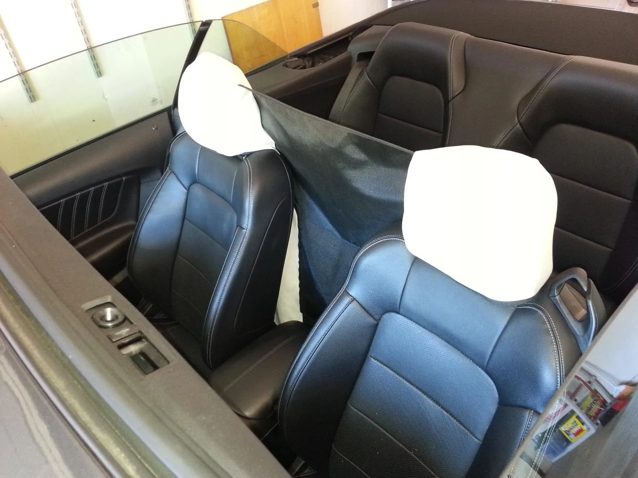

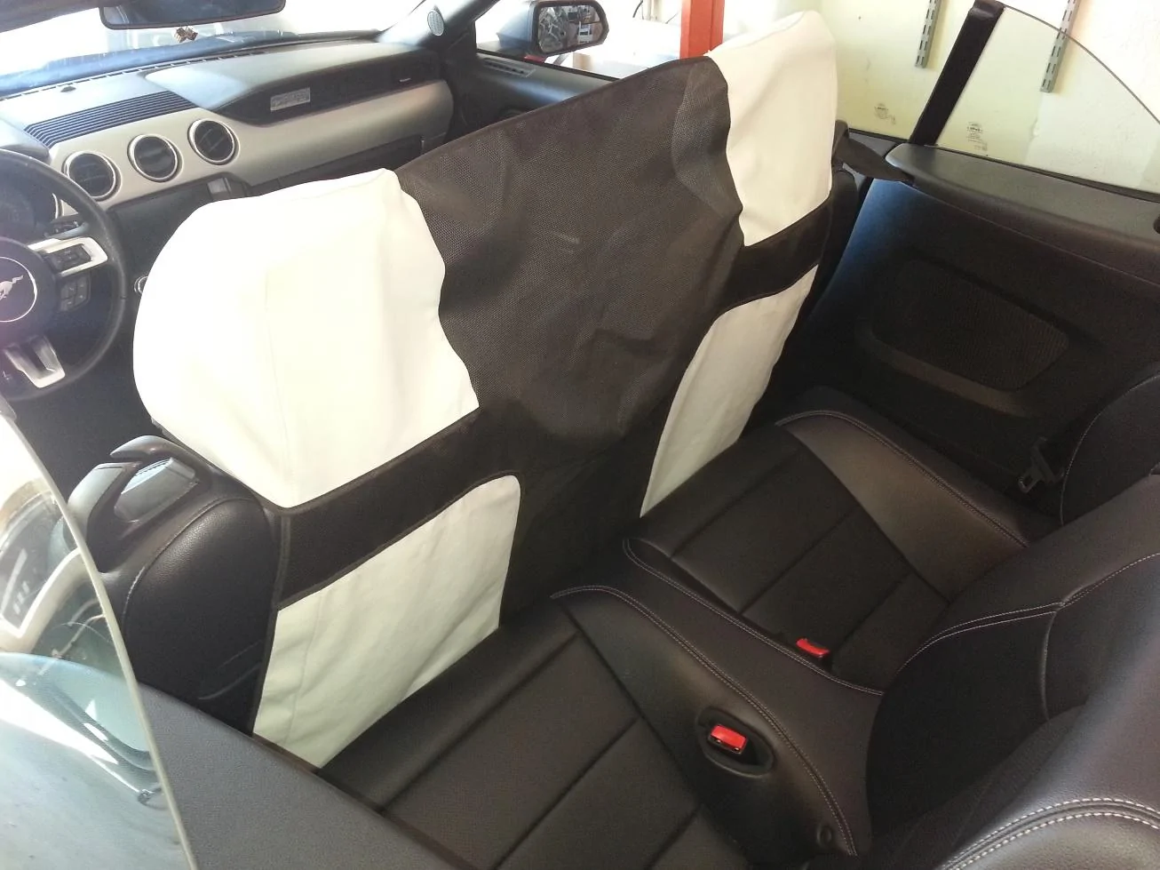

Sorry, have not been on here much lately. To answer some questions about how I made the back seat cover.... here are some pics as I did it. I used cardboard to form a template - on the back side, I form fit it around the seat contours and made extensions that fit into the rear seat belt openings. On the front side, I contoured the template to slide into the front seat belt openings and onto the back of the seats. I used the template to trace onto thin plywood and cut it out.
Initially, I intended to make it so that it could fold and fit in my trunk - so I cut the wood into two separate parts so that I could hinge them. I backed off of this plan and just connected to the two parts together.
I covered it with fabric that speaker makers use to build those sub boxes. Available from many suppliers online.
All told, it cost maybe $50 and 1/2 a day.
If I had to do it over again, I would use a thicker wood - and make the parts that slide into the seatbelt openings of metal.
As for the ability to move the seats, you can move them - but I really the only driver so, I don't move them. Plus it is a detterent for my wife to drive my car so I win.

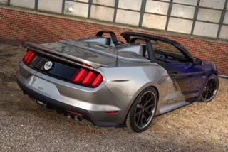

I wanted simple. Ultimately, I really like the speedster type tonneau cover. Cervani makes one, but not for our year - I've called them. The Mustang Rocket has one to die for (red pic) - but the rear quarter panels are wider and the trunk lid is different so it would not be plug and play for us. The Nieman Marcus special edition has one that is cool too and would fit (blue silver pic). I tracked down the guy who owns the mold for that one and have a call set up on Monday to talk with him about what it would take (group buy?) to get him to supply some. If I could arrange a group buy, are there folks who would be interested?
