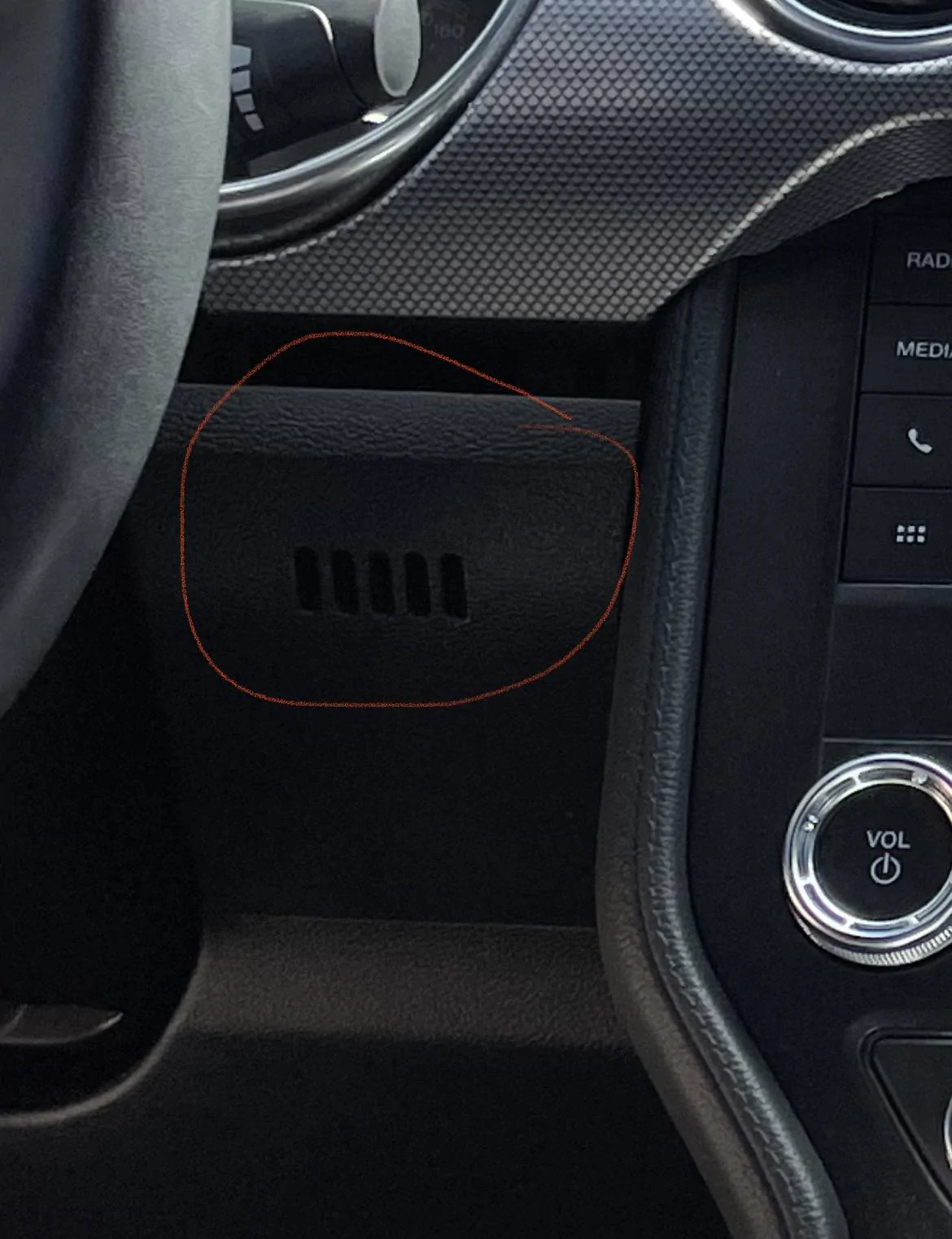

There aren't any speakers behind the bezel for the sync head unit. Do you mean this bit of dash trim?
If you suspect the sound is coming from behind the trim it's fairly easy to remove with some basic trim removal tools. I'd tear that dash apart to look for that irritating beeping.
No one seems to have encountered this because it's (probably) not normal for a Ford. I've owned seven different cars made by Ford, none of them ever made the sound in your video in the sequence of events you've described. 🤷‍♂️

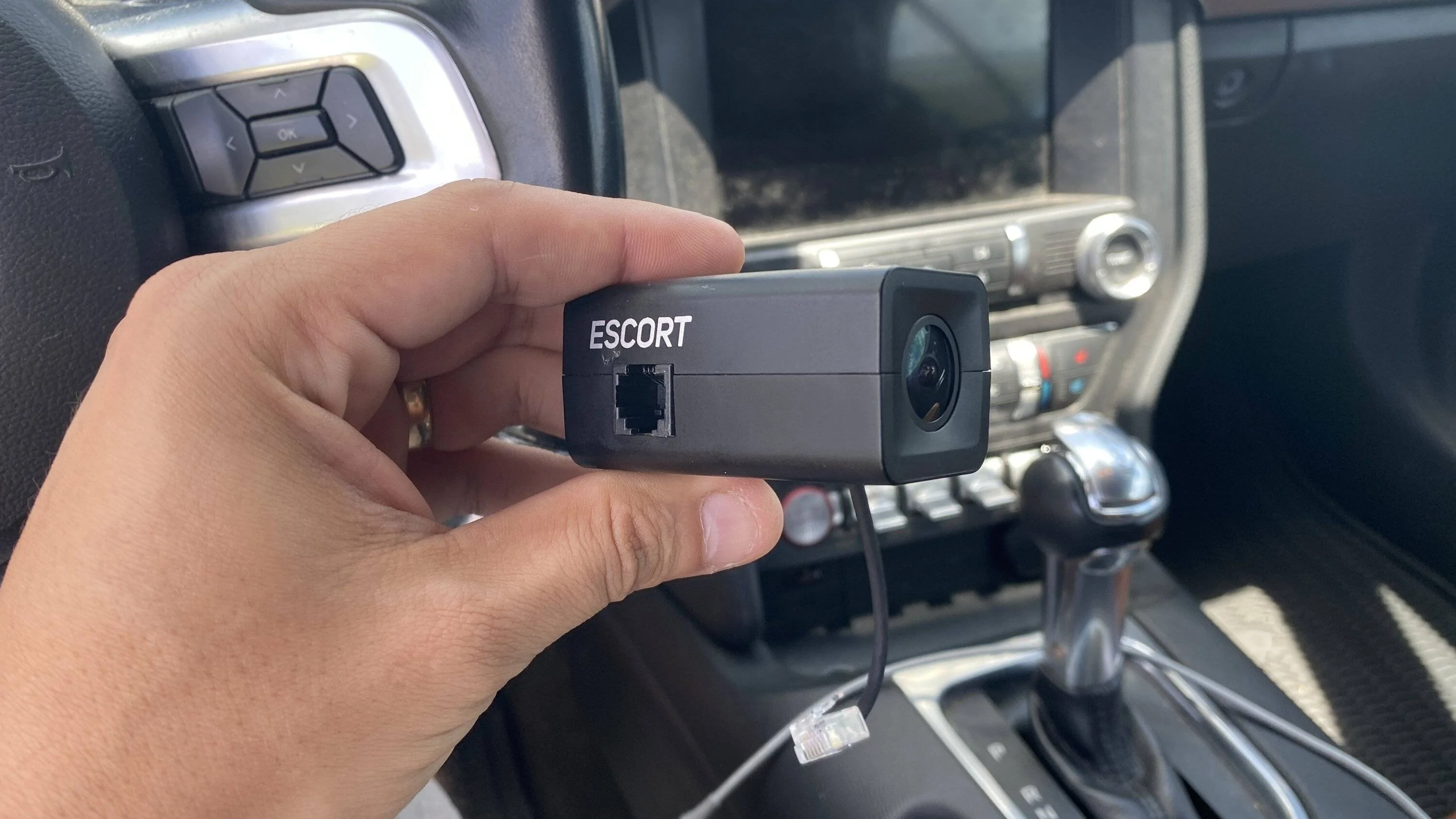

I was just about to make another video and I put the car on the ON position without starting. 10 seconds later it started beeping.
it was much easier to track down the sound with the car off. It ended up being my drive cam that was mounted above my Escort radar.
Thank you all!!
Thank you all!!
Well... at least you located the source, which explains why no one else hasn't experienced the issue! 🤣
It's amazing at what devices will cause the most annoying noises...
