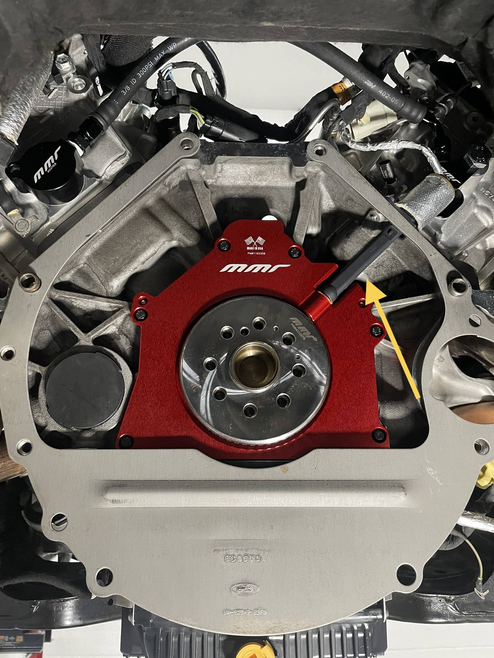

Crank sensor replacement is going to be a PITA to do with the intake manifold and/or tranny installed.
I just put a new crank sensor in my 2019 Bullitt, but I did it when the tranny was out of the car, so it was easy to do. Next time around it won’t be so easy, because I have the MMR Head Cooling Mod on the car, which means the passenger side billet insert for the head will need to be removed In order to replace the sensor.
Why did you have to replace yours? I don't feel like blowing $300 on a sensor and the install more importantly for it to not matter at all.
I wasn’t having any trouble with y sensor that I know of, I only changed it because it was included with a rear seal plate kit that I purchased from MMR. I don’t think the sensors are that expensive by themselves though.
If you do decide to change yours, I suggest removing the intake manifold to access it, rather than removing the tranny, unless of course you’re do for a clutch.
