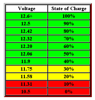

Okay, after 11 hours of being off the charger, resting voltage on my batt. is 12.8V.
