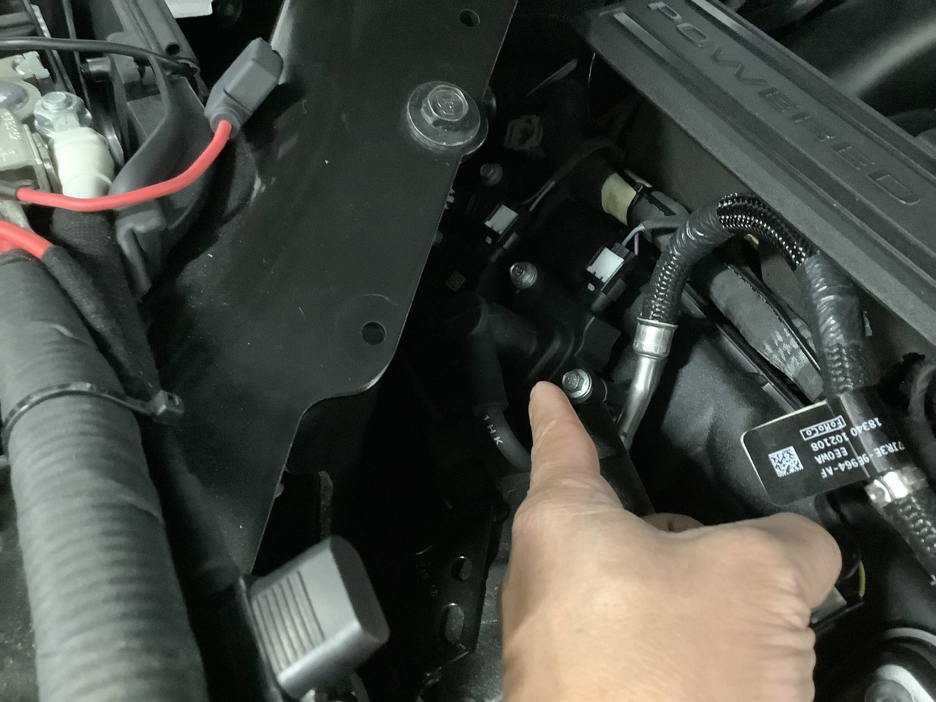

Verify that this boot is completely plugged up. It could be partially plugged up and causing intermittent issues.
