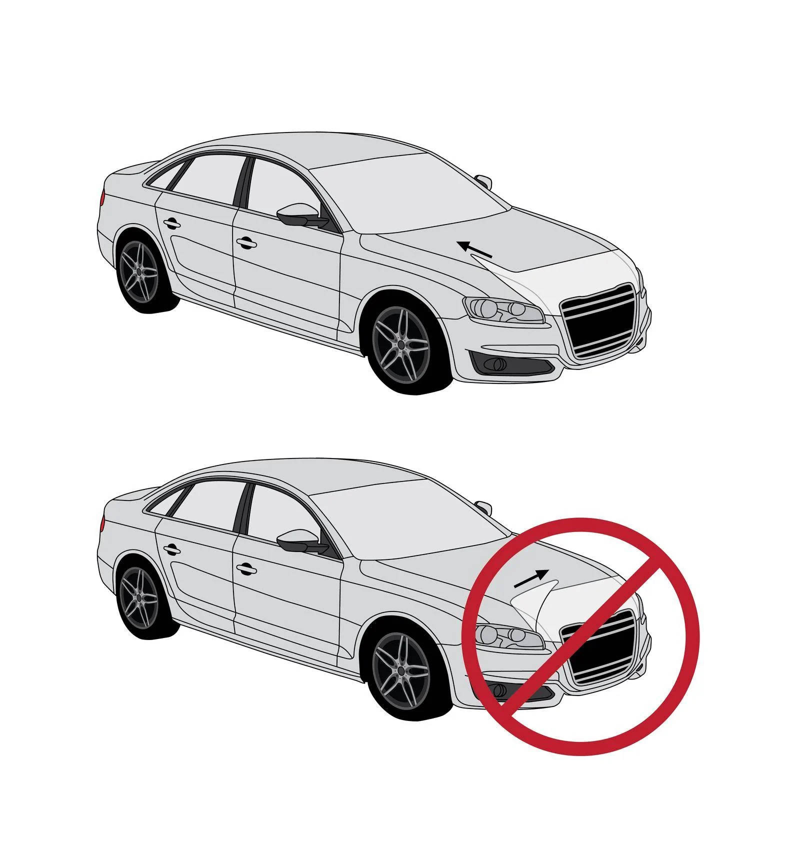

fwiw I’ve only removed PPF using industrial steaming machine. It’s the proper tool for job
Always pull paint to itself and not 90* that is a big mess up too.
old stuff PPF has a tendency to tear too,it’s brittle due to sun damage. No biggie just keep tugging along. I use 3m adhesive remover the large cans
