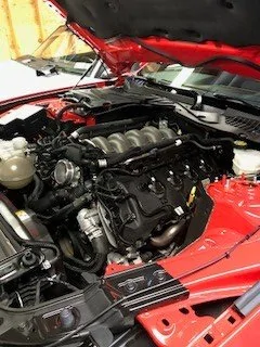

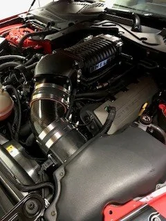

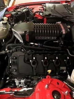

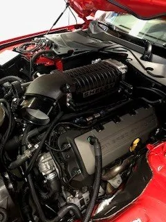

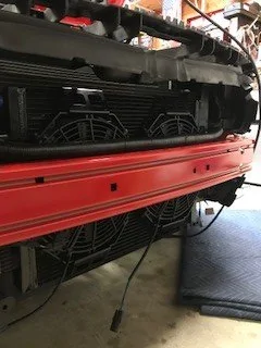

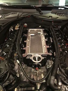

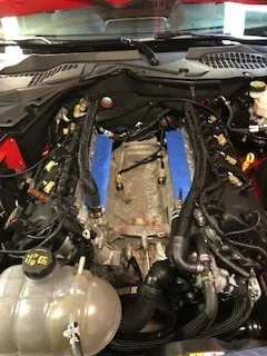

Here are some pics of my Install. Gen2 and Gen3 are the same install mine is a early Gen3. It has Gen3 rotors and Gen2 case.
