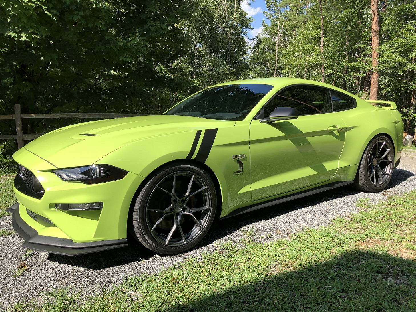

I was meticulous about installing the springs, turns out one of my springs is 1/4" longer than the other. Measured them last night. That would explain the difference in height. Thinking about calling Steeda and seeing if I can swap out for a pair of their minimal drop springs which are .5" on all 4 corners. For whatever reason, a slight drop amounts to more than advertised on my car so I have learned I need to be careful.
Here is the 1.125" drop in front and the .5" drop in the rear and how the car sits.

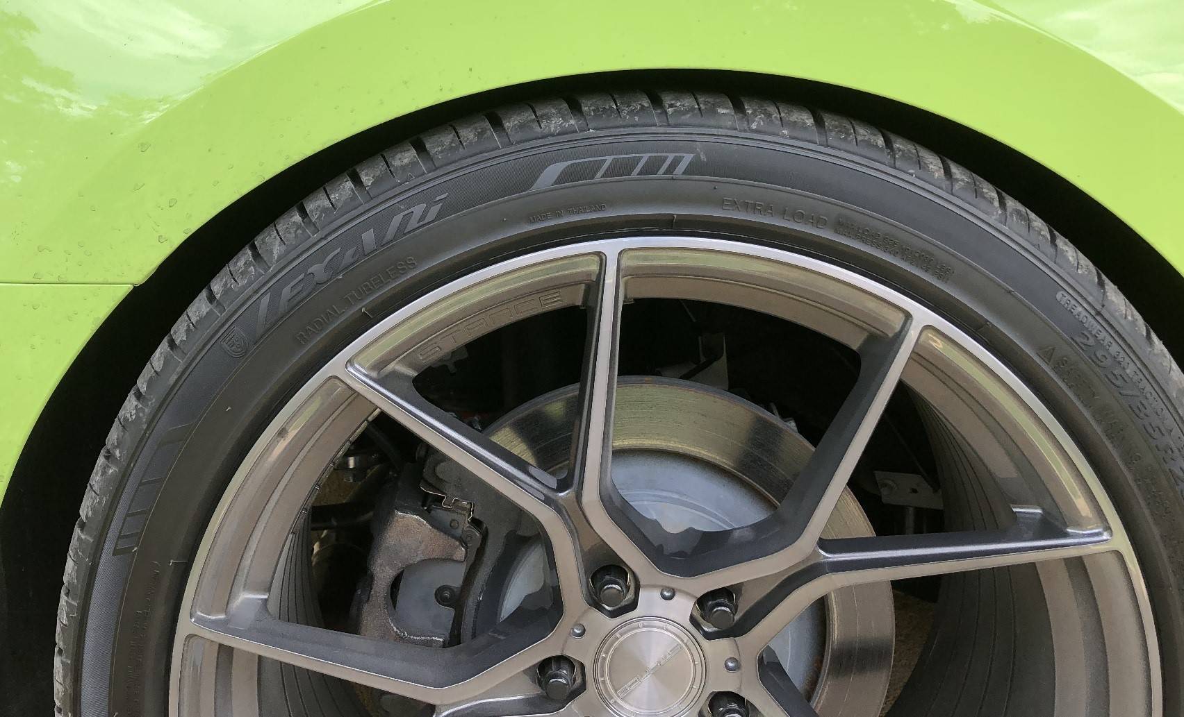

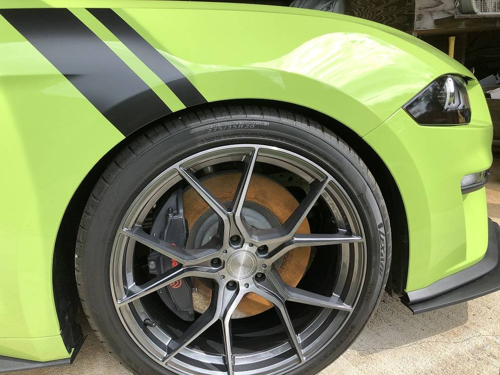

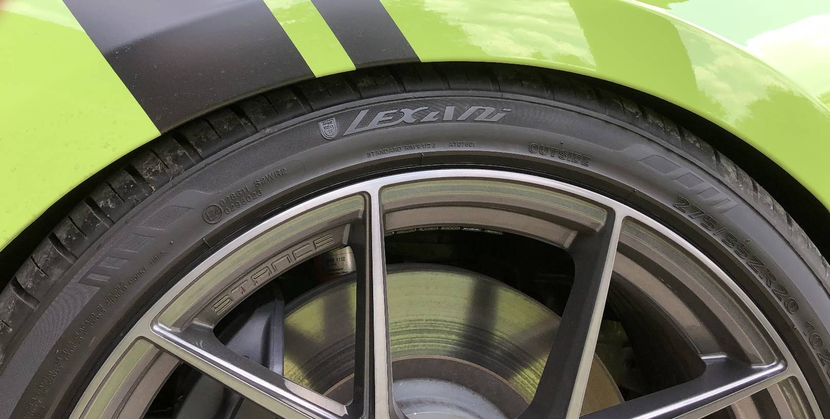

Don't feel offended by you are spending waaaay too much time trying to fix suspension problems you don't have while you're missing on just about most important and easiest piece that contributes to car handling - you're running some absolute junk tires (looking at your pics). You can spend million dollars and three years putting suspension parts on your car and it'll never handle well if you run lousy tires. Seriously.

Yep, you're right. I got those tires for next to nothing when I ordered the wheels so it allowed me to get the car setup with all the suspension mods and make sure everything was on par before replacing them with something else. All in all, the difficulty getting the car aligned and the front steering and rear squat after changing the rear springs hasn't had anything to do with the tires. They are loud tires on the road that is for sure. They will be replaced but first things first, I have to get the alignment dialed in. Didn't expect to have to get into everything I did when I started this. About to have a 3rd set of springs...$800.00 in springs alone.

Spoke with John over at Steeda today and explained everything I have done to the car and what I am feeling and he took a look at the current drop on my car in these pictures and recommended to go with the minimal drop springs and not order the roll center / bump steer correction kit since bringing the car back up a bit in the front may not need it. I also asked him about the Koni STR.T struts and shocks and he stated they have done a lot of testing with those and they most definitely are not a problem for what I am doing. So I think I have a plan, install the new springs, get an alignment dialed in and test her out and if the steering still feels worse than it did from factory then I will go with correction kit.
