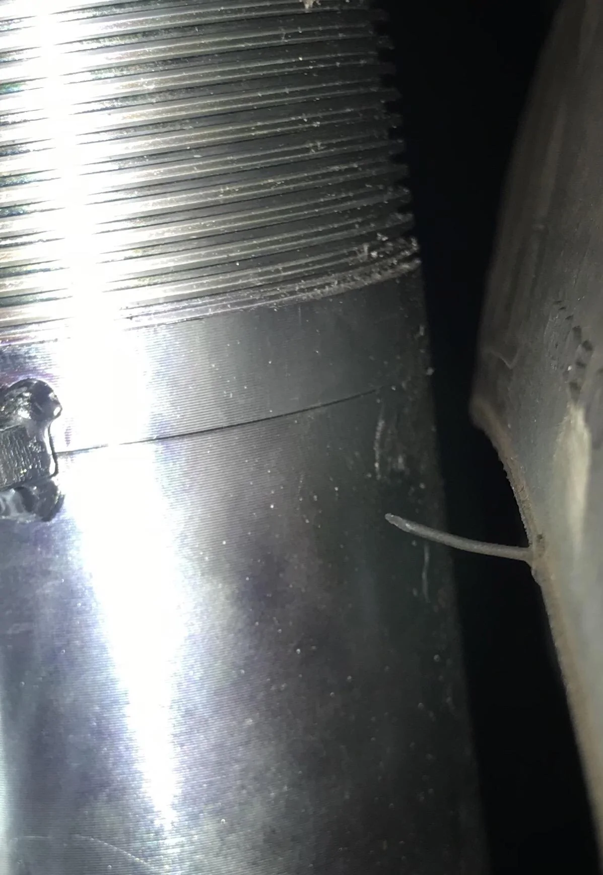

Coilover clearance with tire
50coyot
Mar 8, 2018
Long beach california
Gus
Red s550
This is the clearance betwwen my tire and coilover. What u guys think? Driveable?

Im runing 295/35/19 on a 19/10 wheel
18x13/335 with less clearance here (2mm), no issues and driven HARD. you'll be fine :thumbsup:

As others said, you're fine.
I've ran less clearance on tracked cars and no issues even when pushed hard.
