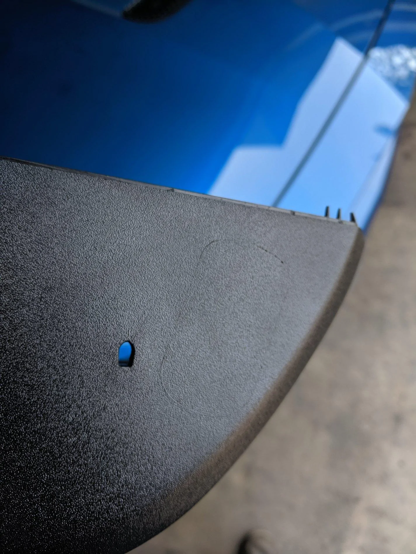

I ordered the passenger side from the dealer and it will be here tomorrow.
Passenger side is $20 and driver $79. Crazy.
Looks like you need to have the harness or run positive and negative wires to power source and I know exactly where to get it from.
Also, you need to cut out the bottom of the mirror. It does have a outline for the cutout so that makes it easy.

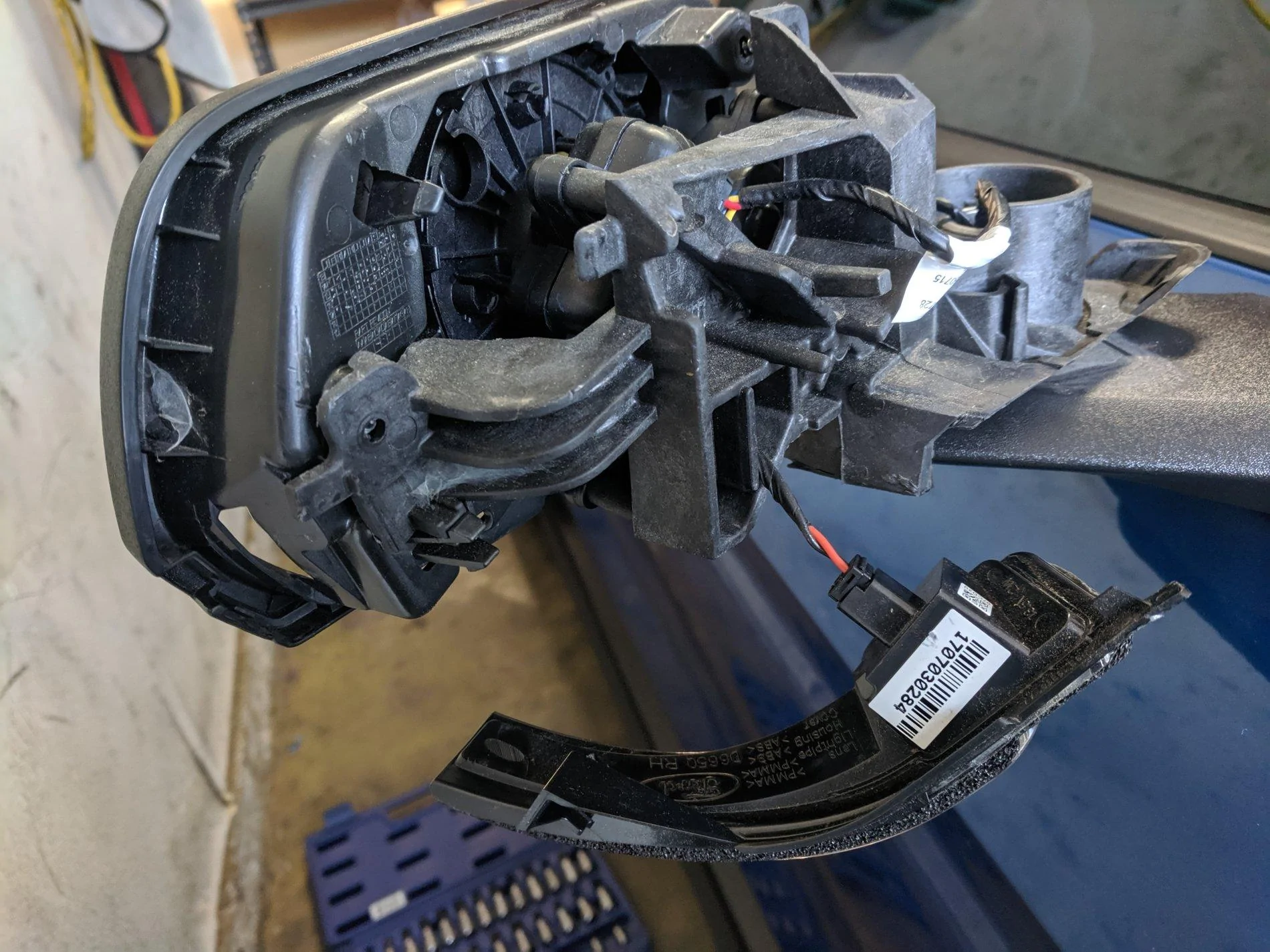

Ok we don't not have the harness. So running wires is required.
Here are the pictures. You can see the outline on the bottom of the mirror so you can cut it out. I will be using a sharp blade to cut it out.
You have to pop the outside (gloss piece off) by pulling it out slowly and gently.
The inner piece you have to unscrew 2 T10 torx by pulling the mirror completely to the side . Dont try to pop the mirror off or else you will break it.

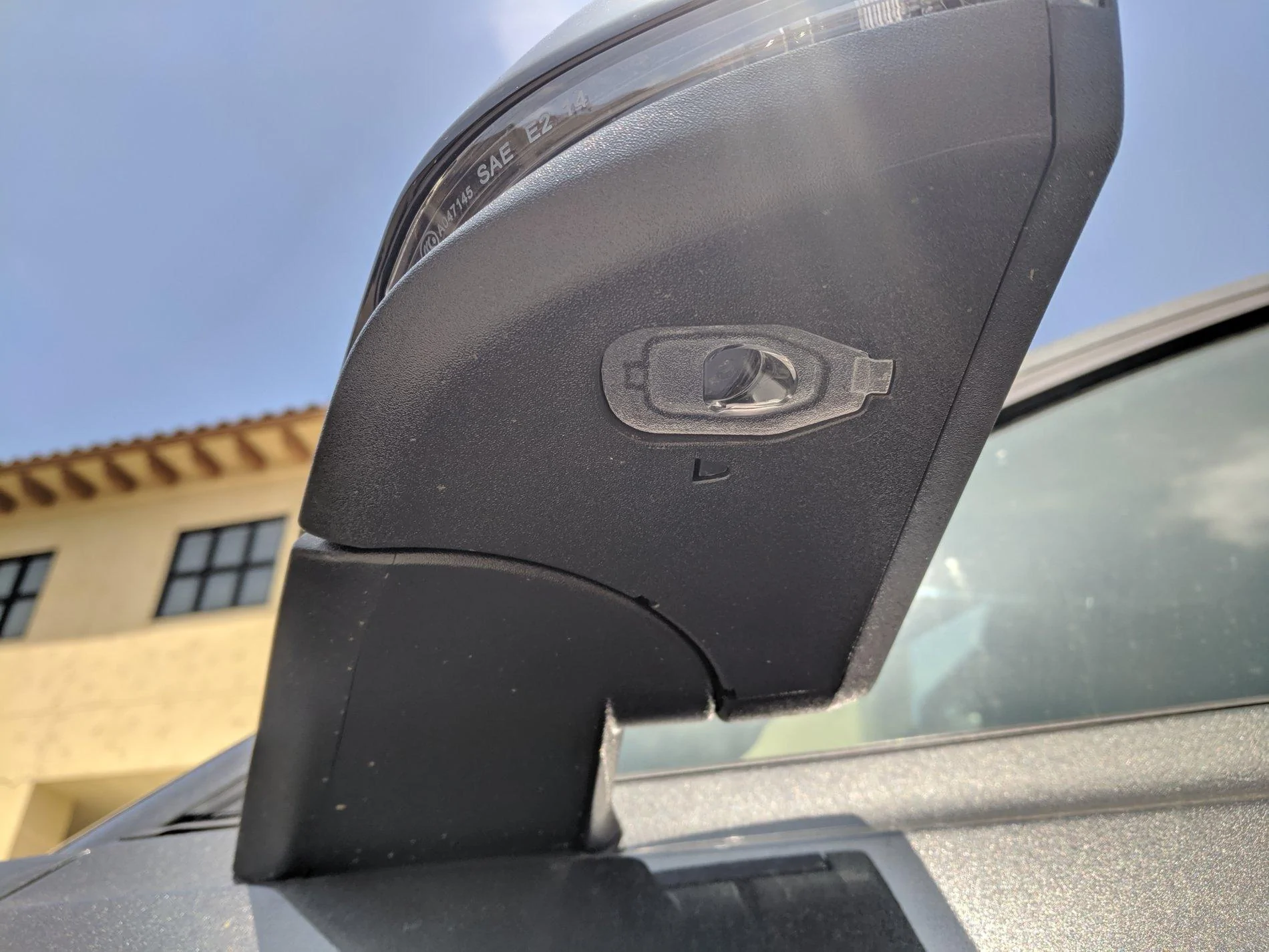

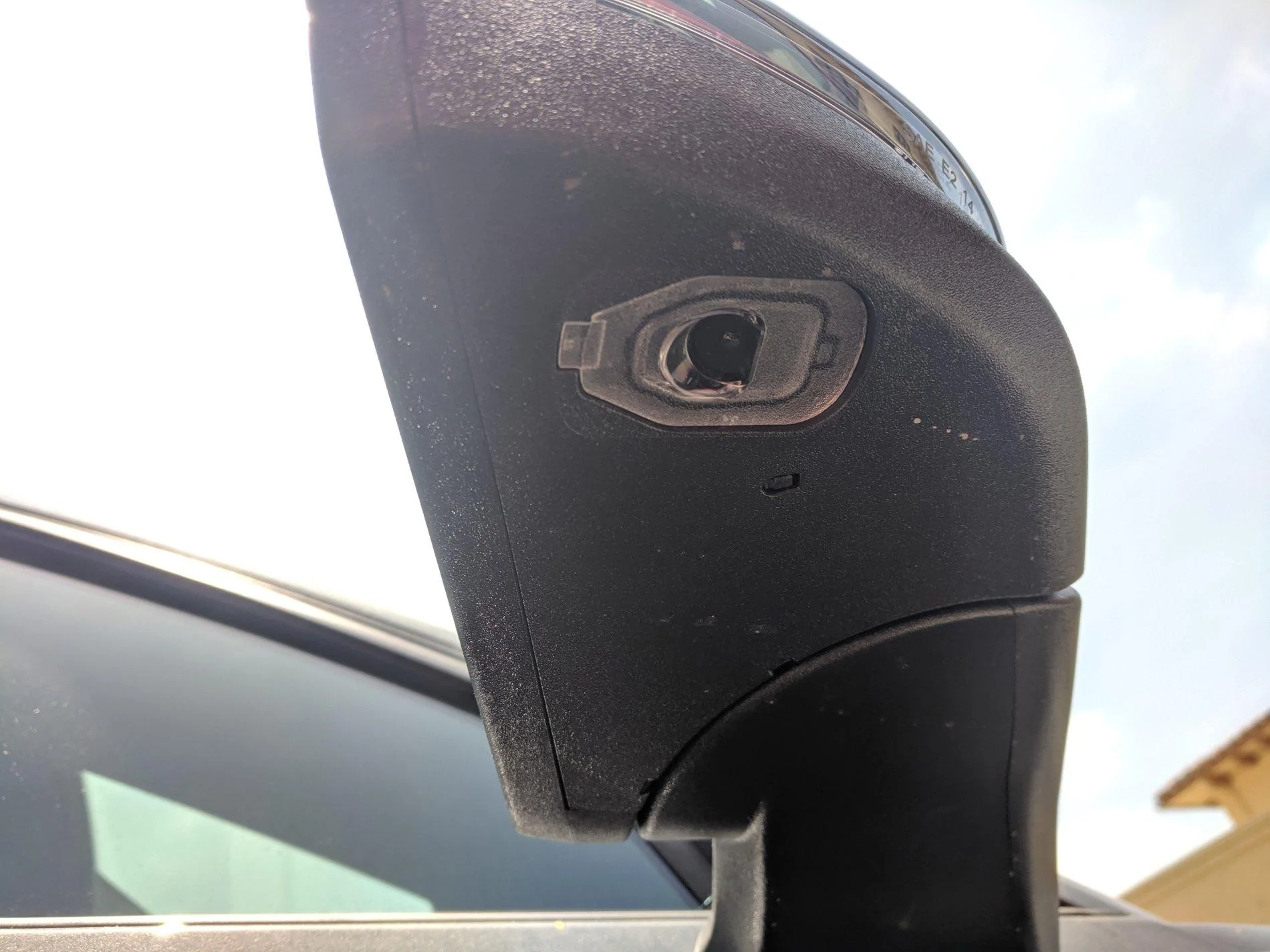

Well boys, Ford part system is fucked up like usual. I test the light out before installing it and it was a damn pony.
I gave them exact VIN number from a 19 Shelby on the lot and this is what they come up with.
No way to find the part unless someone pops the gt350 light out and gives me the part number.
