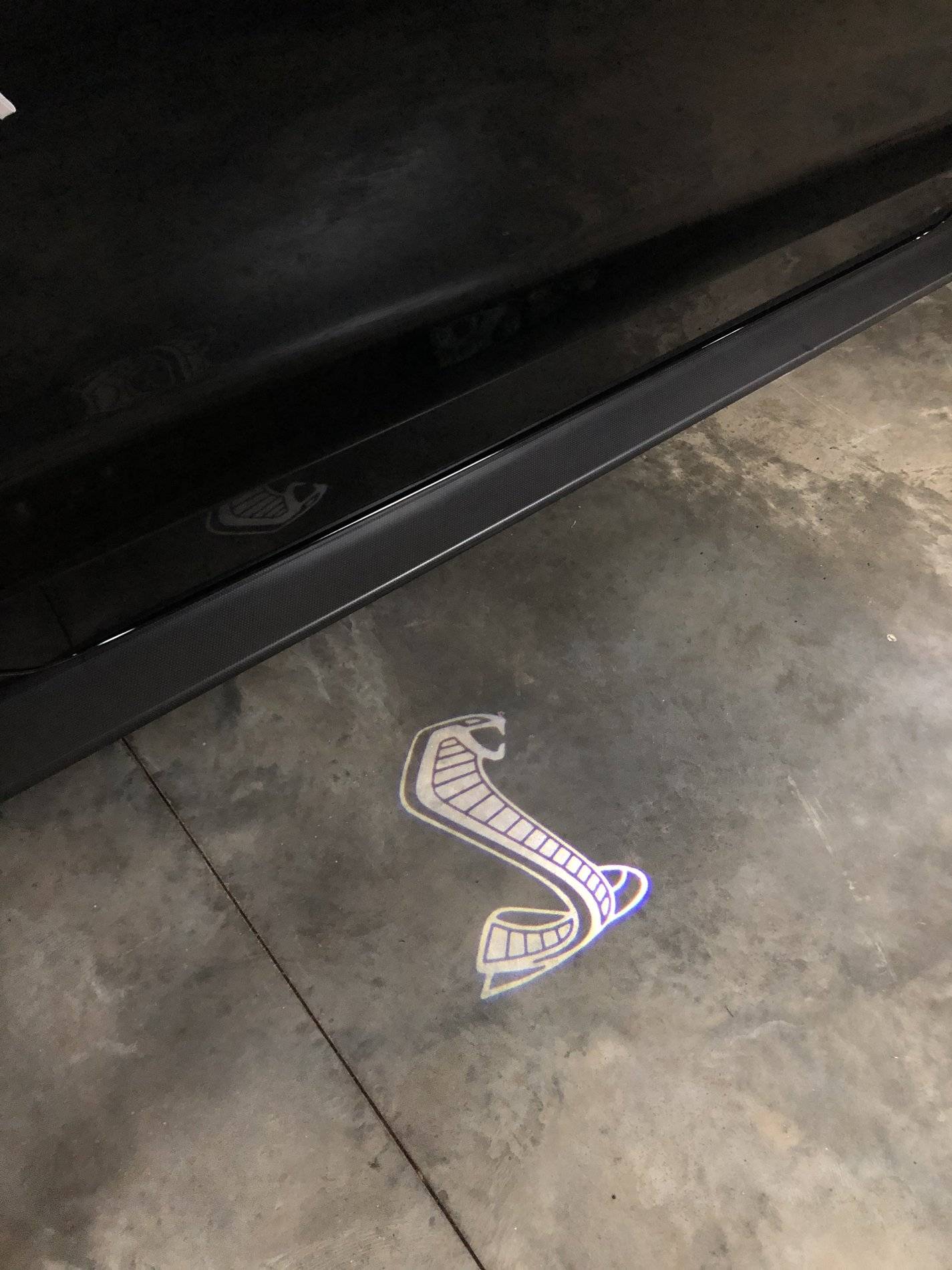

So I can 100% confirm that a 2019 GT350 mirror is plug and play to a 2018 GT350 . I got a really great deal on a pair of 19 mirrors off a wrecked gt350r the options on the mirror where blind spot , defrost and puddle lamps. I removed my 18 mirrors and also removed my caps and glass the 19 mirror needed caps. I than removed the 19 glass and unhooked the blind spot and defrost. Installed my glass and cap and put everything back together and it all works perfect.
Jobsi, what was your build date? I just installed '19 gt350 mirrors on my '18 LFG GT350 just like yours and mine don't work....? I left the blis/defrost glass in, you think that has something to do with it? Any help is appreciated, really bummed as I thought these would be plug n play on my '18
Rayjones86
Feb 25, 2023
Casey
2018 Shelby GT350 (LFG)

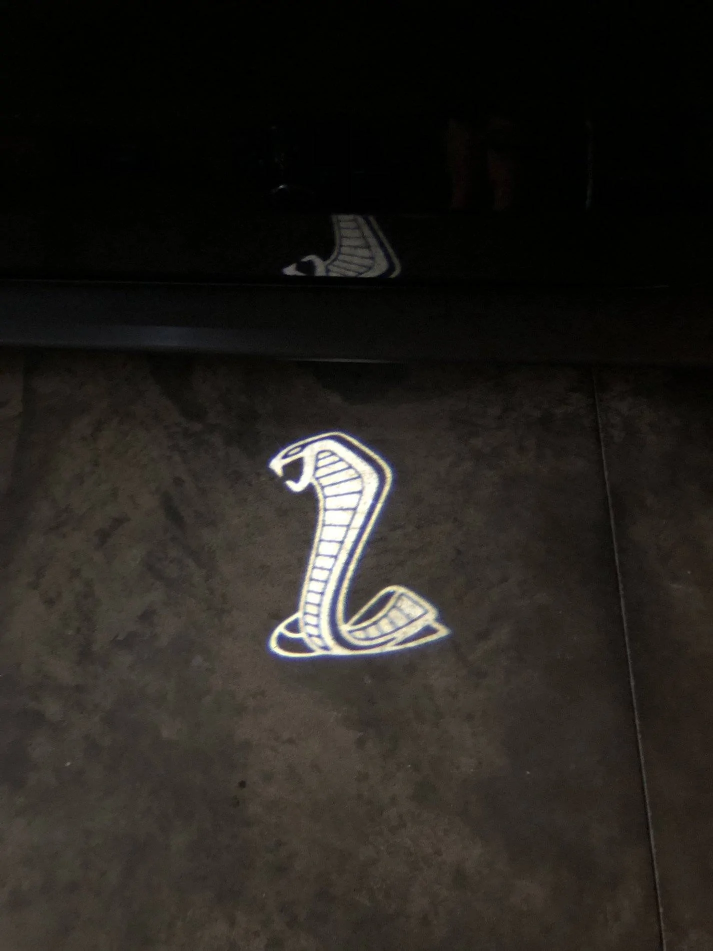

Big props to Niz55! I saw this write up and decided to add these to my 2017. I agree with Niz55, it is a pain in the rear, but I love the out come! I got a bunch of pics and advice if anyone else is wanting to do this!
I will take any info you have. I have an '18 GT350 and thought this was going to be plug n play but it isn't. Any help would be much appreciated.
