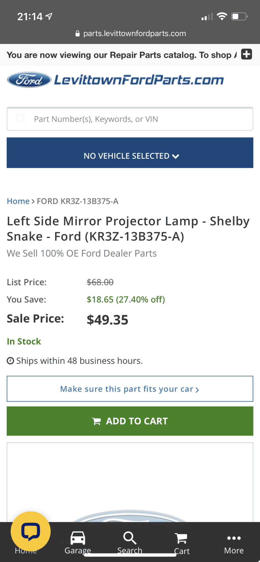

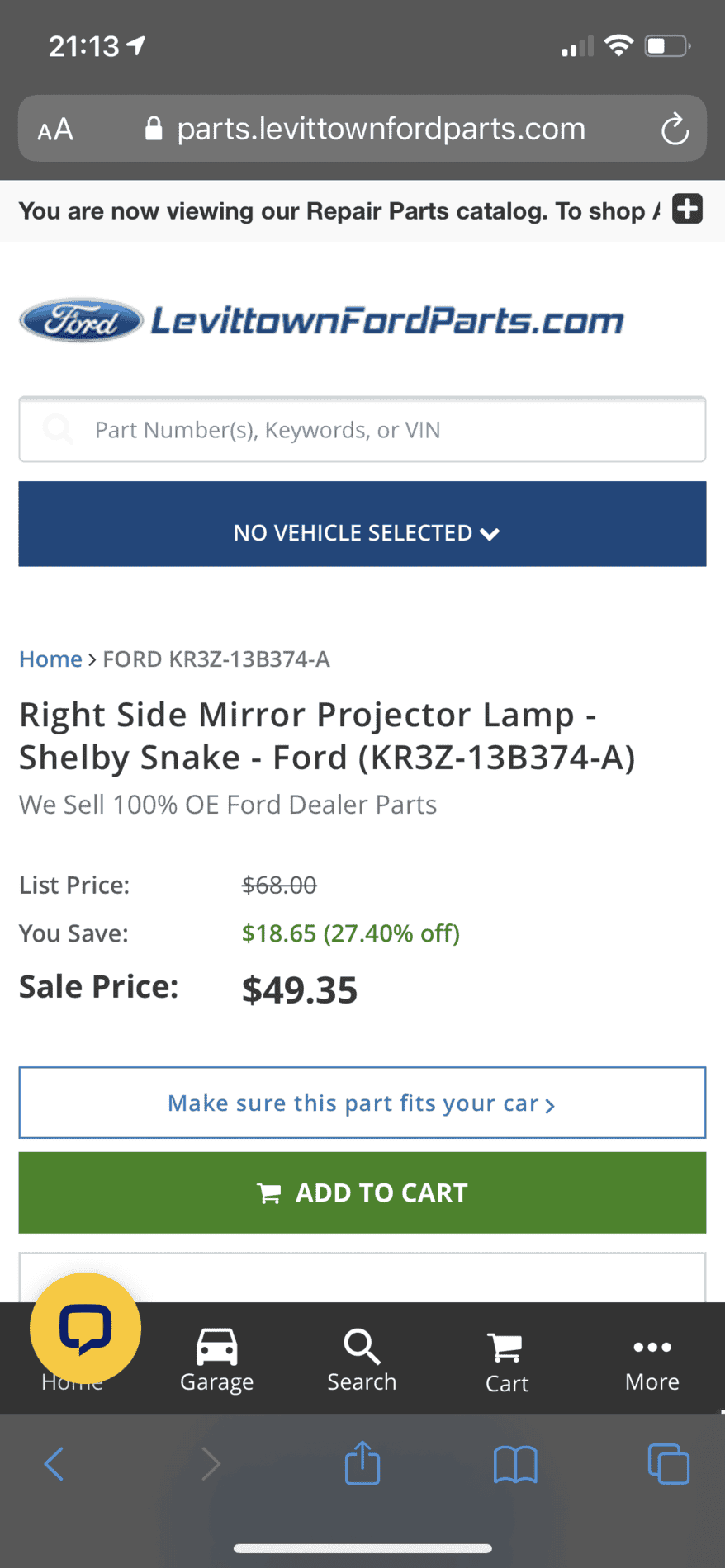

can you please provide the part numbers for right and left - will the cobra lights fit on a 2016 GT350 / GT350R ?? I appreciate your assistance
If your vehicle does not come with the puddle lights originally then it is not plug and play. You will have to replace the mirror assembly with a puddle lamp mirror. And even then it may require playing with the wiring.
