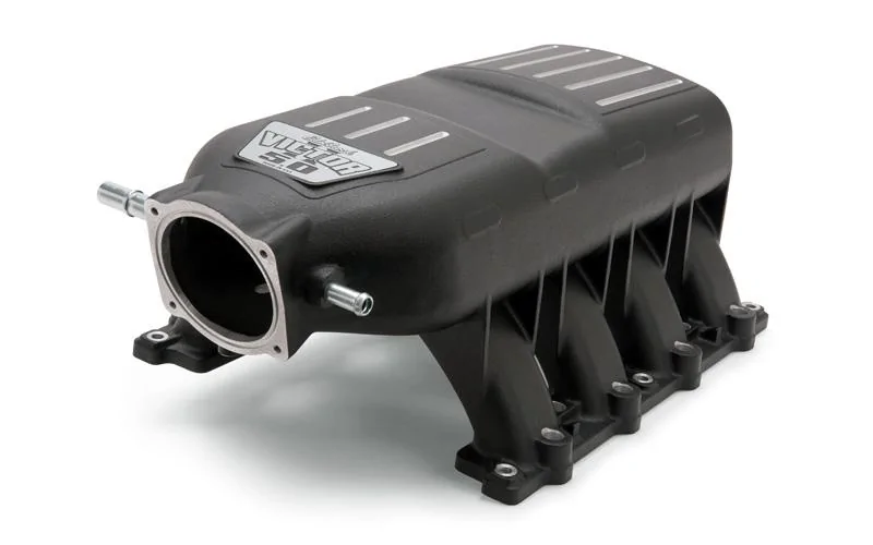

Kind of surprised no one has mentioned this intake manifold.

The only person that I know using it here has no comparisons to anything but his oe manifold with his procharger and he added other mods at the same time if I recall right. I wish there was more on that one. I've searched other forums. :(

Not trying to start anything but thes aluminum manifolds will be large heat sinks. I am pretty sure any gains will be lost once heat soaked.

Another member took before and after temps with his procharger on his sniper set up vs the OE. It was consistently cooler by quite a bit, everywhere he took readings.

Was he using an IR temp gun? Could be that surface temps were cooler with a brightly colored aluminum intake vs a black plastic intake.

I believe so. Z06psi also stated when it was so hot he didn't want to leave his hand on long with the OE that with the sniper it wasn'like that. His sniper was also black.

Not a pipe dream. I am making over 500 and 412 torque to the wheels with my built 5.2l Voodoo with CPC and turning 8400 rpm. This is still using the GT350 Intake manifold...CJ manifold could be worth another 25hp up top. over 4K miles on it racing and DD use.
