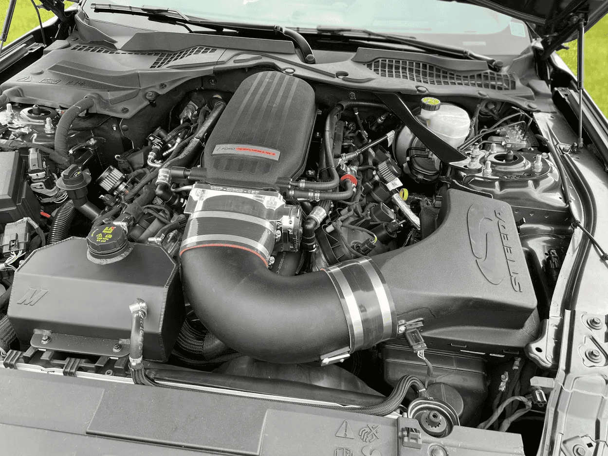

They only say that because it doesn’t have a provision for some extra vacuum line that is only present on the A10 cars. Other than that, it is the same install for A10 or manual.
All you need is:
CJ manifold (I would buy one ported)
CJ specific air intake (prefer Steeda closed
box for IATs)
VMP throttle body for easy plug-n-play for 2018+. (I use the Monoblade 137 but they say the Twin 69 is more streetable)
BMR engine lowering brackets that still work with the stock mounts for no added NVH and lowers engine 1/2” and also remove hood blanket
or
Remove hood blanket and cut the Jesus cross brace out of center of hood. It will clear without any engine lowering.

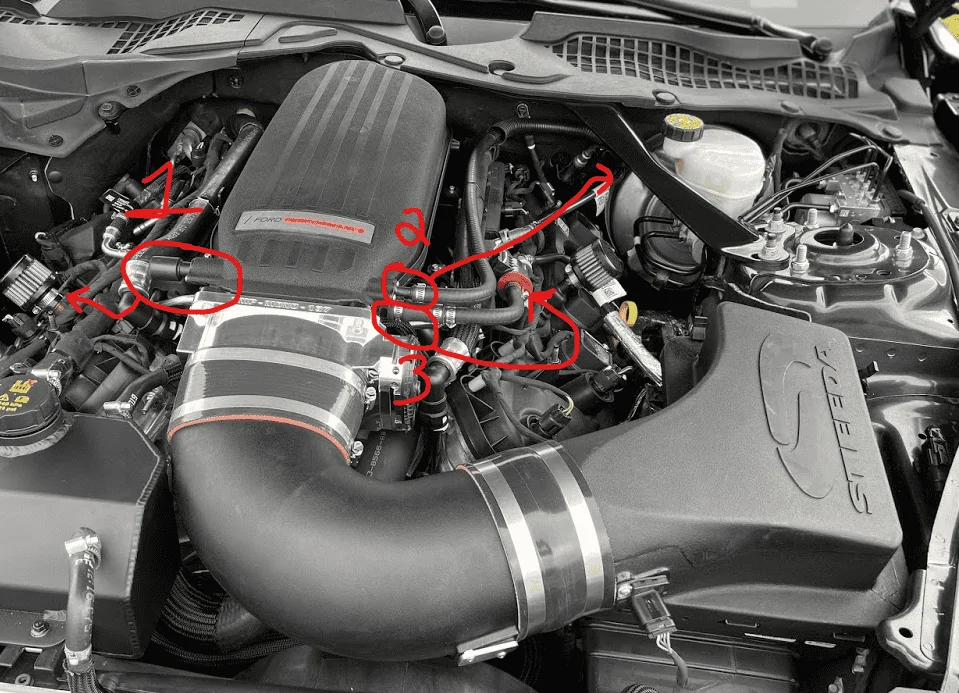

I didn't make any extra connection. You end up ditching all the vacuum hose crap that sits bundled up above the stock throttle body on the stock manifold. The CJ only has 3 vacuum ports on it. On my setup, I capped off the port labeled 1 below. That would normally go to your PCV or catch can setup, etc. I went with breathers on both valve covers so I capped this port 1 off and also did not drill a hole in my Steeda inlet pipe that would go to the driver side valve cover. Port 2 goes to the brake booster. I ran a new hose for this (cleaner look) but you can reuse your stock brake booster hard lines if you like. Port 3 goes directly to the orange vacuum connection to the part attached to the driver fuel rail. (sorry, forget what that's called but you will know what it is when you look at your car)
That's it for the vacuum connections. Much cleaner than the stock vacuum hose rat nest. Your tuner will take care of the rest in your tune. The IMRCs are deleted.
