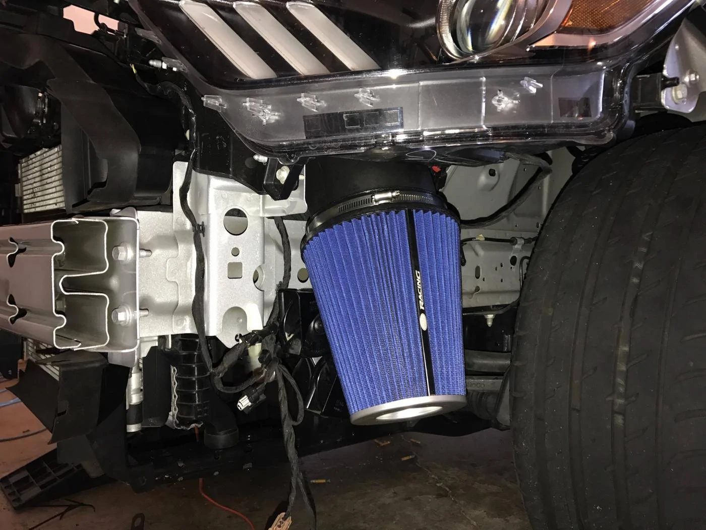

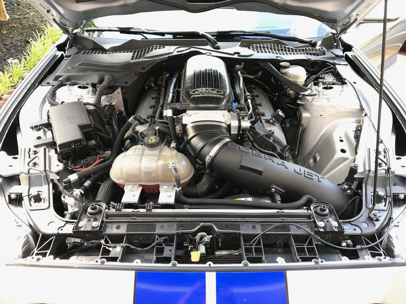

Question is, do you want to make power on the dyno or on the street/track or both? Intakes like PMAS and to a certain degree the DMak one make great power on a dyno with the hood open and a huge fan blowing air directly into the air filter, but suffer on the street with high IATs and less airflow. Other intakes such as the Steeda closed box or the CJ CAI are much more consistent and make good power on the street also:
My vote is for the CJ CAI:

Where did you find this intake for the CJ? I found the supercharged version of this intake. Looks like this one came with a 45 degree coupler?
I believe that's the supercharged intake, but with a different coupler to make the 45* bend up to the oval throttle body. You can buy those types of step down/transition couplers from several websites.

This looks like a true cold air setup, but I do have questions.
Who tuned it? Any dyno comparisons? Any drive ability issues?
Oh that's not my car, I just found those pictures online. I have no clue who's car it is unfortunately but I'm sure it can be tuned to be run fine. Maybe not 100% stock like, but it should be fine.

That intake goes a little too far down for my taste. Don't be caught in a thunderstorm or drive over puddles.
Do you often drive through 2 feet of standing water? If so then yes this intake would become an issue, and might I say if you have that kind of water in your neighborhood you have much bigger issues than your engine hydrolocking :idea:.
Otherwise there is 0 issues even driving over puddles.

It only takes a few inches of standing water to splash against the filter. And in Florida, we do get heavy rainstorms alot during the rainy season where there can be spots of minor flooding, so yes, this would be an issue. It's not a risk I would personally take.
