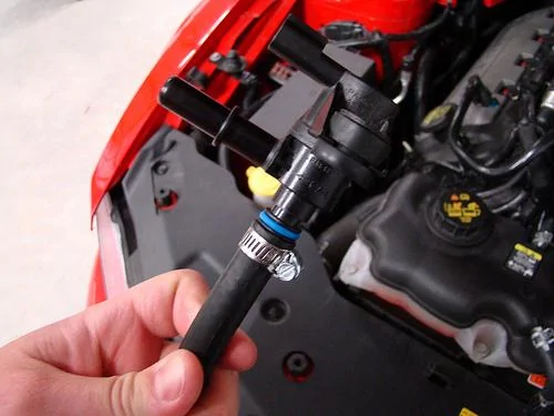

Just finished up install of cobra jet intake mani, mono blade tb, cai, billet oil pump and crank sprocket gears, and circle d 4c converter.
Keep getting evap code thrown. wanted to see what the guys who have done this intake install have done to get the evap code to quit throwing. everything is plugged up and runs fine but tired of seeing check engine light. Thanks for any help.

You put the line on backwards...Swap them, the hose that attaches to the manifold goes on the part of the EVAP solenoid that went inside the stock manifold.

You have a pic of your setup? I've got mine the same as all I could find online.

The barb with the O-ring is where your 3/8th hose will attach, the other end will of to the driver side of manifold.
The OEM hard plastic quick connect line will connect to the other fitting

Thanks, that solved the problem
