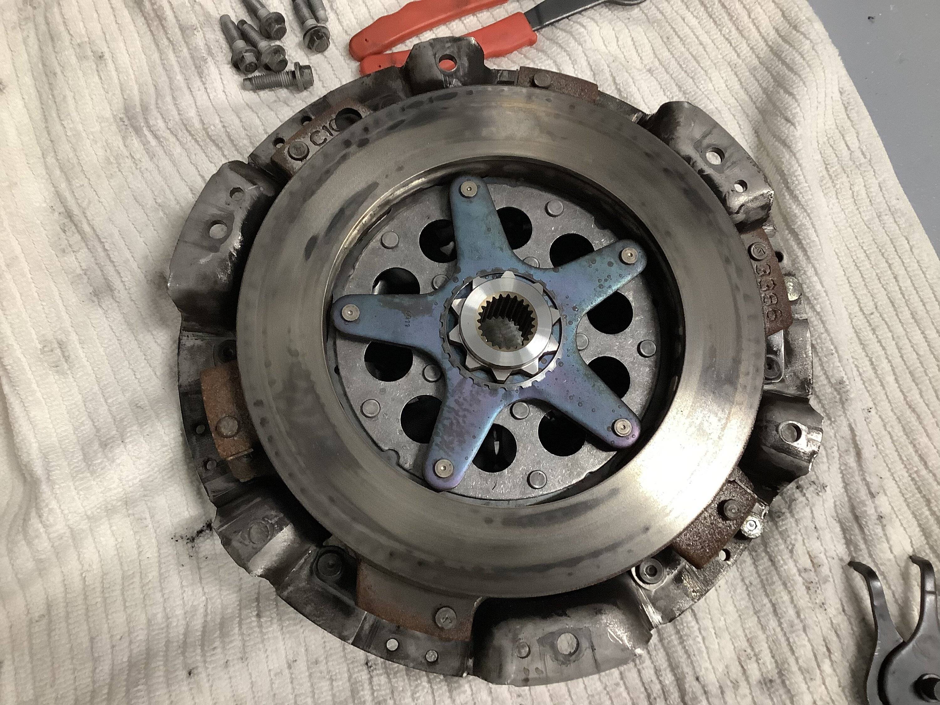

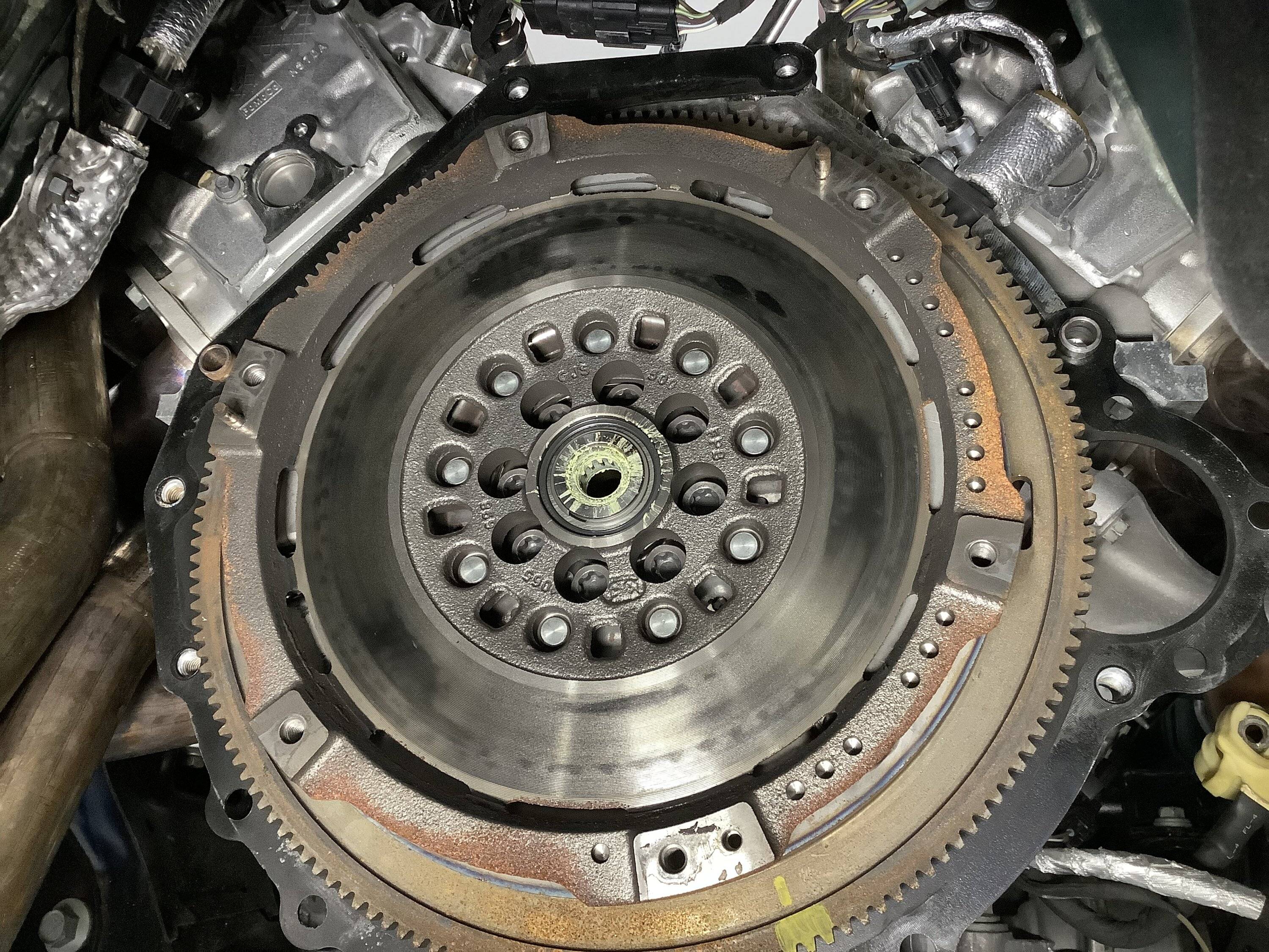

How much power does your car put down at the tires? Do you just do wot pulls in a certain gear or do you drag or roll race? You could have some hot spots on the clutch. I burned mine up at just 6400 miles and 5 full 1/4 mile passes, one of which I smelled clutch when I came back to the pits. At one point, I took off very easy from a stop, heading to the staging lanes and the car was jumpy, like the clutch would grab and release quickly. I also got some slip (could hear it in the car on the last pass), but the mph was still normal @ 116.XX. Here’s what my clutch and flywheel looked like upon removal and inspection.
Power wise, my car was making 469 rwhp and 434 rwtq.
I still think you just had a defect. Maybe pressure plate wasn't holding the clutch firmly enough? The stock clutch should easily hold up to that power level and 5 drag strip passes. Unless you were slipping the hell out of it or something to keep wheel spin in check.
Yes, I think my problem was caused by my improperly adjusted Hitmaster Clutch Hit Control System.
