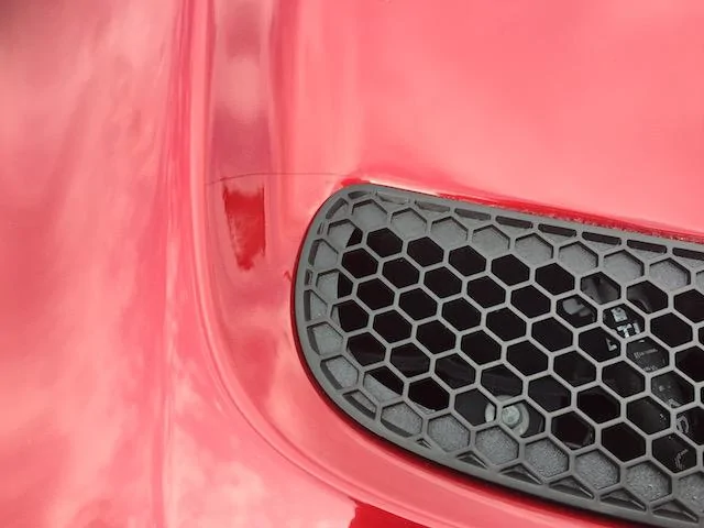

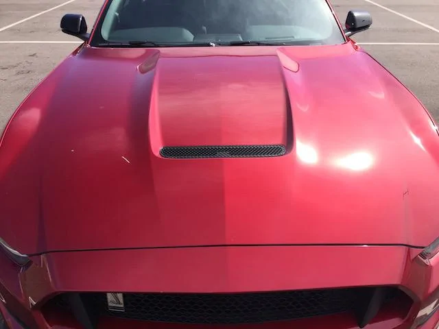

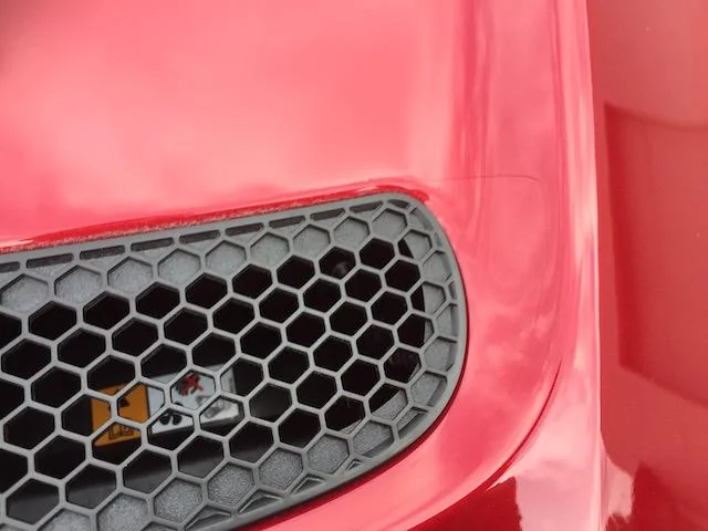

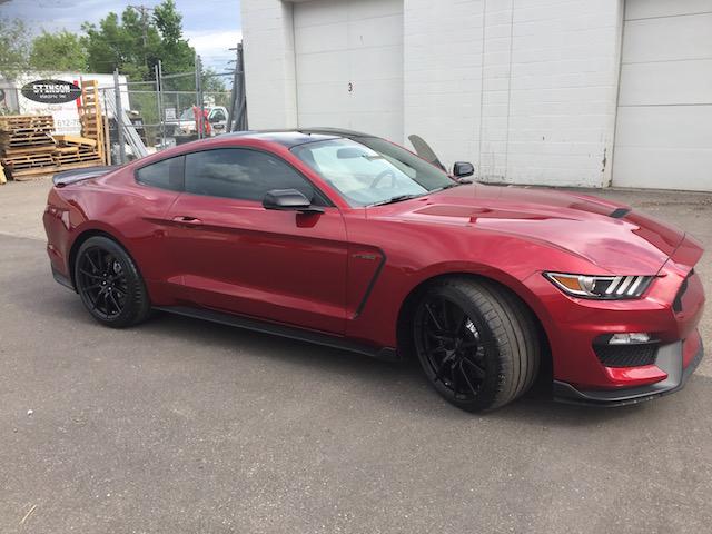

I'm really happy with how it turned out. My only minor disappointment is how they did the hood around the vents. It looks like they didn't do it the way you guys were talking about. But, other than that it turned out really nice, I can't see seems unless I am really looking for them. As long as it holds up over the years I'll say it was worth the cash. With proper maintenance of course. Sorry for the crappy pics, but I haven't had time to do any better ones. Also the white mark on the hood is something from my camera and not on the car.

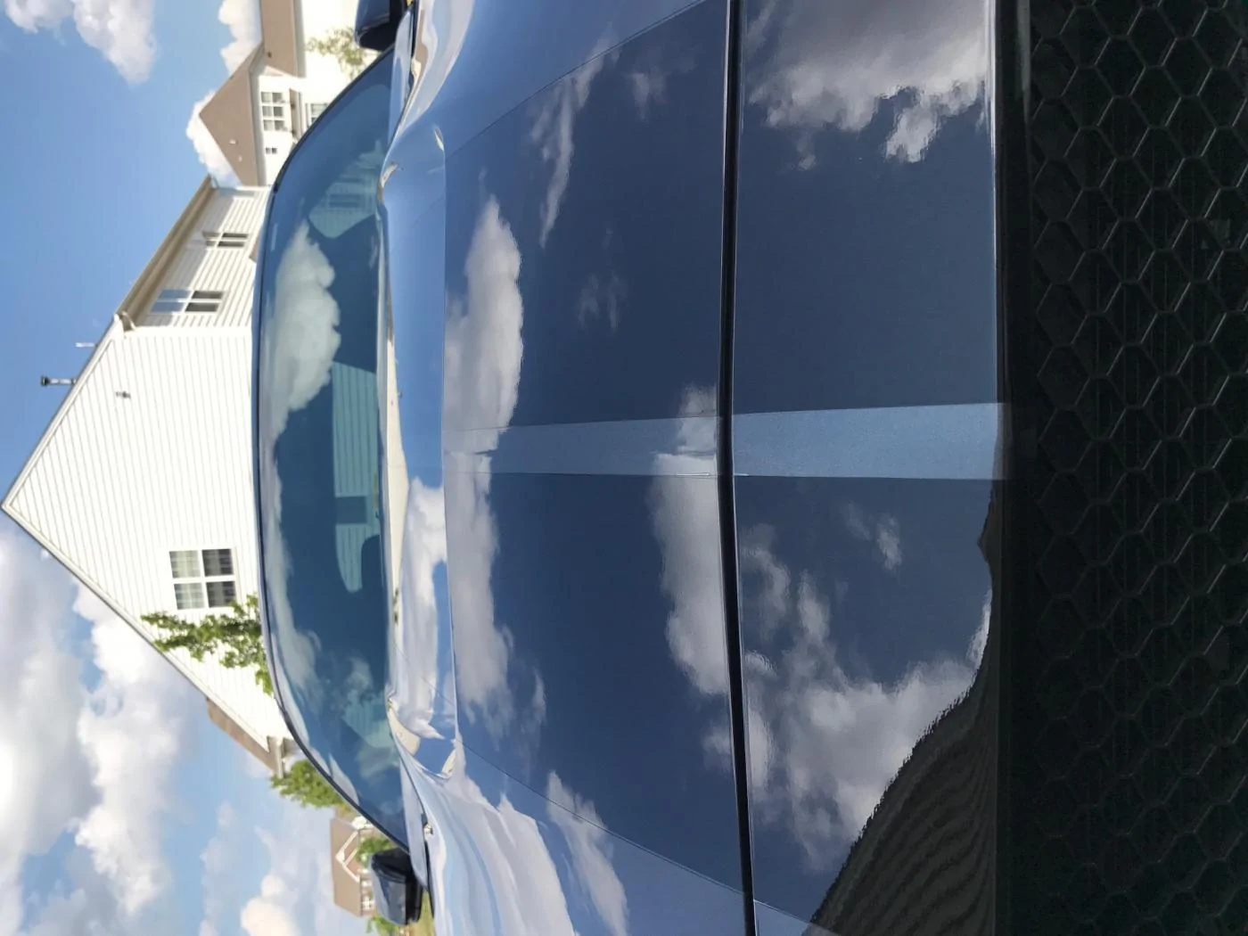

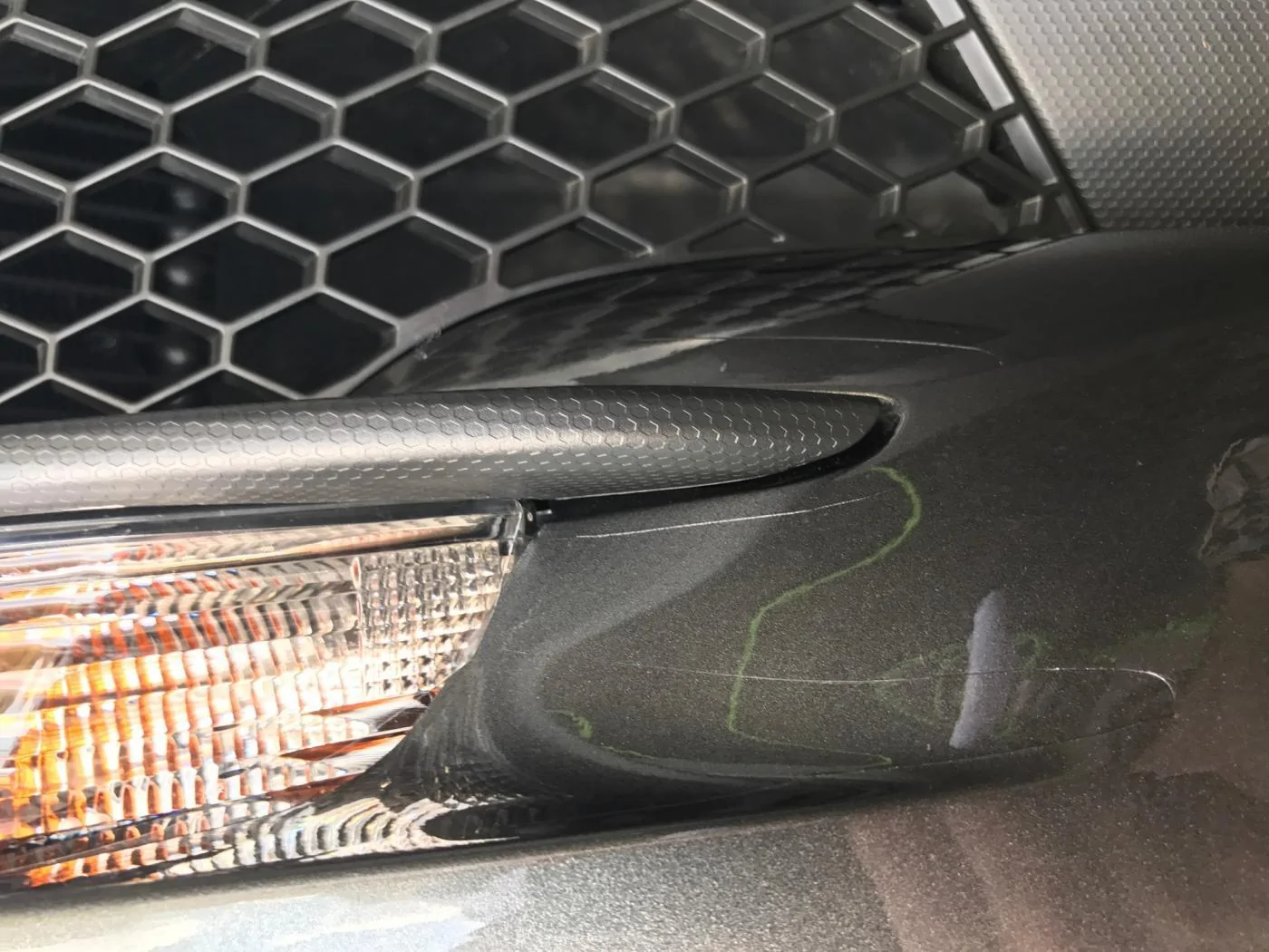

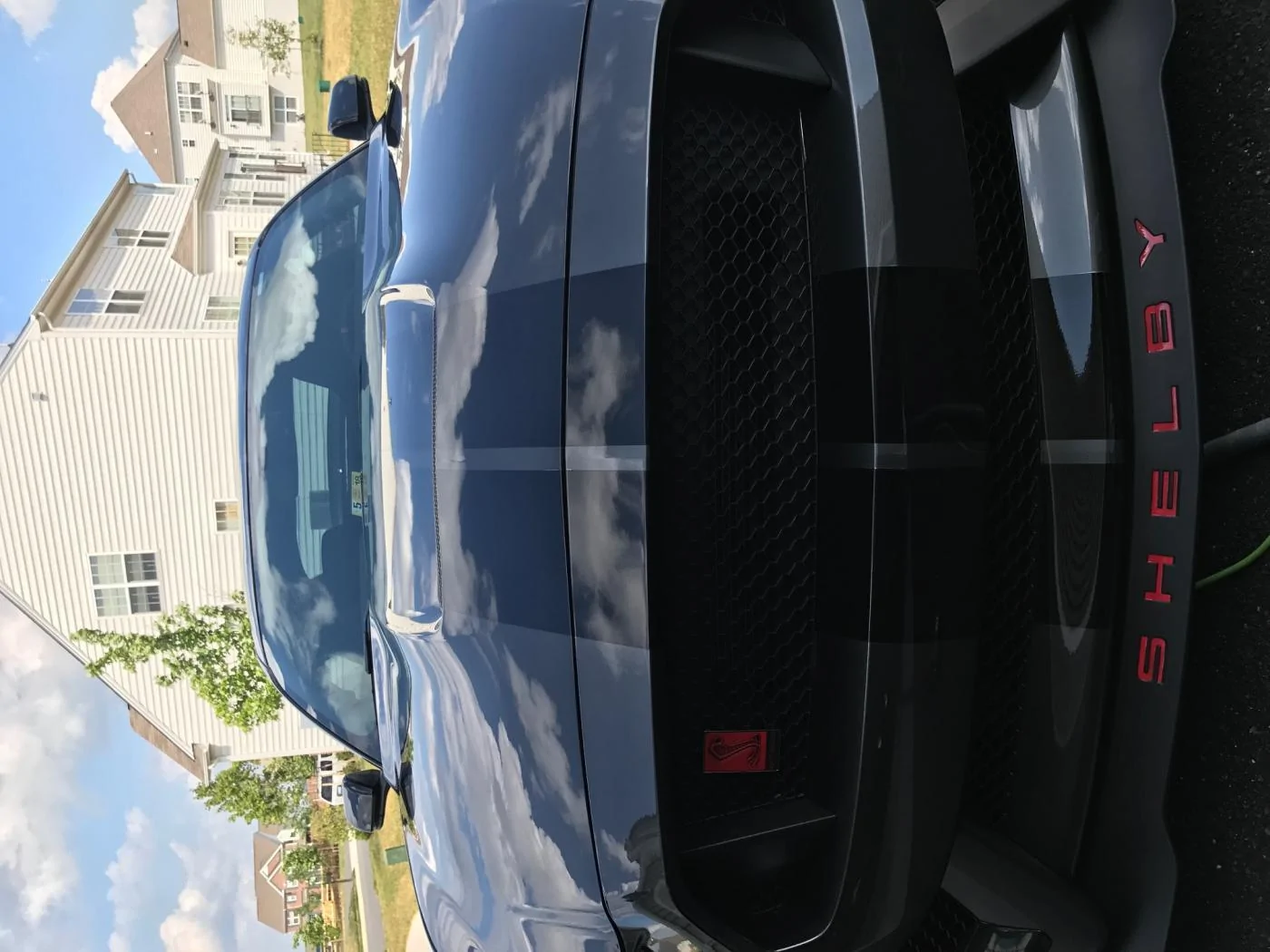

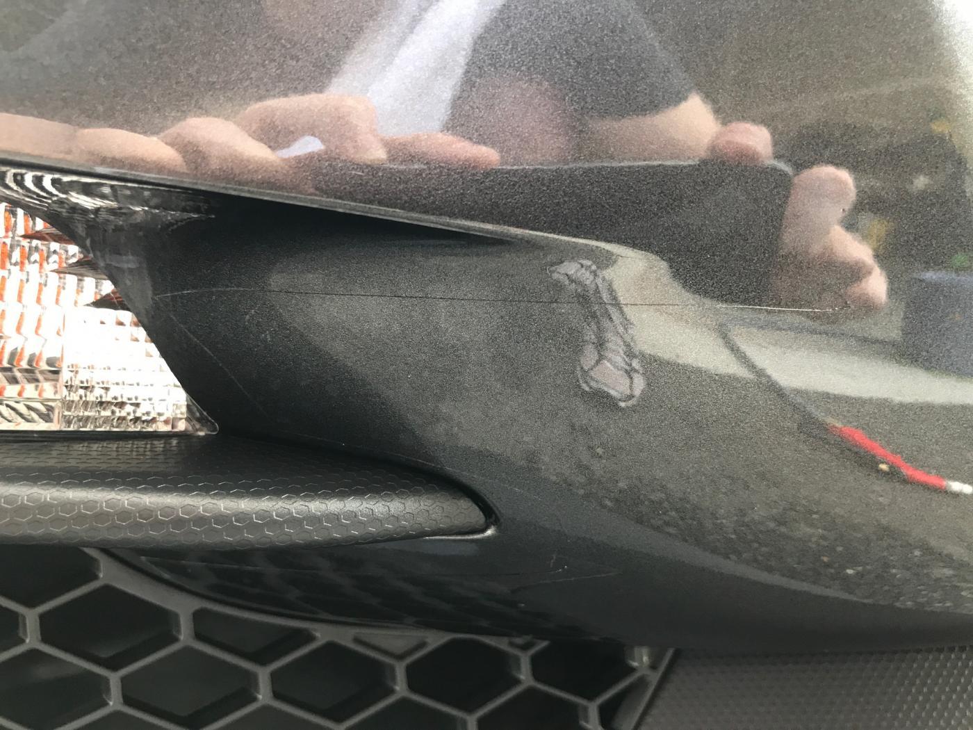

Cool thanks for the insight...I will post a couple of pics if pick-up of the car goes smoothly tomorrow. Would really love to get the insight of members here...esp on what the area around the fog lights (not turn signal) *should* look like vs. the pic I will post tomorrow
Here are the results on the stripes and around the turn/fog light area I referenced…you can see the tiniest little air line on a small section of the left stripe:
