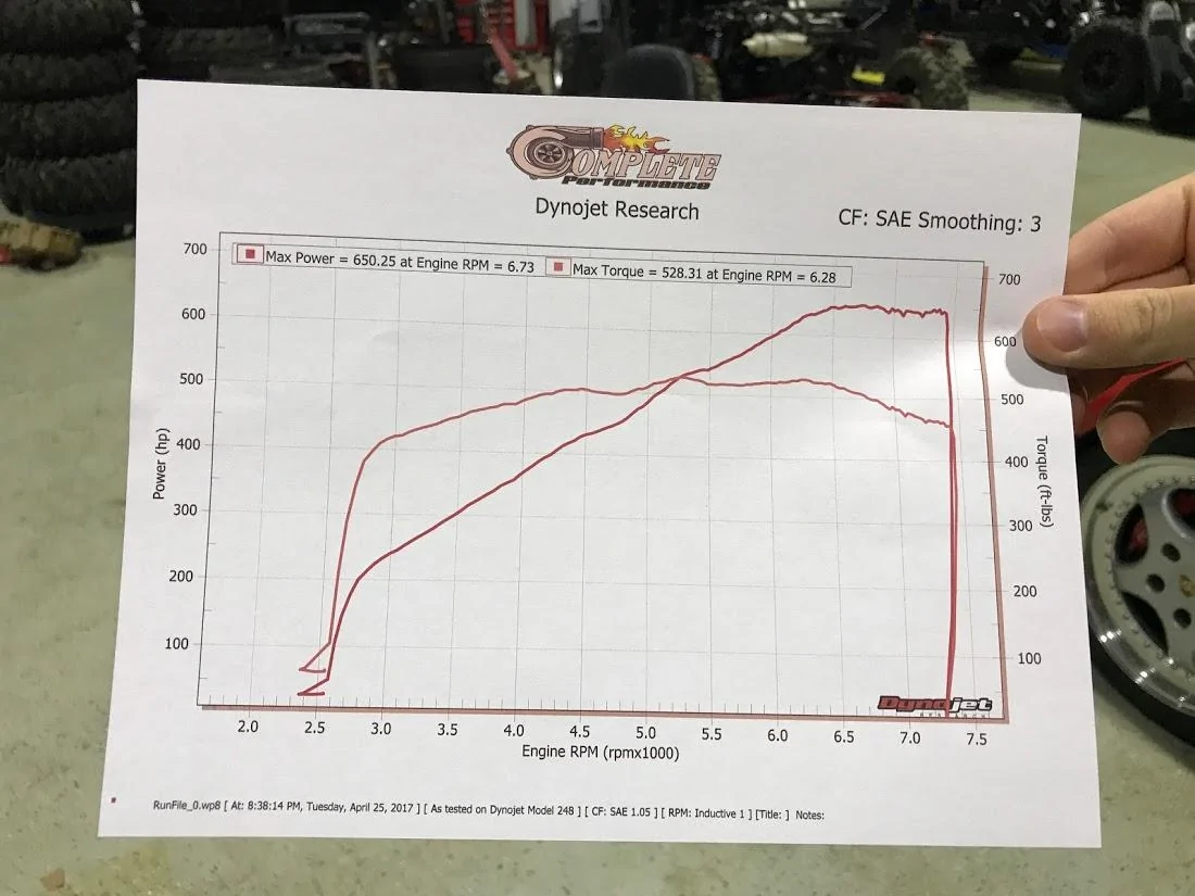

Shorter runner manifolds like this, boss, sniper will always make more top end power than that stock manifold will, and not taper nearly as early.
What boost is that pulley making?

Nice numbers man,now u have to take that beast to the track.Rockin for a P1.

10.8 is where my boost+ shows at 7300 rpm

Yep thats the plan. Just got my drag setup...18x5, 17x9 Darkstars with M&H front runners snd 28x10 hoosiers. Hoping for deep 10's.

U should have no problems doing that,i went 10.603 with the 373's have 331's now but have to get my clutch straighten out.Your making more power then me now,but that 5th gear shift will hurt your et some,but with good air you should be able to get low 10's.Never mind u have that 6060 now,low 10's no problem.

I did the IMRC delete for my stock GT manifold and I have the 6600 flatline with my D1SC, as pictured. Thinking of going to a different manifold to get it to keep pulling. Lund recommended the GT350 with IMRC deletes.

So either shitty characteristics of the manifold or tune. Some have fixed the flatline via a tune, but tuner kept info to himself. I don't blame him for it, it's his work, but makes me skeptical of what he did. Either way good numbers either way man, can can still be shifted at 7200 no prob.
