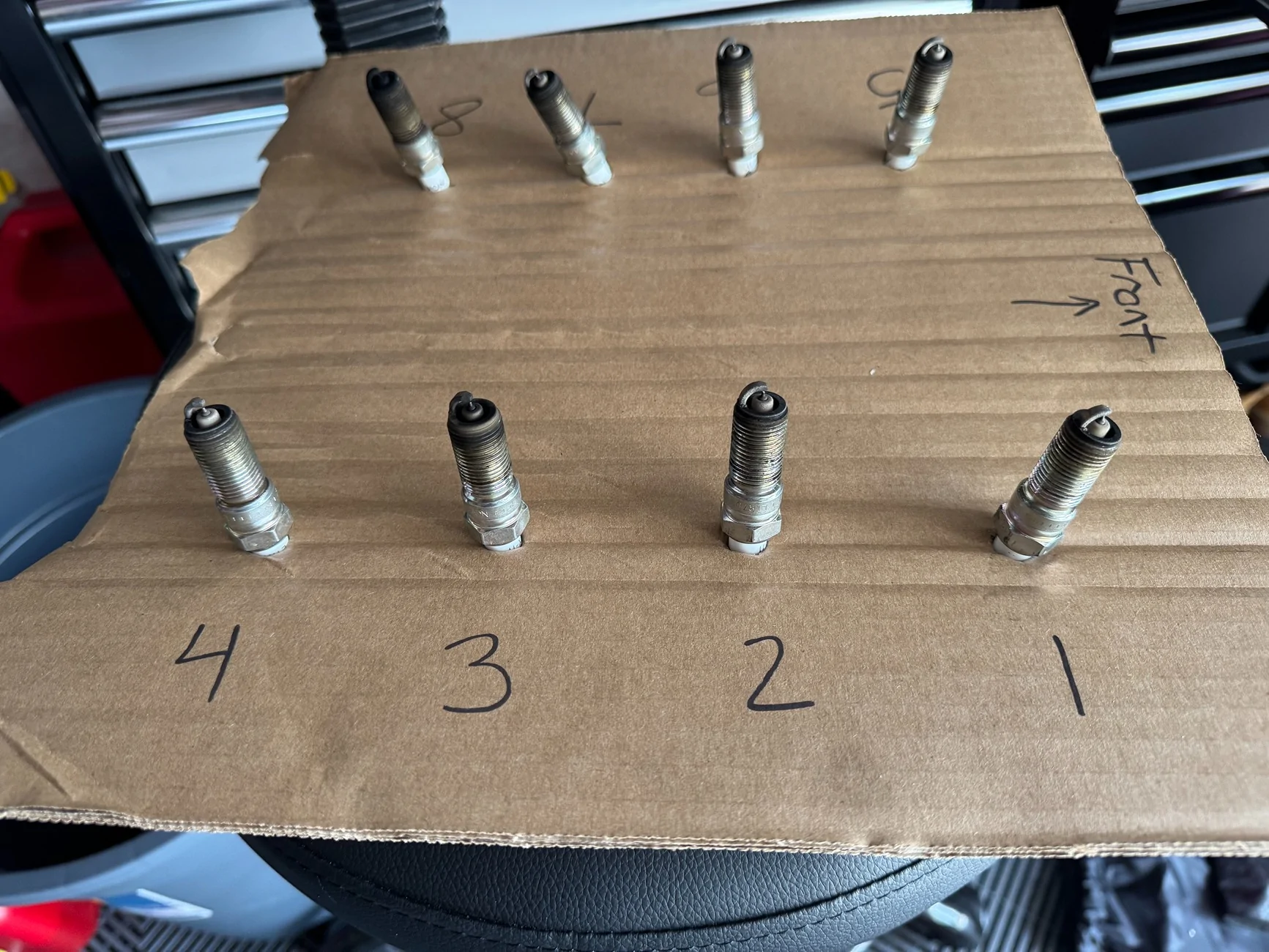

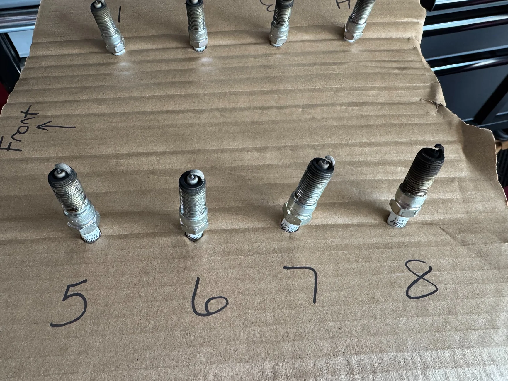

So I just pulled the spark plugs today, #8 was really dark and wet when I pulled it, reeked of fuel. #3 was also a little darker than all the others and slightly wet and smelled like gas, so I am thinking I have an issue with both of those Direct Injectors.

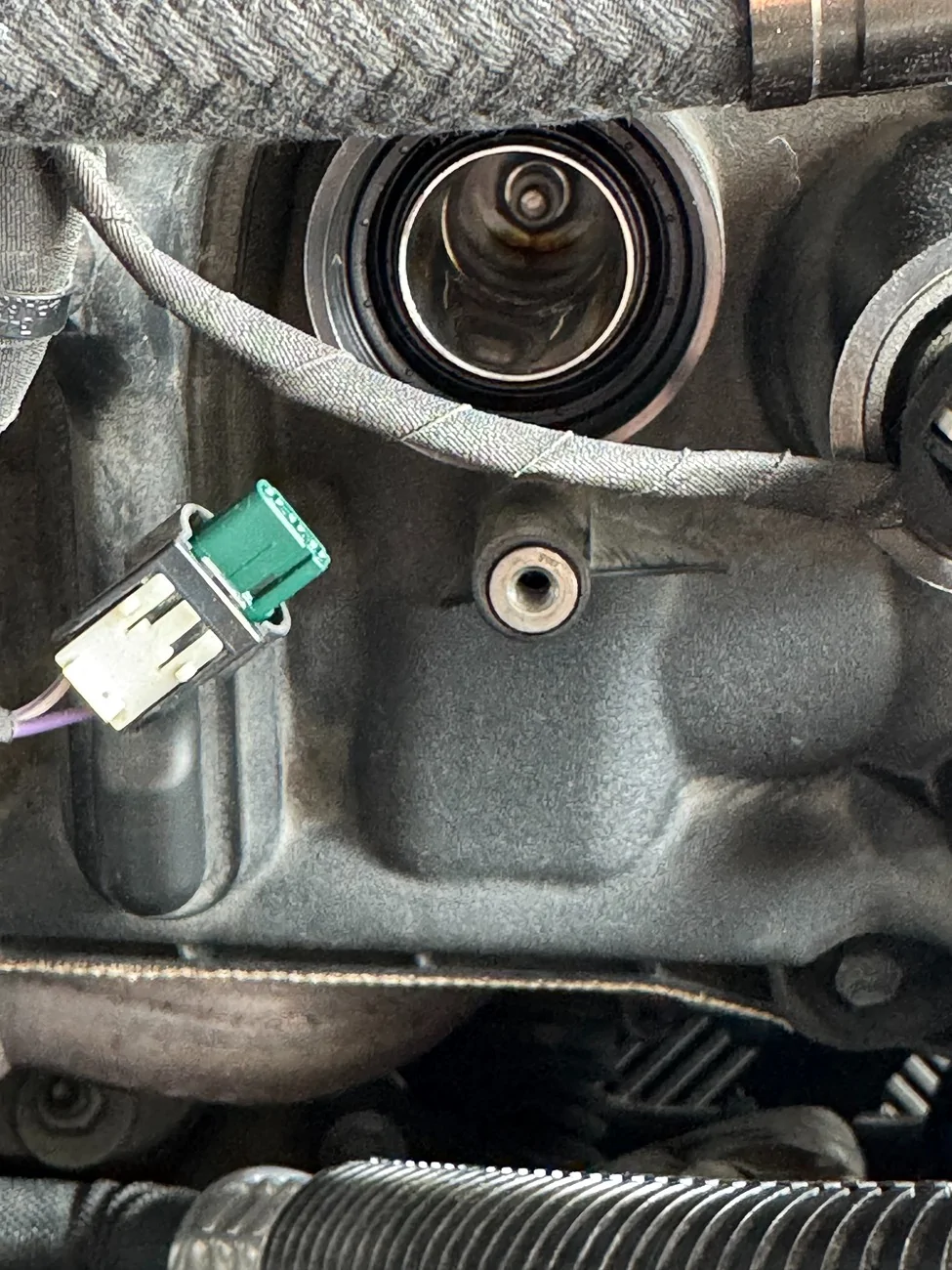

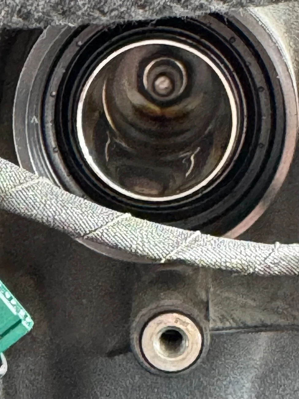

Also before I pulled the #1 plug, I could see there was a tiny amount of oil in there (picture 3 & 4). Do you think this is the valve cover gasket or the O-ring for the spark plug tubes? I am guessing the O-ring for the spark plug tube since none of the other ones had any oil that I could see.
I am trying to figure out my plan here... I will swap the 2 Direct Injectors out for new ones, new plugs, new O-ring and valve cover gasket for passenger side.
Pictures are below. Any advice would be appreciated, especially for pulling the intake manifold and valve cover off, I have not had to do either before, thanks.

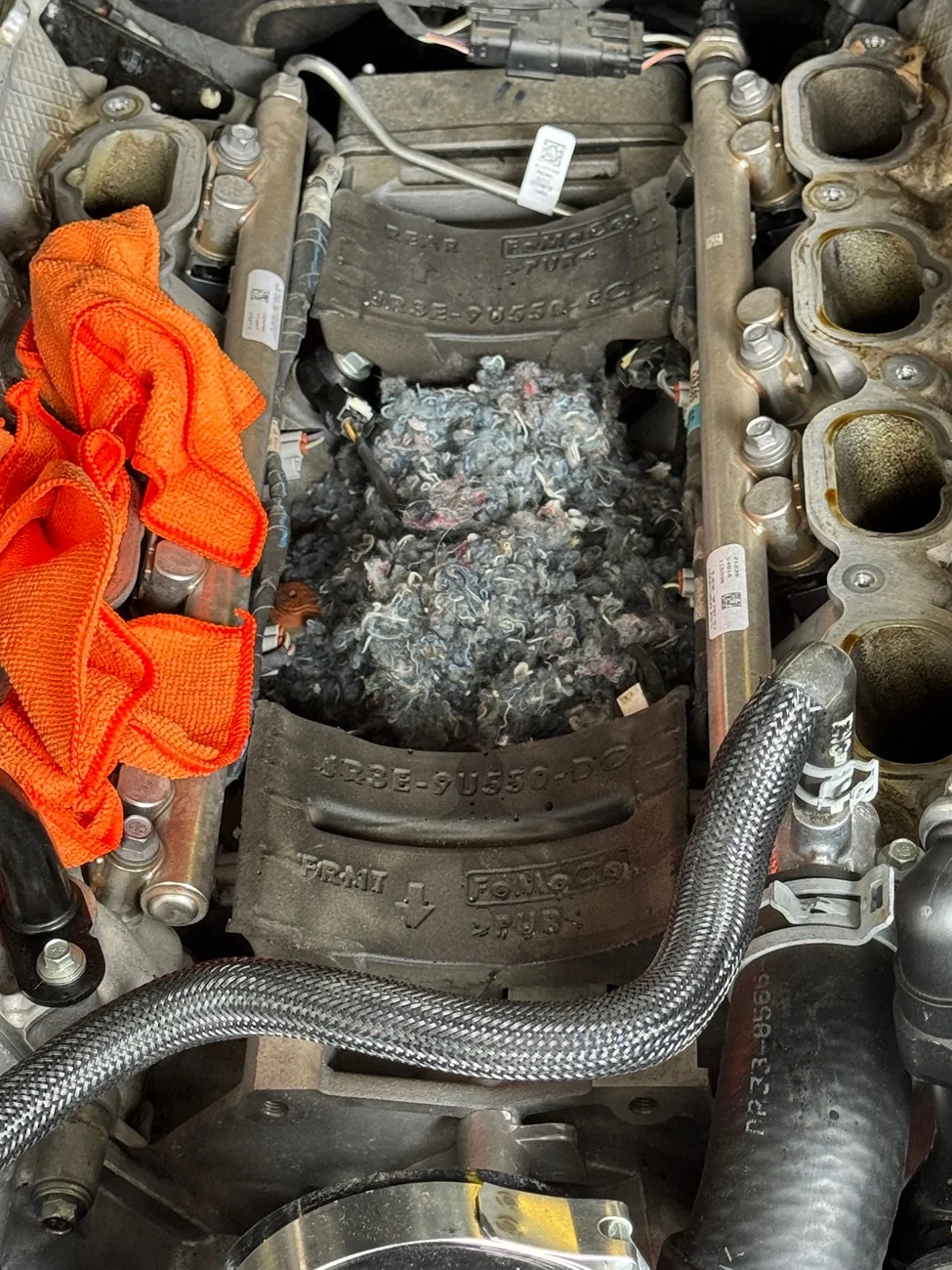

and some critters decided to make under my intake manifold their home at some point… I knew they got under my backseat at one point and on top of the intake manifold but can’t believe they got under it.
Glad to hear you nixed it! I once had mice make a nest in that valley in one of my trucks. They tore off pieces of hood lining for extra comfort.
