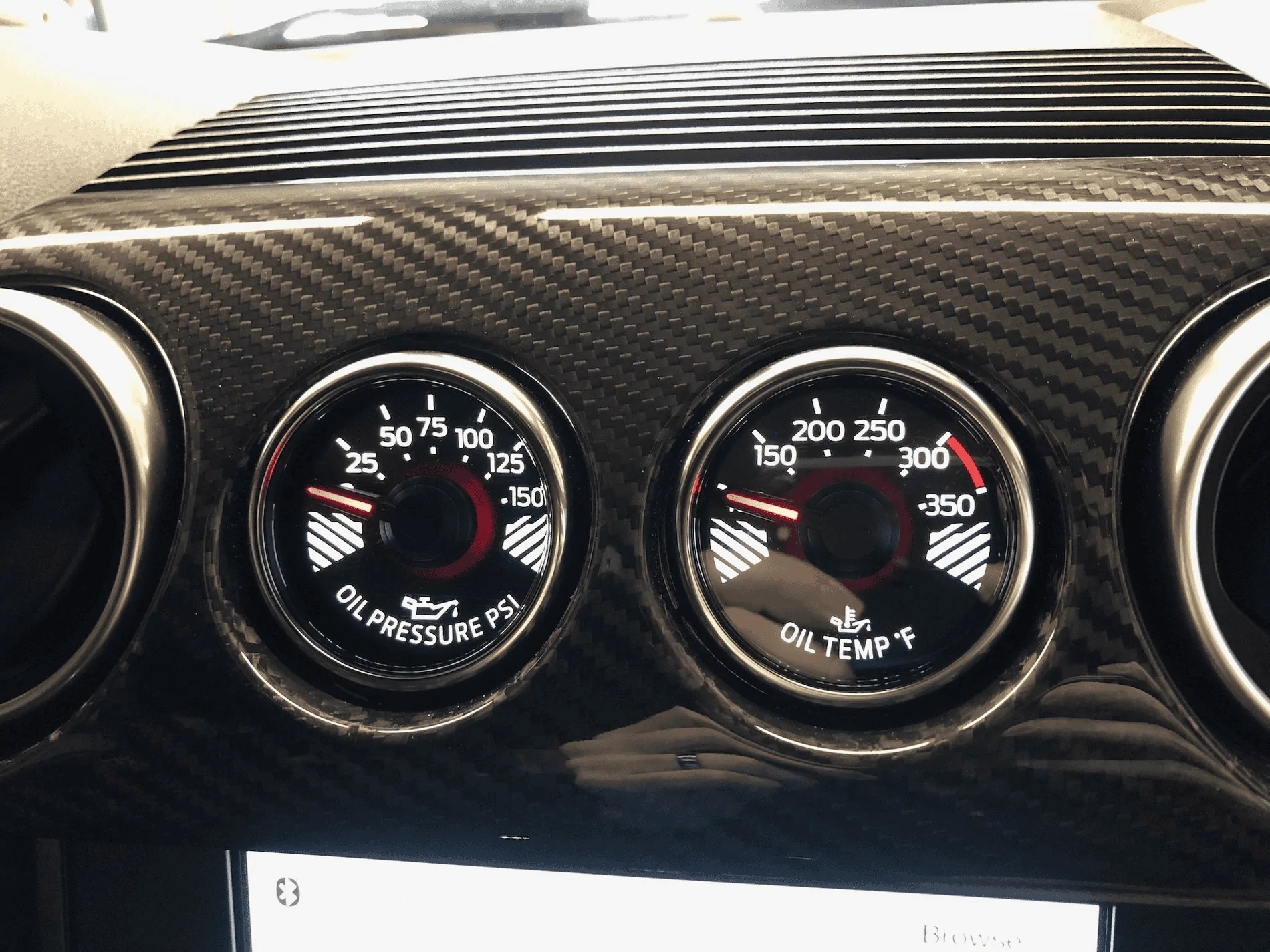

Color me stupid but where's oil gauge temp.i have oil psi,but don't see gauge for oil temp
It doesn't have one, and you can't get it to display on the glass dash in the GT, even though the manual implies that you can. The stupid goes to FoMoCo here, but that's the situation.
For my car, I bought the GT350 gauges (oil pressure / oil temperature) online and swapped out the GT PP1 gauges (oil pressure / manifold vacuum) in the center of the dash. Cost a few hundred dollars and took less than a half hour to put in.
Plug-and-play in both the GT and the EcoBoost, assuming you have a model with the gauge-style center dash trim. If you put it in an EcoBoost, however, you lose the Boost gauge. In either car, it doesn't support MyColor, but I think it looks fine as-is at night.
Link to the gauges follows. Price has gone up around $50 since I bought them in the spring. https://parts.autonationfordwhitebearlake.com/oem-parts/ford-instrument-cluster-fr3z10849e?c=bD0xJm49U2VhcmNoIFJlc3VsdHM=

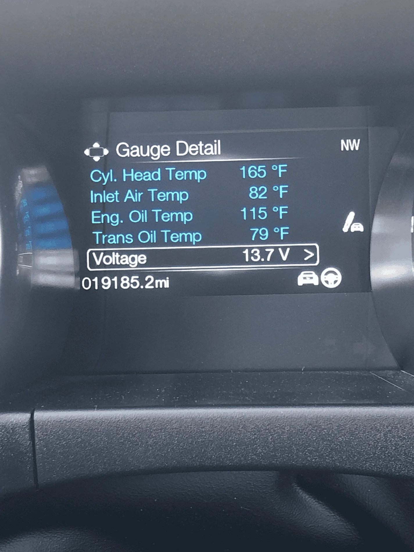

I'm very confused.
My car has oil temp in the center;
And I'm pretty sure 401A cars have this;

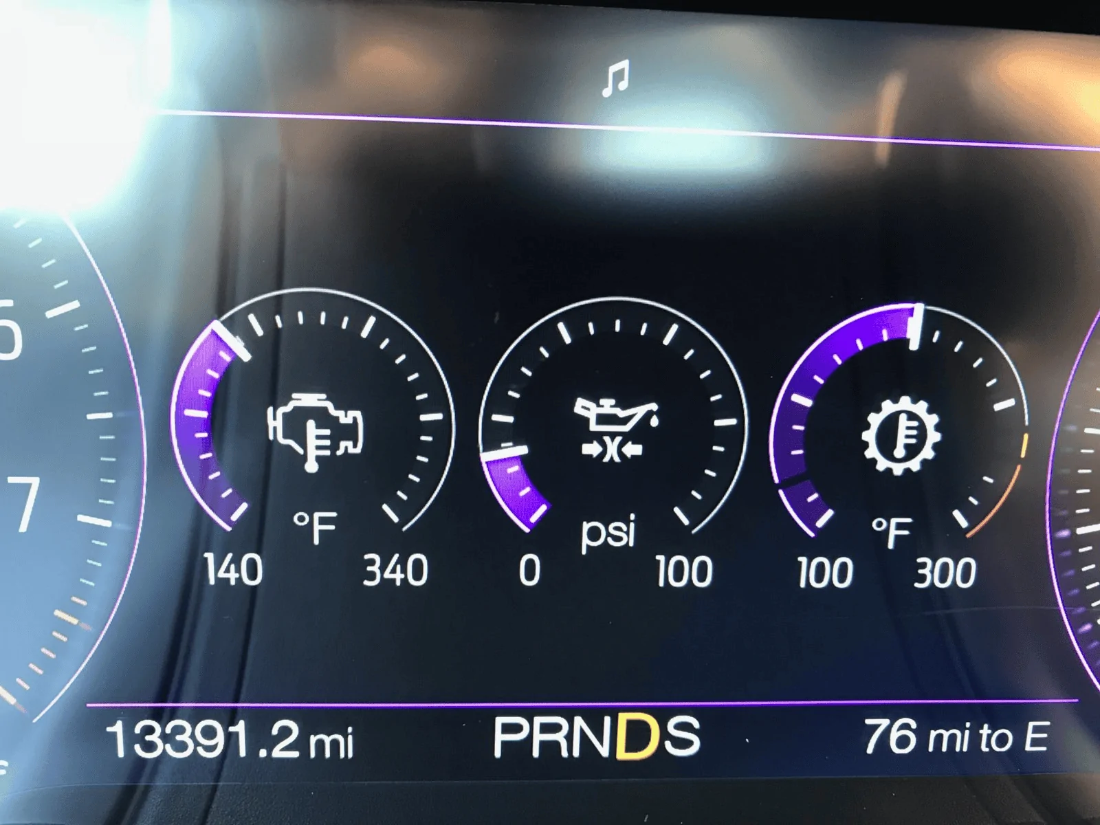

I'm very confused.
If your car was a 401A with the glass dash, that display wouldn't be available. Which is phenomenally stupid.
The one on the left is cylinder head temperature. The one in the middle is oil pressure, not temperature.

Center gauges, L to R; Coolant, Oil PSI, Oil Temp?
Or is the right gauge Diff or trans fluid temp?
Coolant, oil pressure, transmission fluid temperature (automatic only).
The differential temperature display shows as a circle with a pair of axles coming out of it.
