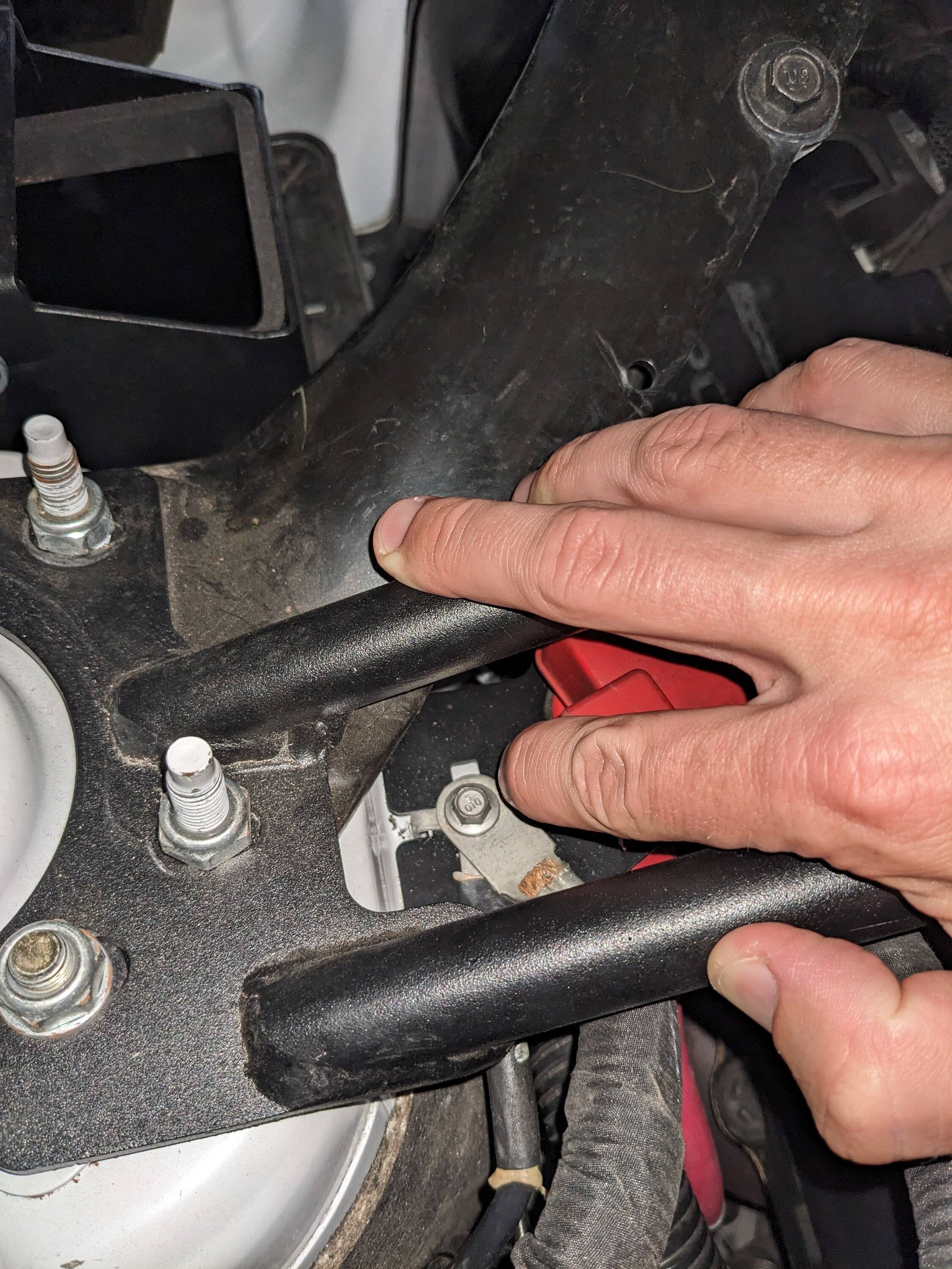

I hope the photo isn't massive. I'm pointing at the passenger side ground lug. That is the one you need to look at. I have a battery relocate terminal there now (the black thing), otherwise that bolt is connected directly the to strut tower. Clean that.
Did you do the BMS reset when throwing in the truck battery? I hope it's nothing as significant as what you are stating. But I'd bet if you chase down all these loose ends, the dealer will have a better starting point. Or independent mechanic.

Thanks, I did mean the passenger strut tower. One on top and one where you pointed out. I did not BMS reset with the truck battery.

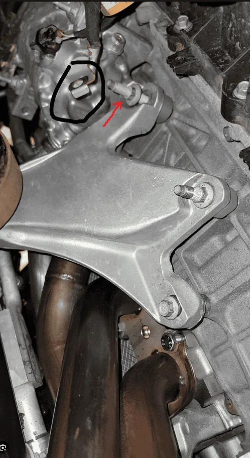

  • I was unable to locate a ground to the engine block on the passenger side anywhere near the engine mount or starter. If there is one there, I'd love assistance finding it.

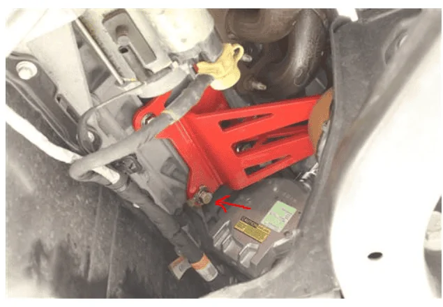

This is where the ground is. Not my picture, I took it from the internet, but the black circled ground wire connects to the stud with the red arrow. The stud is one of the four bolts that holds the motor mount bracket to the engine block. There should be a nut on that stud for the wire. I remember this being there because I had to deal with it to install BMR motor mount brackets. I suppose it's possible Ford did something different with a newer GT350. I have a 2016 GT.
This is a picture of the BMR motor mount brackets and you can see the wire tied into the harness for the starter.
