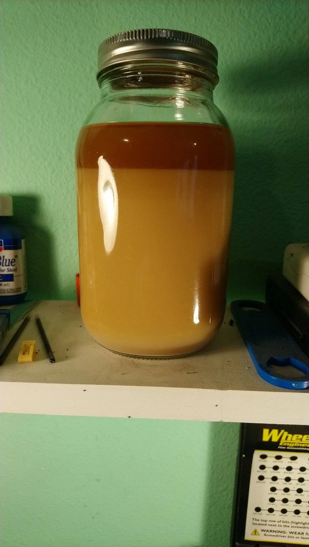

We'll, there have been some threads on other forums where someone complained about sludge build up in an oil pan of a different engine a few years ago. He made the assertion it was Ceratec that had fallen out and settled in the pan to the point where it would be a problem by clogging the oil pickup tube, causing a loss of oil pressure.
He also made the assertion it could then potentially clog small oil passages, thus starving other areas of the engine.
When I get around to it, I intend to see if enough solid hBn material settles into a sludge at the bottom of my little experiment to see if it could be a potential problem. Or if perhaps he was just blowing some hot air for having a dirty engine using crap oil, and searching for a reason to blame it on something other than his own lack of proper maintenance.
I personally never heard of anyone complaining of this in the hundreds of reviews I've read on Amazon, and also users on BITOG. This particular complaint seemed like an abnormailty, but I wanted to try this anyway, simply out of curiosity.

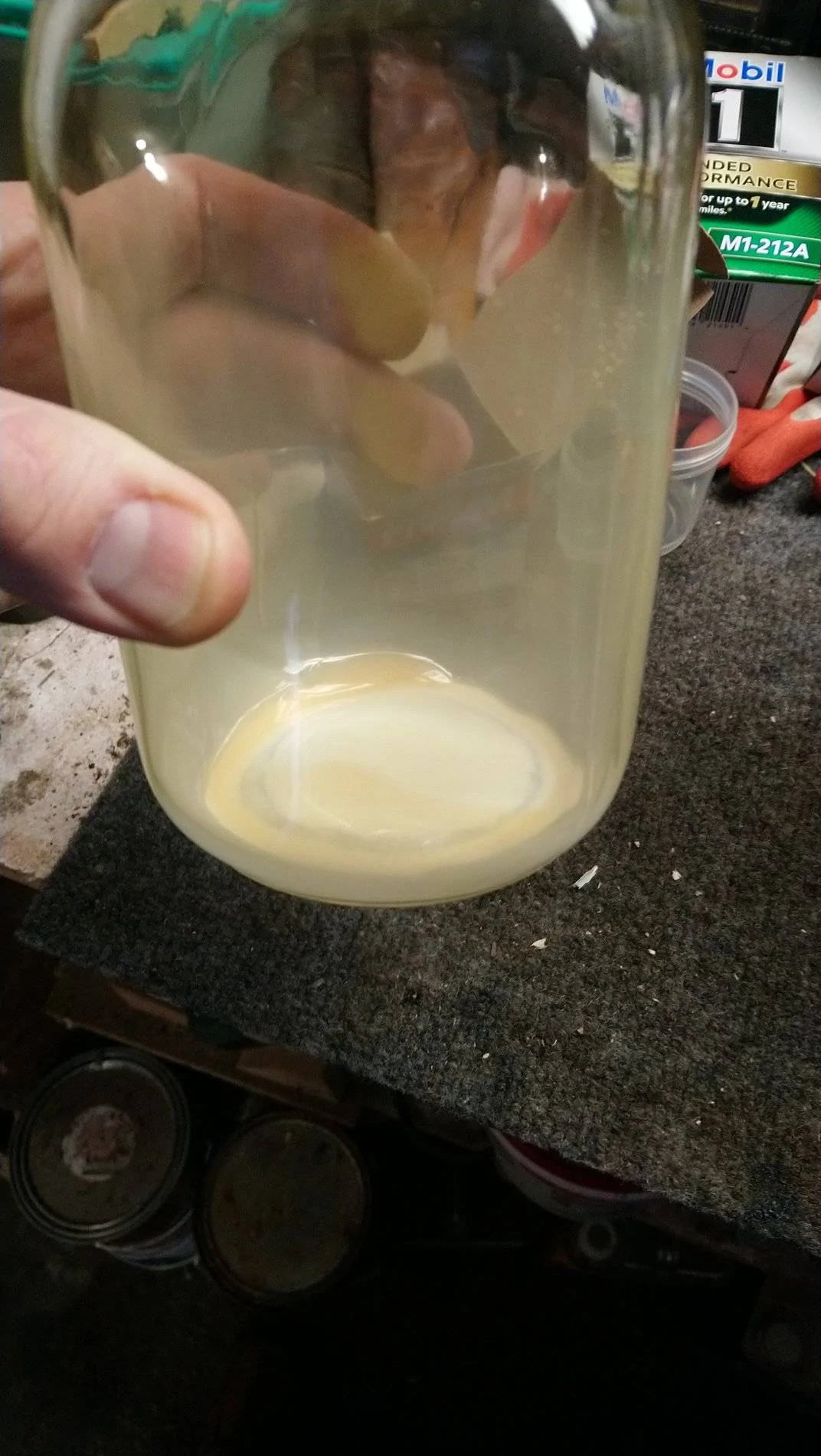

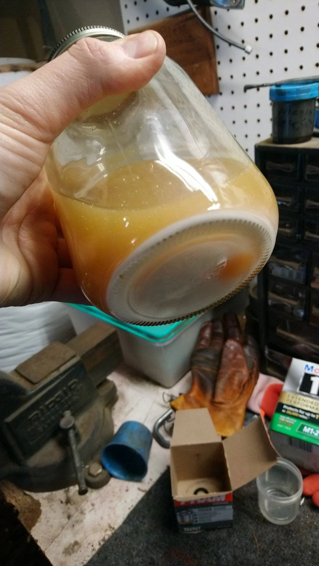

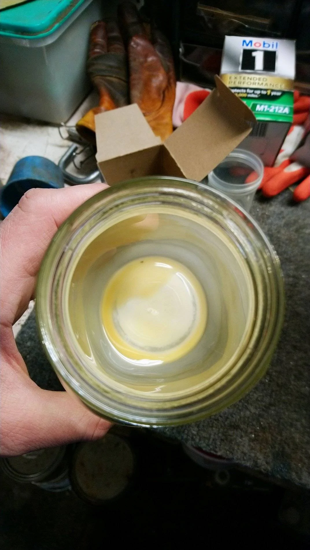

Update: Well, I found out something interesting. I poured out the oil today after doing an oil change on my daughters car. Not only after 1 month and roughly 10 days, it definitely settles and sticks to the bottom of this glass jar.
Not only did it stick, but after adding 1/2jar of new oil, I shook it vigorously for 3 minutes to try and get the sediment to mix in. It wouldn't. It stayed stuck to the bottom of the jar as the pics show. This makes me wonder if I should be adding this every oil change to subdue the typewriter tick.

yeah... if it accumulates this way it definitely makes sense to reduce dosage each time, or, even skip it.
On a parallel note - isn't it cetatec's task to stick/embed into metal surfaces?

Yes, it is...but to stick to the bottom of a smooth glass jar? Wow!

I wonder if the results would be different if it was heated to like 190 or w.e oil gets to
