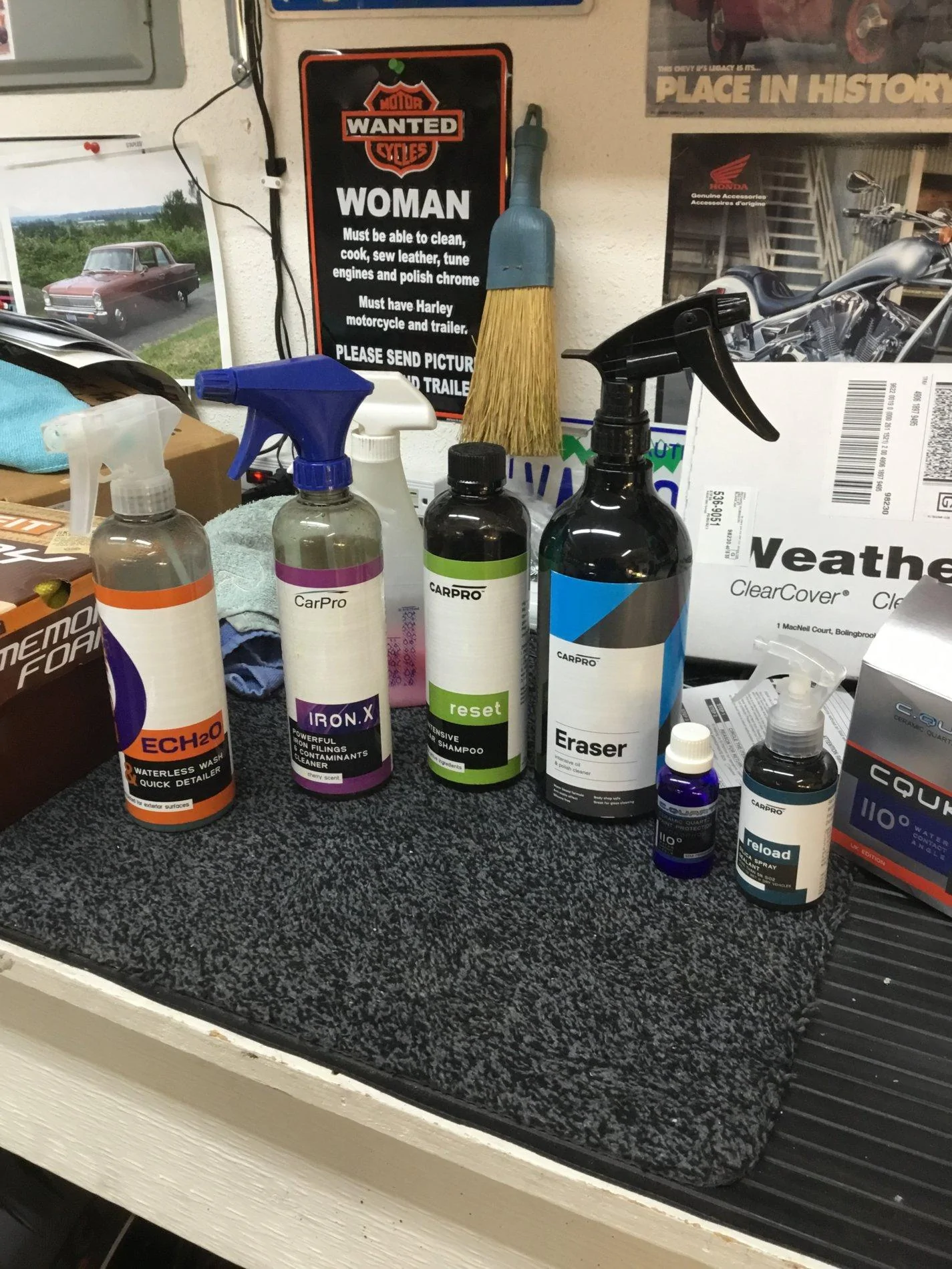

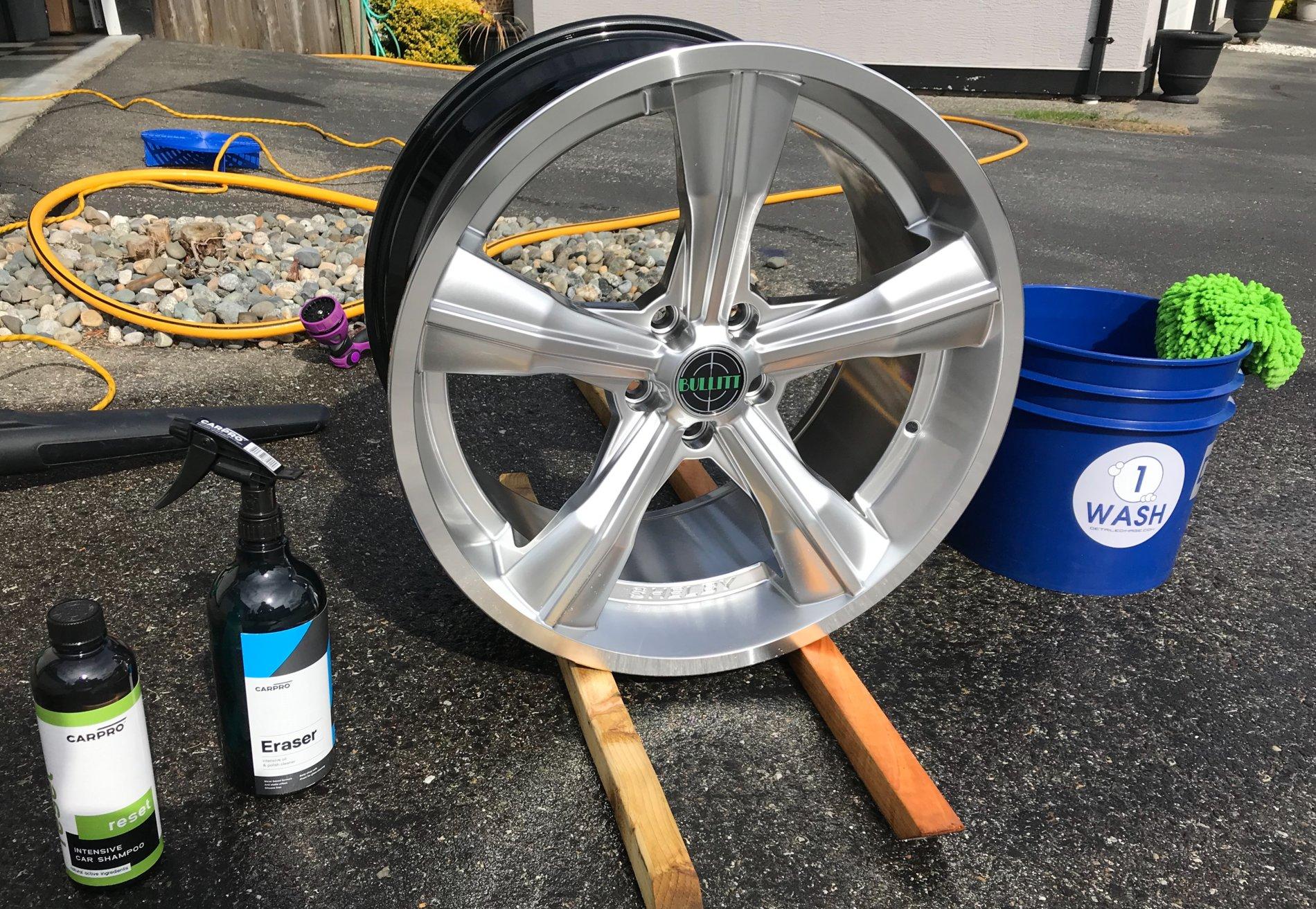

Done it before with Black Magic....also add Ceramic Brake Pads for less dust!! My Shelby’s are ready for the CQuartz UK today...then Reload tomorrow..then mount the huge Nitto’s Tuesday or Wednesday!! Yes...custom Center Caps made!! One-off stuff!!!

Be sure the wheels and barrels are thoroughly washed and decontaminated(you'll need an iron remover like Iron X) then prep wiped before coating for the best results and most longevity.
