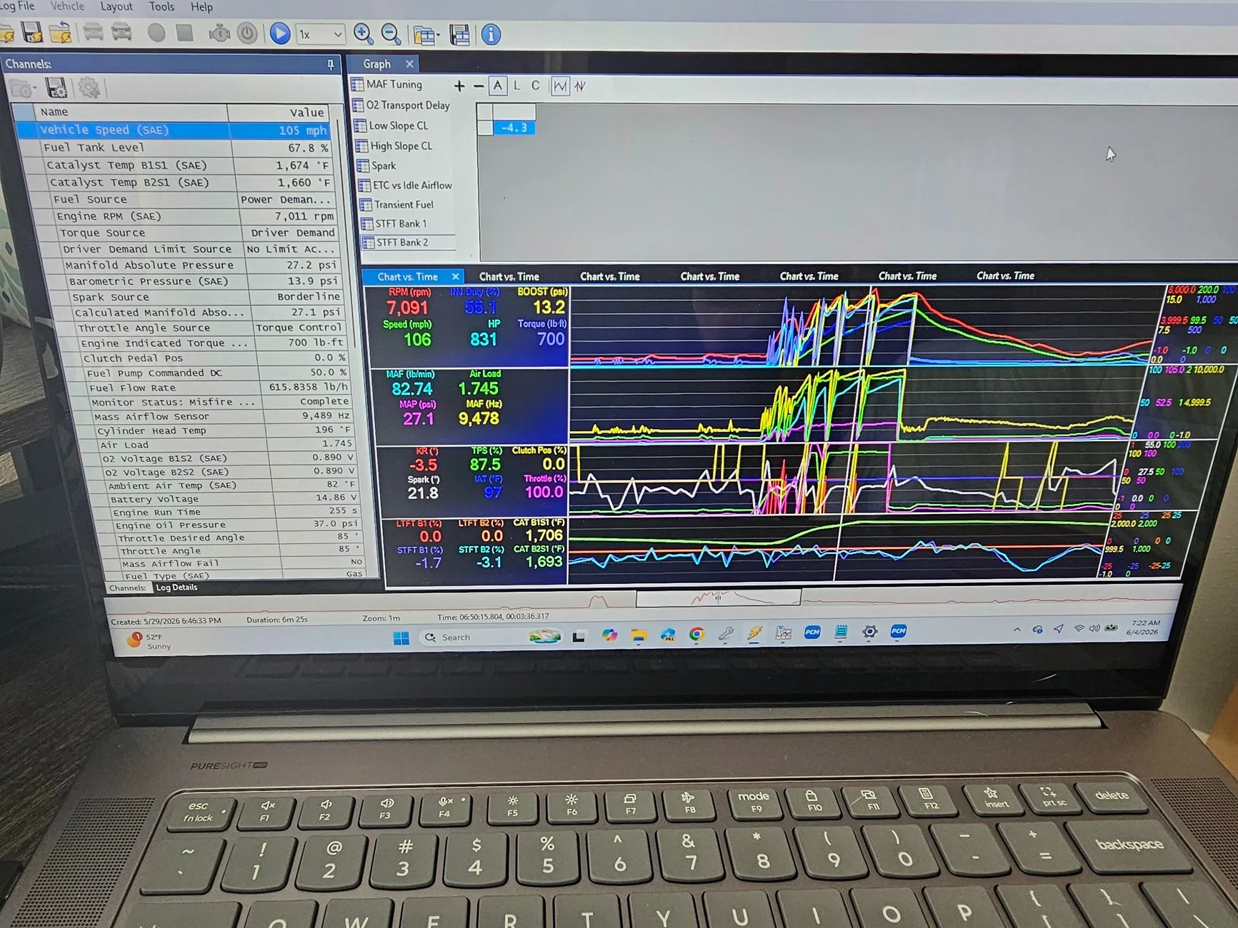

So this data log is from this past Friday's test and tune. I run pcmtec canbus flex and had e74 in the tank and 3.375. I turned COT protection off for this run just to see how high cat temps would reach. Ambient air temp was 82 and IAT were 97 degrees at this point in the run. I have the standard heat exchanger and IC pump that came with gen 2 whipple stage 2 kit. I also have a custom supercharger blanket, MFP Phenolic spacers, and a Reische 170 T-Stat.
Cat temps (per the inferred logic) were approaching 1,700 by 7,000 rpm in 3rd gear. They reached peak temp of 1,790 by end of 4th gear run.

@stang17 i actually installed thermocouples in my cats some years ago and found the cat temp actually rise when you let off. However, I’m 90% sure the degradation we are seeing isn’t due to peak temp. It’s due to thermal stress which is different. All of the tech articles on thermal degradation of catalyst have to do with molecular changes over long periods of time, not mechanical failure of the ceramic substrate. I believe it’s thermal shock causing failure, likely during DFCO.
This guy from GESI is saying something similar
