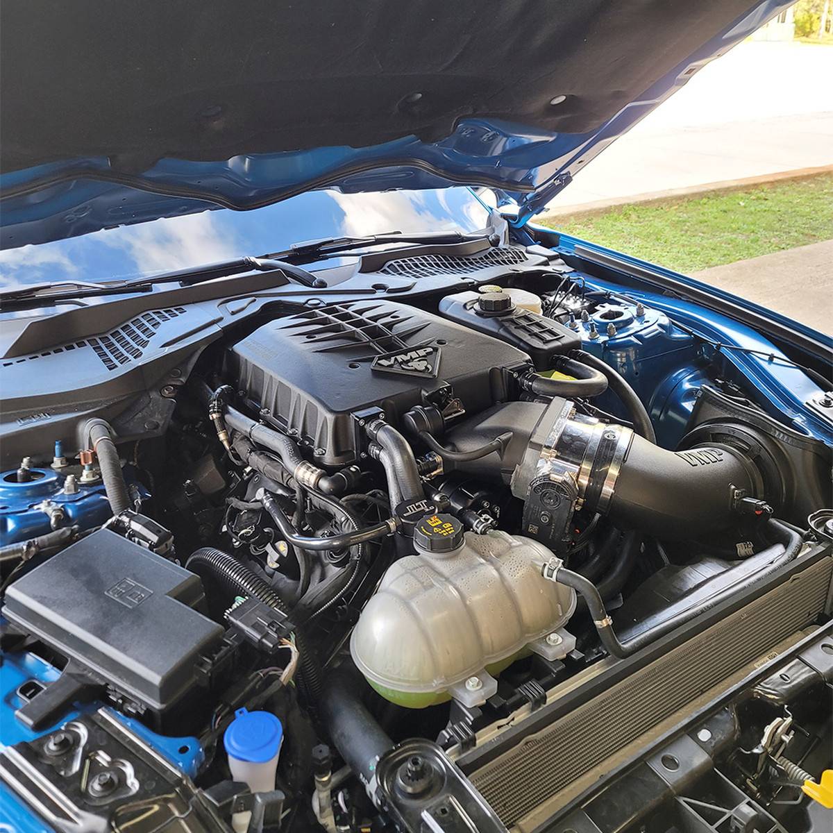

Total speculation here - I successfully changed my digital dash to show boost but I have a Roush supercharger which is converted from MAF to SD. I believe the VMP Odin still uses MAF, no? Picture below is from VMP's site which looks like a MAF sensor. If so, are they changing/reading the factory MAP to an X bar sensor that shows boost?

I'm not sure TBH. I'm going to reach out to my tuner and see, Will call VMP as well. I imagine they have seen this issue pop up at some point.
