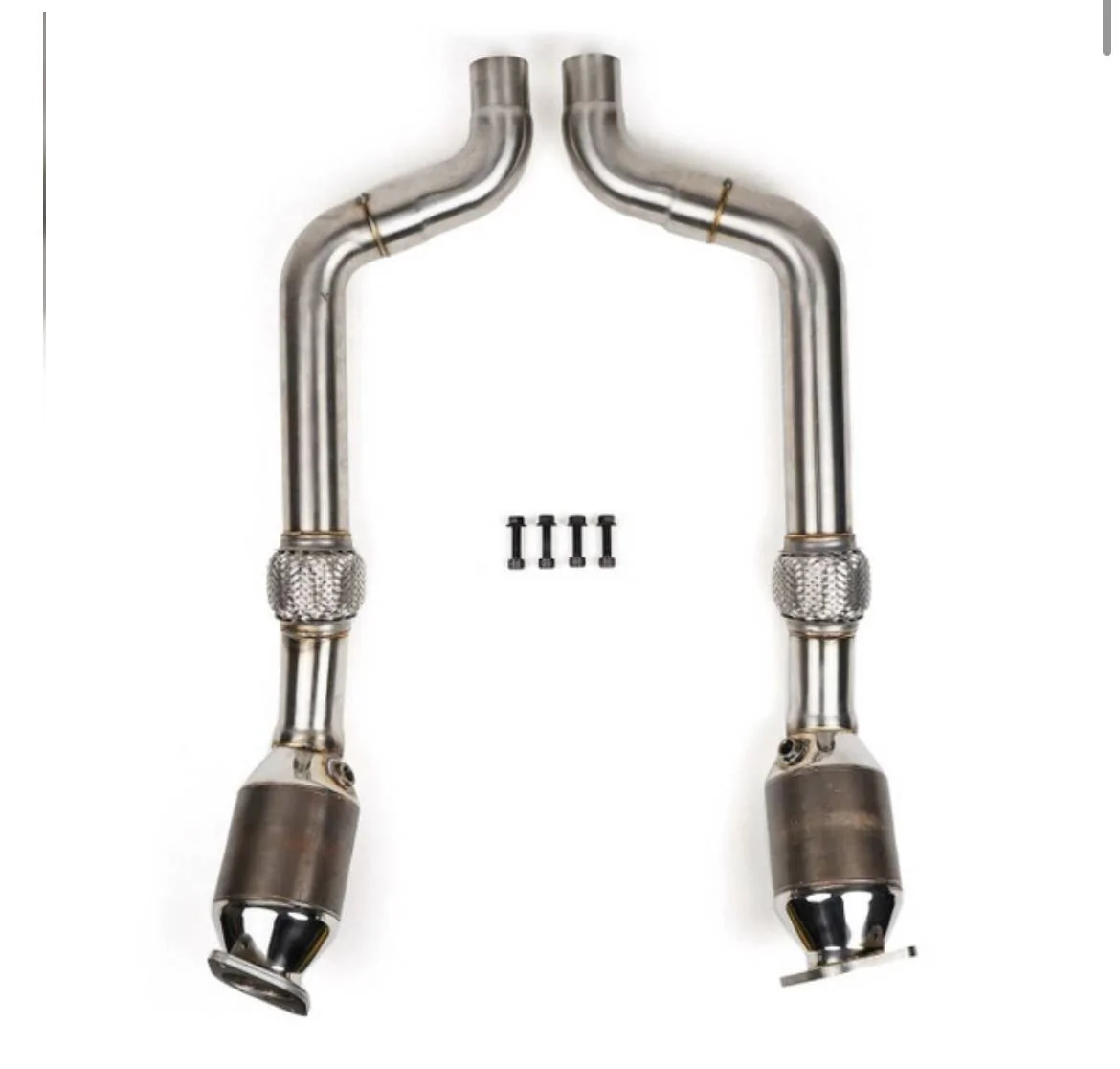

I do wonder if the Fabspeed GT500 HJS cat pipes would be an option. Id like to have a backup plan thats not catless, if my stockers take a dump.
They cant be much harder to fit then the cat delete pipes from MAK or 2M. Those HJS cats live on Mclarens making 900hp on stage 2 tunes. I would bet they are making 26-28 pounds of boost. Cause they are 20 psi stock and adding 175 whp or more.
