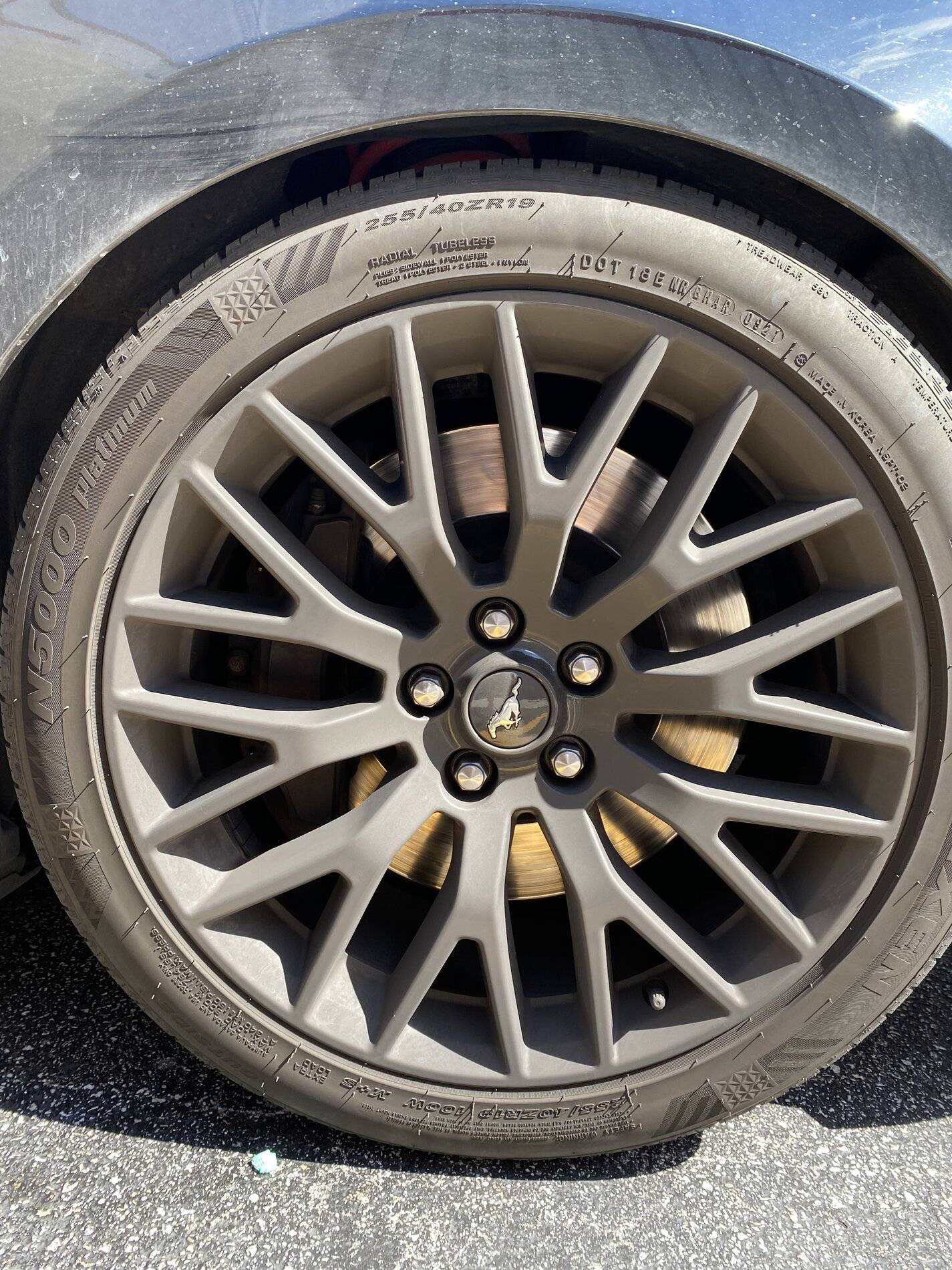

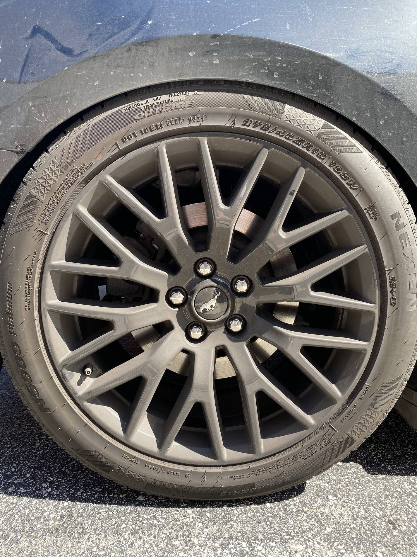

315? Are you lowered? I bought my car used and it’s lowered in springs and has spacers (I’m not sure how much it’s lowered or how big the spacers are) but right now I have the stock performance pack 1 wheels and there is barely a gap between my tire and the fender. [rear 275/40ZR19] [front 255/40ZR19] (I attached pictures so I can see the gap, please don’t mind the dirt I had just got out of a dirt lot where my father parks his trucks)

I have a mild drop with the FP progressives that's about 1". Offset on the rear wheels is +50 and +35 on the front. No rub its all about getting correct specs. Keep in mind the pp1 wheels are boat anchors. If you swap those out and also ditch the spacers you will be dropping significant rotational weight and see performance increases. You can go wider and still drop a good amount of weight. Spacers also run the risk of shearing off bolts. While hubcentric spacers are a safer version it can still happen.

I had 325/30/19 on my car with drag springs. It was only lowered a half an inch, but it never came close to rubbing. Now I'm going with 315/50/17 drag radials, and I have to use spring spacers to get them to clear because the tires are 29.5" tall. Tire height is critical with clearance.
