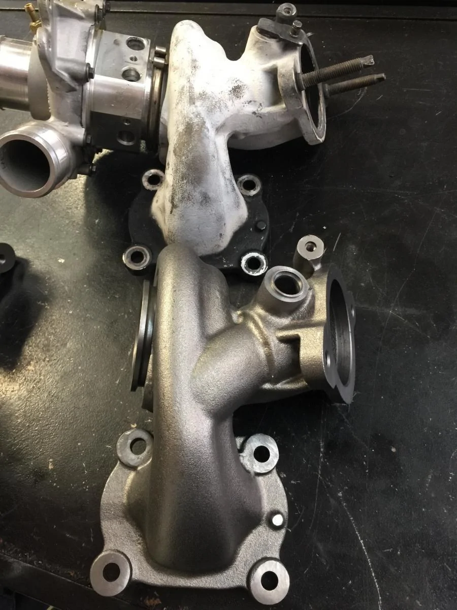

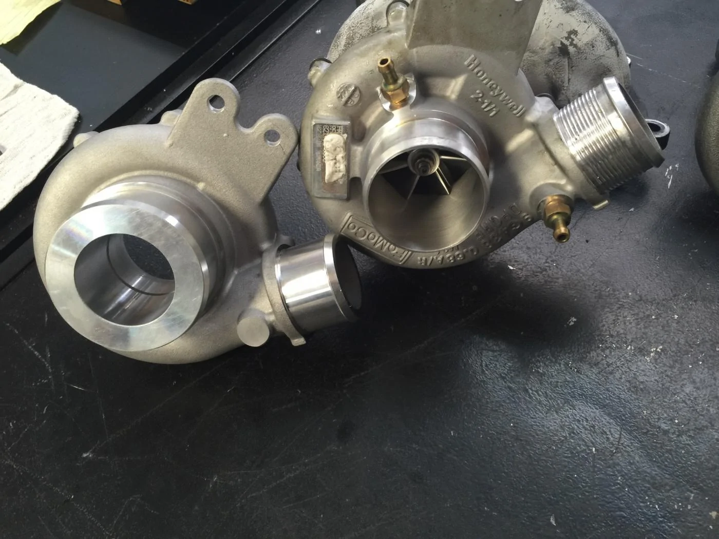

What everyone has been waiting for! This is what separates the Cavalli from the rest. They designed their own compressor cover and exhaust housings based on the testing from a couple of cars, one of them being mine. They are not guessing on your car. Cavalli and RIP Tuning have worked very hard to find the limitations of the stock turbo. There are a few that will hinder just a compressor wheel upgrade.
The turbo from my car is in the pictures for comparison.

I am not producing the Cavalli turbo, I am testing and working directly with them to help bring this product to market. Creating your own molds for the exhaust and compressor cover take time. There are some major drawbacks in the stock design to make power in the upper rpms.

Hi BGolden
Looking at pic of exhaust housing , the twin scroll used here is just cylinder 2/3 go to one scroll and 1/4 go to other ?
I mean there no high/low type with flapper valve like other twin scrolls .

This is a true twin scroll design [MENTION=17650]Edkiefer[/MENTION] and you have exactly the right idea about where the runners are directed.
Are you referring to quick spool valves found on some other systems, with regard to the flapper?
