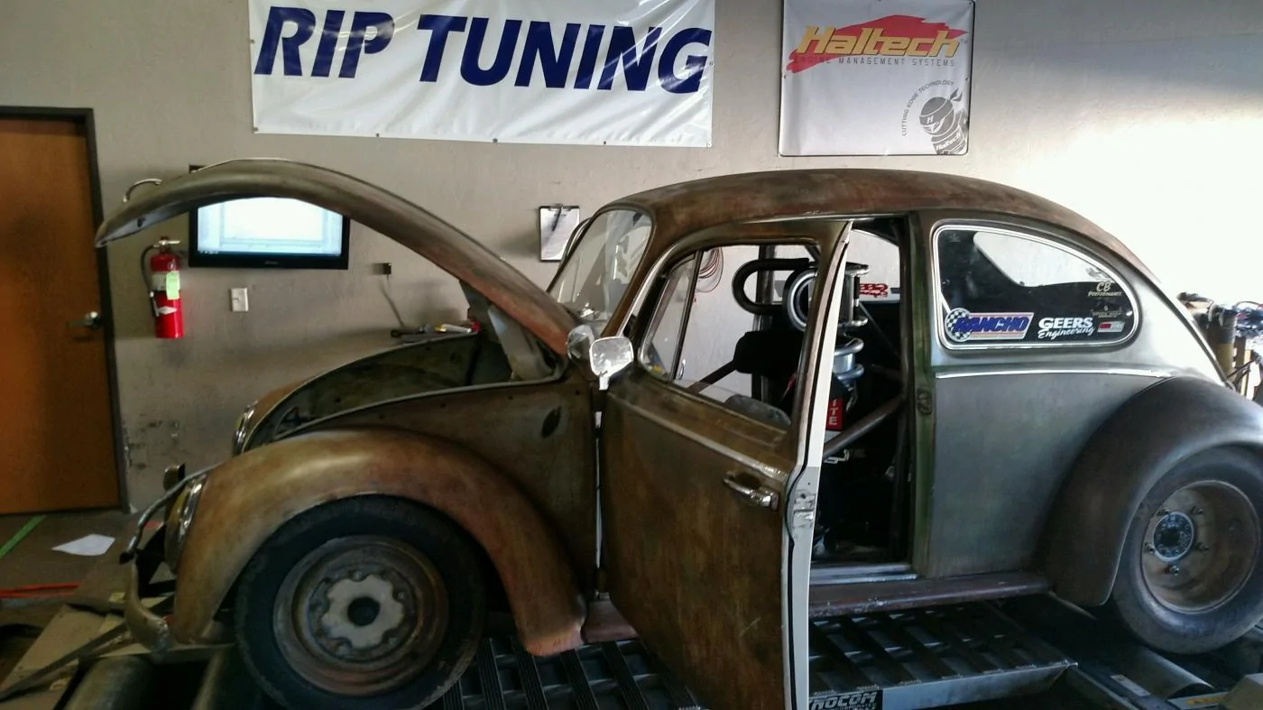

The Dung Bettle has made 100 more HP then it ever has before in the last few months and honestly I think its faster than my 800 hp GTR. AZN and Farmtruck are great guys to work with and you will see some really cool cars in the next year from them. I wish I could say more but I am not able to do so on other projects. I would watch their Facebook and Instagram pages for those updates.

I know that dung beetle previously was somewhere in the 400hp range at the rear wheels. If you've got it in the 500 range it probably will do 9's at this point. That thing is so damn quick.
It is surprisingly fast. My GTR makes a touch over 800 to the tires currently and I am pretty sure he would get me. The car is just so light.
