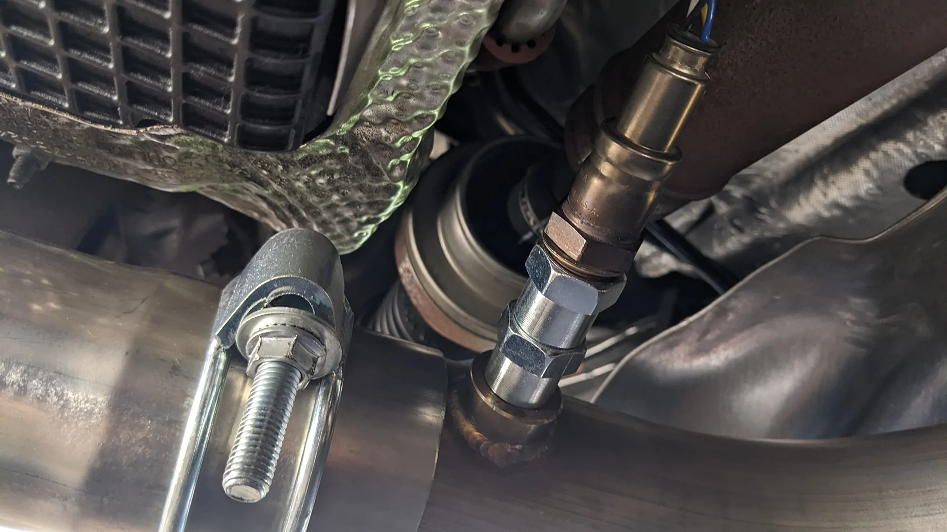

So, anyone with catless setups have any luck with emissions with this product?

Lots of people are using minicats or o2 simms or whatever you want to call thsoe

I use those on another car with no issue and no cel. Didn't need them on the mustang though.

I have something similar and no lights.

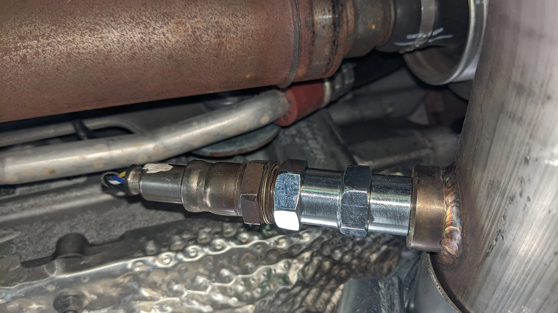

This is what I used on my Whipple F150 when I removed the cats.
I used two kinds and double stacked them; Medium length stacked on a short one. Worked great. No lights.

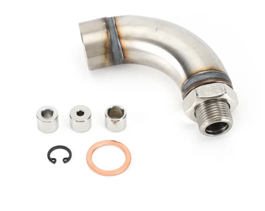

Yes, but get the ones with the inserts in them. Use the medium insert and good to go.
