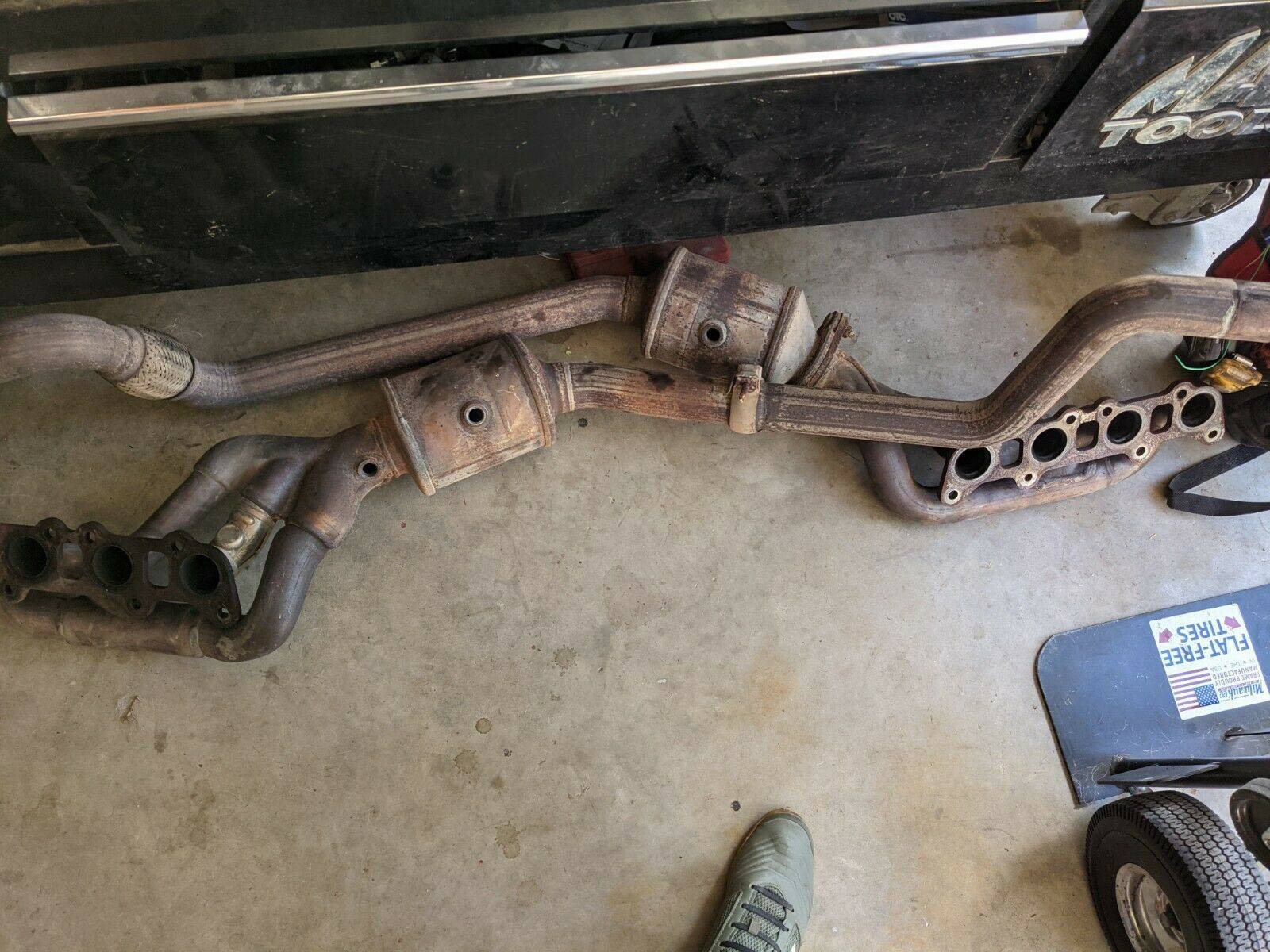

I would jump on these..$650
2015-2017 Mustang GT headers and cats
